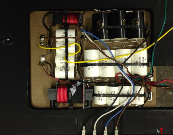

I just posted this elsewhere.  I just found this today and thought maybe someone would want to take a crack at solving the Maggie 3.7 crossover mystery...
Original OEM Magnepan Magneplanar 3.7 Passive Crossover Network Pair
http://www.ebay.com/itm/221675927291?_trksid=p2060778.m1438.l2649&ssPageName=STRK%3AMEBIDX%3AIT

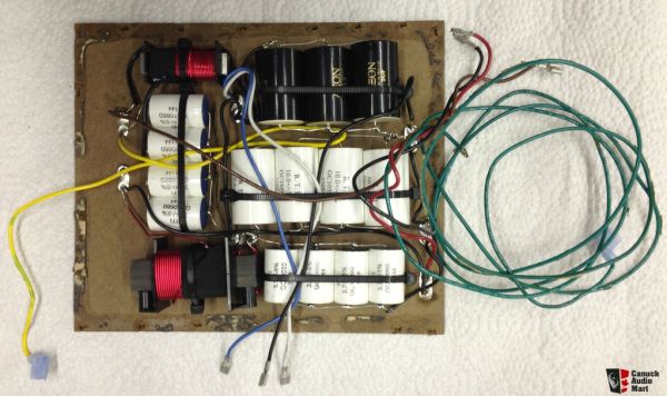

I see they are now listed on CAM. I guess the $1.50 bids on eBay didn't cut it? The caps are easily worth his asking price alone. I'd love to have a look at the schematic in more detail since it looks eerily similar to the MG 3.6/R crossover.
http://www.canuckaudiomart.com/details/649177076-magnepan-37-oem-passive-crossover-network-pair-with-schematic-crossover-frequencies-amp-roll-off-rat/
*Scotty*
Re: Maggie 3.7 Crossover Revealed?
« Reply #2 on: 10 Feb 2015, 04:33 pm »
The schematic shows a 1st. order series network assuming that the person who drew the network understood the crossover parts arrangement they saw.
Scotty

Even the larger one doesn't appear to have too many turns/layers on the core.  I estimate these are probably fairly small value inductors, probably around 1-1.5mH, because of the series configuration.
These steel laminate inductors have pretty good characteristics and saturation/distortion issues are highly unlikely in this instance.  Way more distortion and dynamic issues in the drivers themselves than the crossover components.
Dave.
There are pretty linear vs aircore , but saturation distortion will exist in the bass that i can assure you, especially because of the low sensitivity  .....,

Ah, well if you can assure me, then I must be wrong.
An equivalent air-core inductor could be made to fit in that area and hardly much more $$ so it seems Magnepan made a poor trade-off decision in this case?
Dave.

Do you think its difficult to drive more than 150 watts of music power  into a 3.7 , really not , that inductor will saturate and it's not as simply as replacing values,  ribbons and planers are very sensitive to DCR , you may want to watch for that too ...

Ribbons and planars are no more sensitive to DCR than any other 4 ohm driver.
DCR difference for equivalent inductors of this value only about 0.1 ohms.  SPL difference only about 0.2db.  Negligible.

I find the iron cored inductors objectionable because of their hysteresis distortion which aircore inductors don't have. This is definitely an economic trade off due to the cost of copper.
