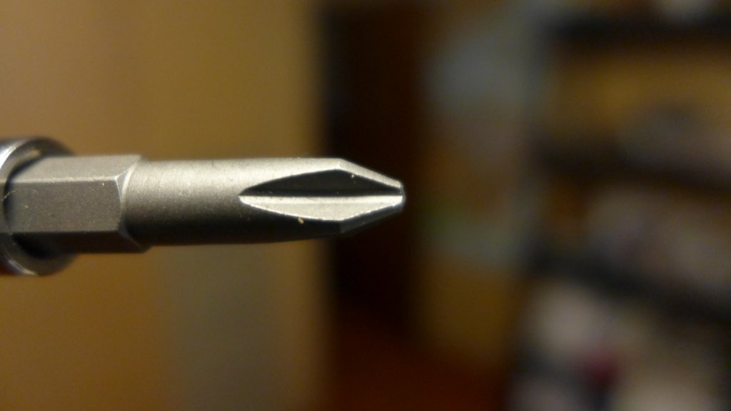

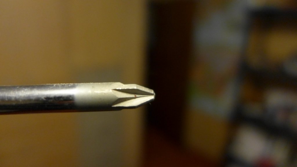

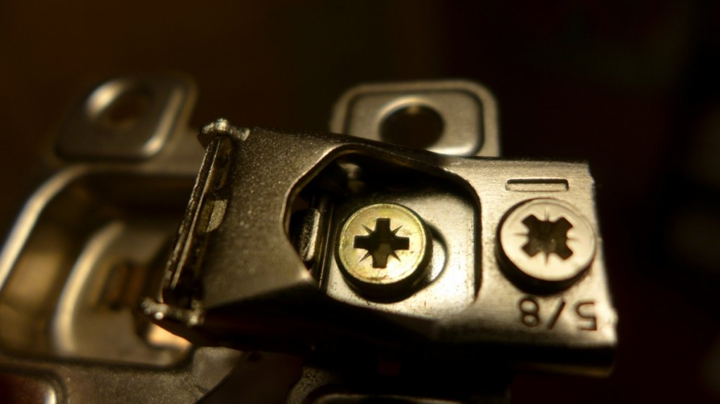

One can get a Phillips to turn a Pozi-drive and even vise versa, but there are significant differences between the two. For years I didn't know this and boogered more than a few screws because of it. A Pozi-drive screw is easily identified by the tick marks radiating from the crux of the X. Phillips never has these.
Treat yourself to something that works better. Easy to do now that you can get interchangeable tips like Mike posted.  Try it and see!
This copied from one of my supplier's web pages:
Pozidrive screws answer the Phillips shortcomings. The differences are subtle. At first glance it appears to be a Phillips, but on closer examination you'll notice a second set of cross-blades at the root of the large cross-blades. These added blades are for identification and match the additional makings on the head of Pozi-drive screws, known as "tick" marks. So, the marks are for identification.
Two features of the Pozidrive screw and driver combination make it unique, and superior to the Phillips. First, the tip or the Pozidrive driver is blunt, which also helps it to seat better into the recess in the screw, unlike the Phillips which comes to a sharper point. This becomes a problem as the tooling that forges the recess in the head of the screws begins to show signs of wear. The recess becomes more and more shallow, which means the driver will bottom-out too soon and will cause the driver to cam-out.
The second unique feature is the large blades on the driver have parallel faces, where the Phillips blades are tapered. The straight sides of the driver allow additional torque to be exerted without fear of cam-out.
Knowing this, we can see why a Phillips driver will have problems driving a screw with a Pozi-recess, as a Pozi-driver would have little luck driving a Phillips head screw. One more tip. In a pinch it is possible to drive Pozi-drive screws with a Phillips driver, but you will need to grind down the tip slightly, and expect some slipping to occur.
Take a look, which is the Pozi?
And there are three common sizes to both, #1 #2 and #3. #2 being the most prevalent. I've encountered more #1 on audio gear than anywhere else.
All that FWIW  :roll:
