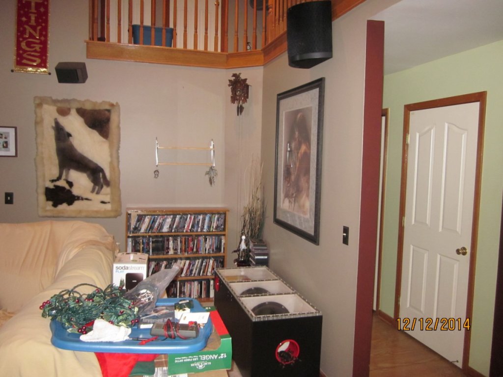

I am going to go out on a limb and say your dialogue issue is probably caused by room overloading. From the limited pictures that you have posted, you have absolutely no bass traps anywhere, and it looks like the center channel and the LS mains are right up against the wall.
Unless something is hooked up wrong, or not working as intended, I think that it could be an acoustics issue. In other words, not related to the crossover set by the HT equipment.

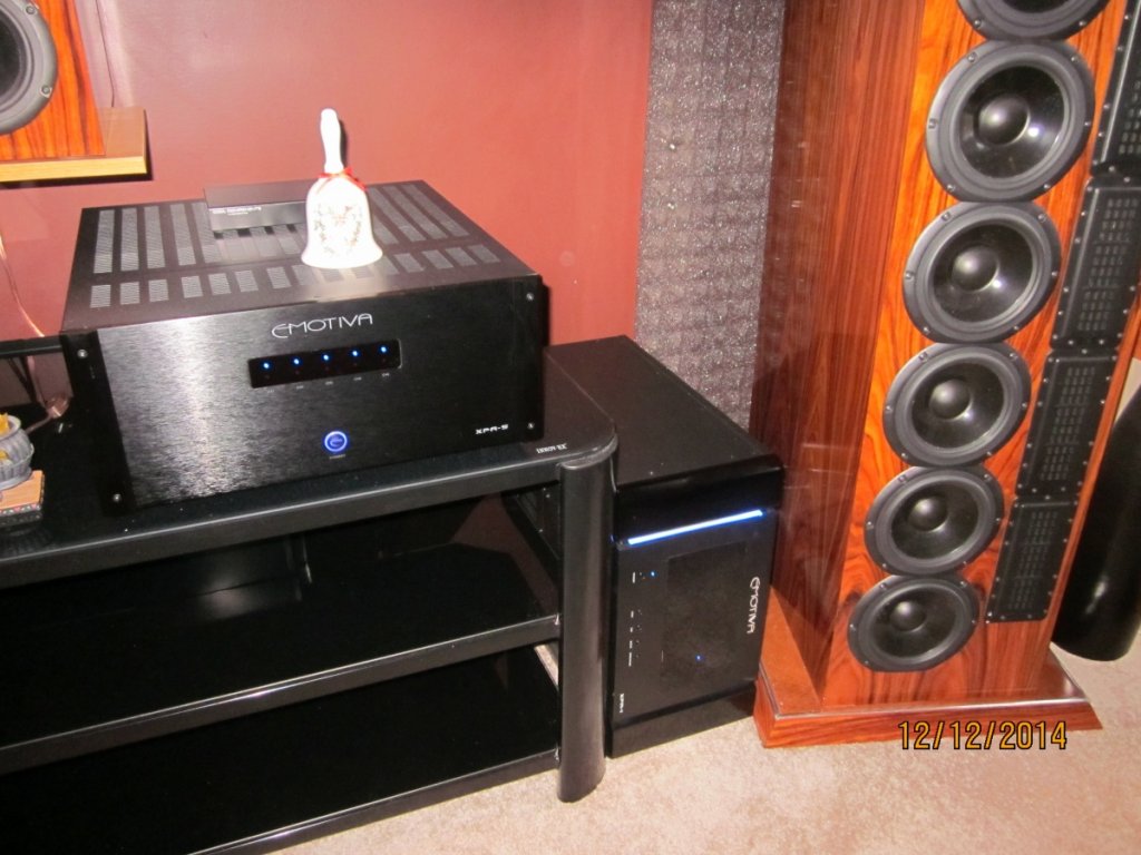

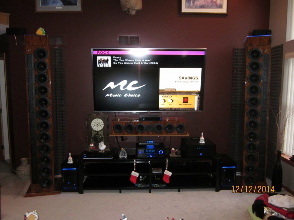

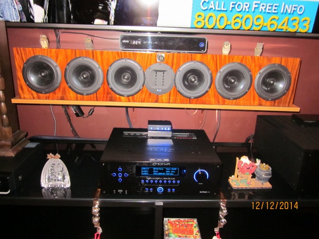

Thanks for the input everyone.  More detail on my system upgrades -  Built the LS-9's years ago, and the LSC a few years ago.  Was running "cheap" Behringer amps to power all of the 9.1 speakers out of a higher end Yamaha receiver.  I had Bi Amped the LS9's and the LSC.  Danny - you were spot on in needing to upgrade the amps to realize the real potential of the LS9's.  I now have new Emotiva stuff which is relatively cost effective.  I run the LS9's with a pair of XPR-1 1000W mono blocks, and the F/R surrounds and LSC with a XPA-5 Gen 2 200w/channel amp.  Just installed Emotiva's new XMC-1 processor which is one fine piece.  The Decker "Housewrecker" sub is still run with a Behringer 3000 1000w amp and I installed that in the basement to avoid the nasty fan noise.  I use all Emotiva balanced cables as interconnects, and power cords and cables are VH audio home made design.
Anyway, I am waiting on the Dirac" room correction from Emotiva, so for now I used a SPL meter and my ears to complete a initial set-up.  Admittedly, I know little about room correction or treatment - for now it is what it is.
Getting back to the LSC, I was able to use the menu features of the processor to "boost it" a bit and it sounds a whole lot better.  Thanks Danny for the crossover and Hz range input, I will use this to tweak the setting.
On a closing note, this set-up friggin blew my mind it sounds so good.  The LS's are a totally different speaker with upgraded audio stuff driving them.  The spatial depth and clarity is freaky.  Even MPEGs are awesome, and Blu Ray HD is otherworldly!

Oh  - years.  I used it with my old stuff right after I built it, so it certainly is "broken in".  Attached is the old set up.
