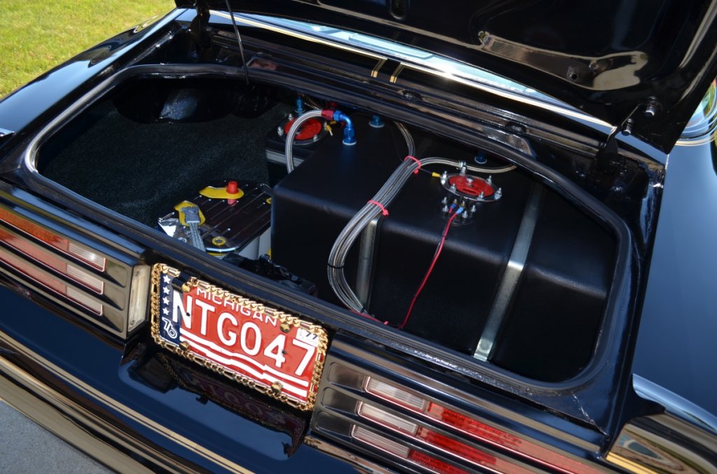

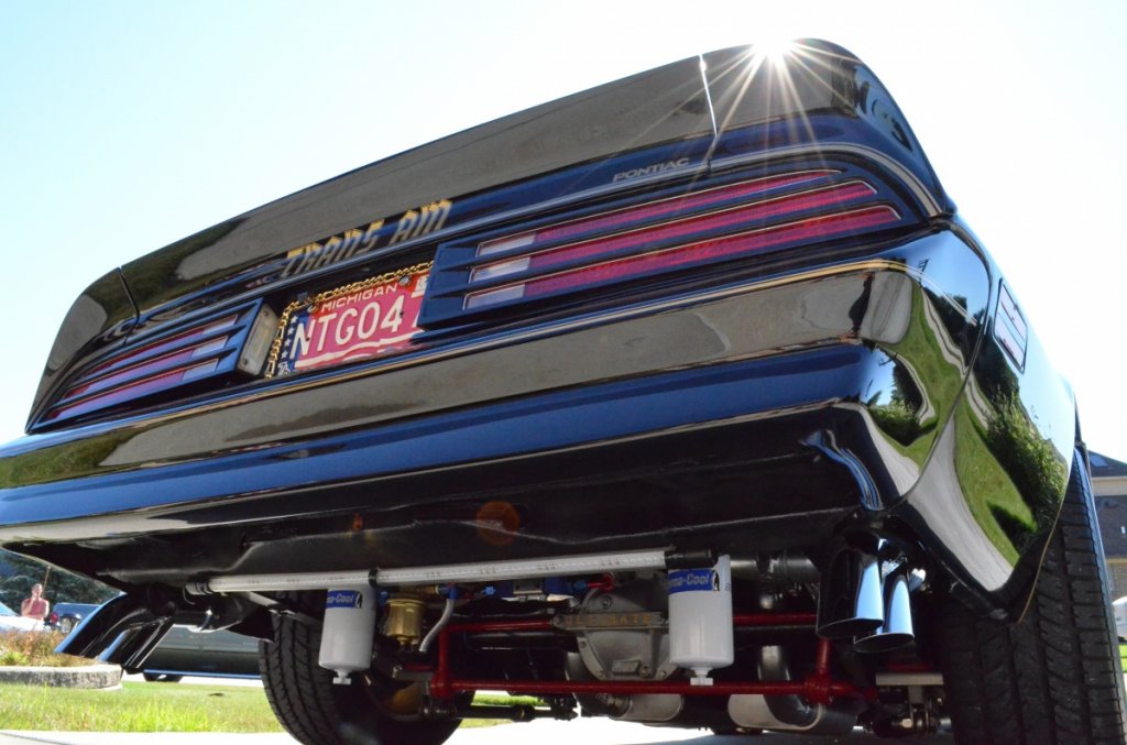

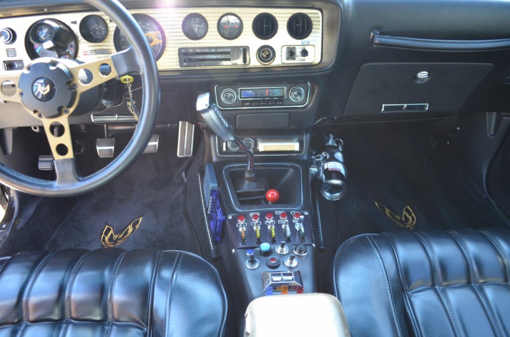

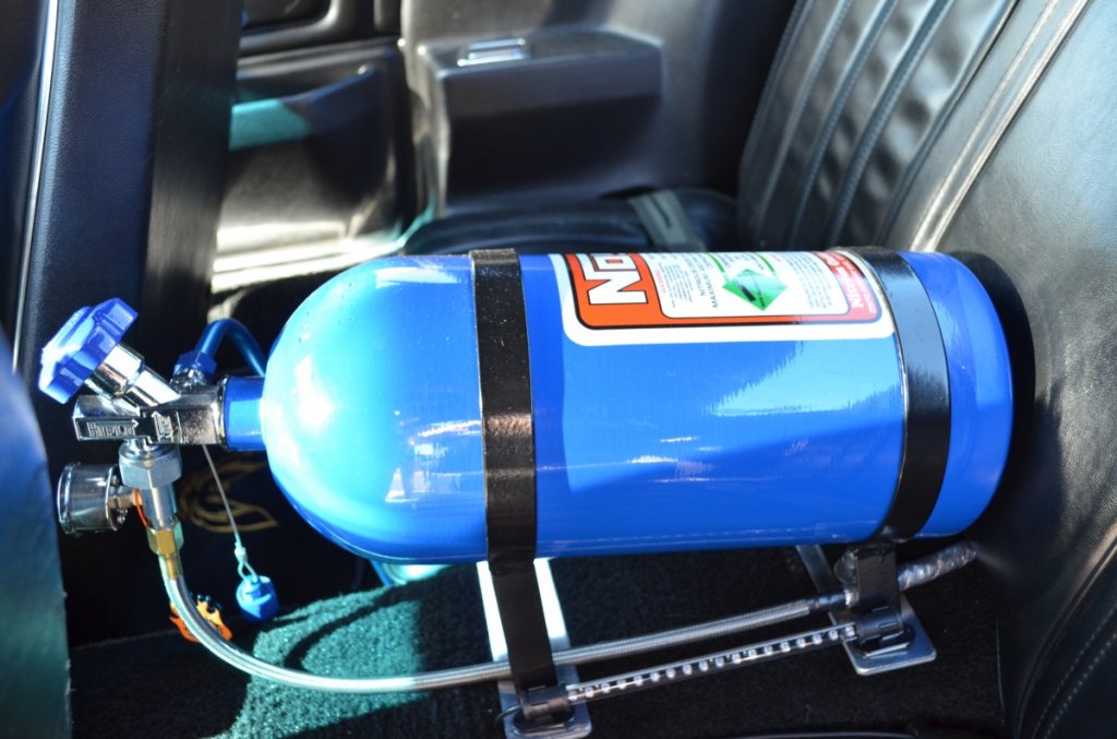

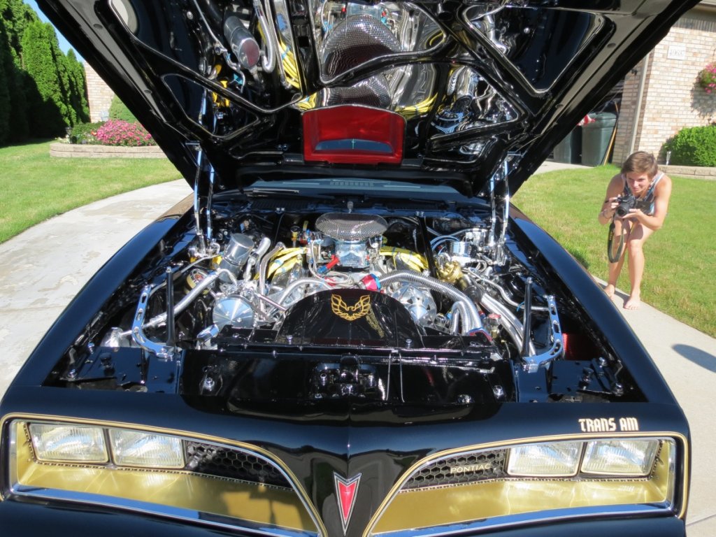

Thanks for the additional tips Danny, I will continue to tweak.  Also, I was able to fully adjust the Center Channel sound for sparkling clarity, as the XMC-1 has 11 equalization filters fully adjustable from 20 - 20,000 hz.  It now sounds amazing, just like the LS9's.  And - I am a car nut/wrench as you may see - more eye candy of my original owner 1977 SE Bandit T/A.

I'm a car guy myself. That looks great!
If I remember correctly in 1977 there was a 400 Pontiac motor option and a 403 Oldsmobile motor option.
Looks like you modified it top to bottom. It even looks like you are using a serpentine belt to drive the accessories. I'd love to hear more about it. Start a new thread on it in my circle. GR Research customer hot rods.... :thumb:
