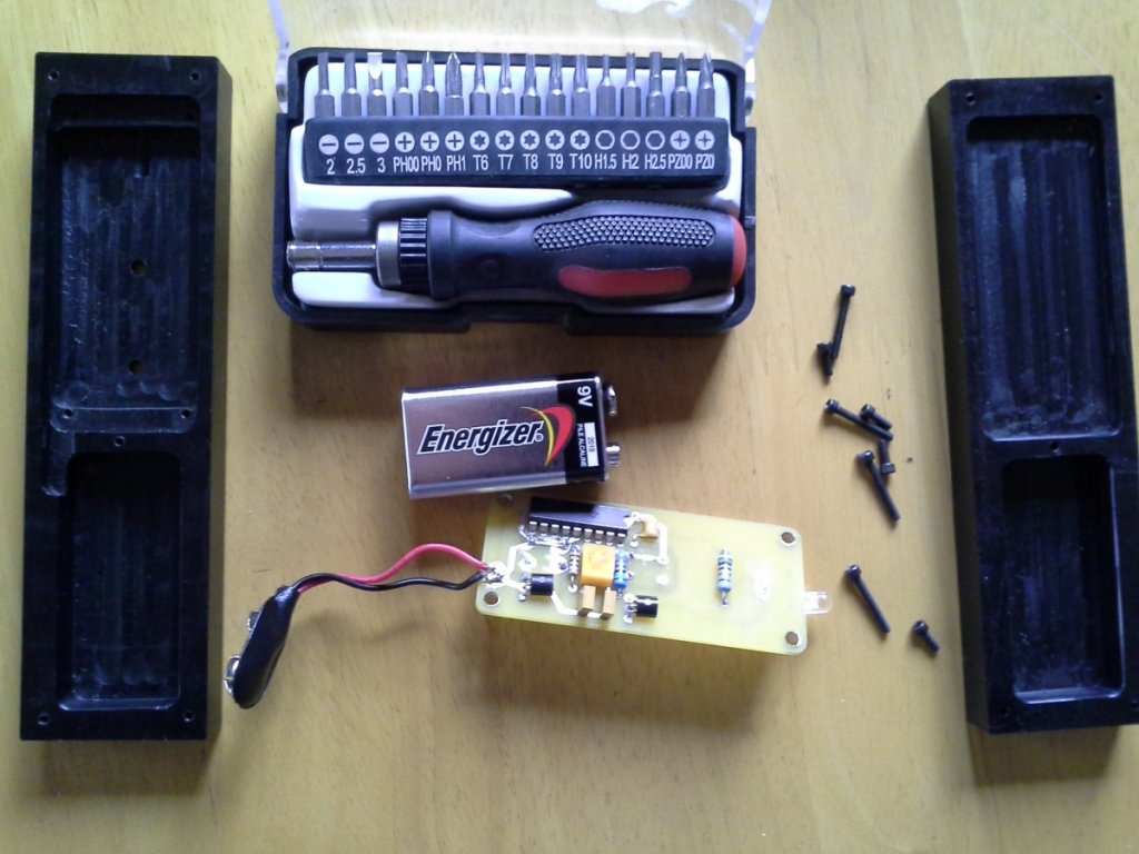

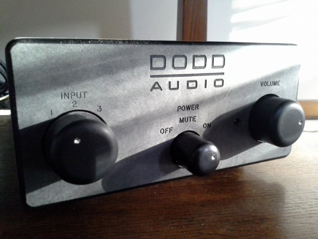

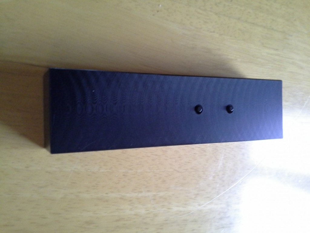

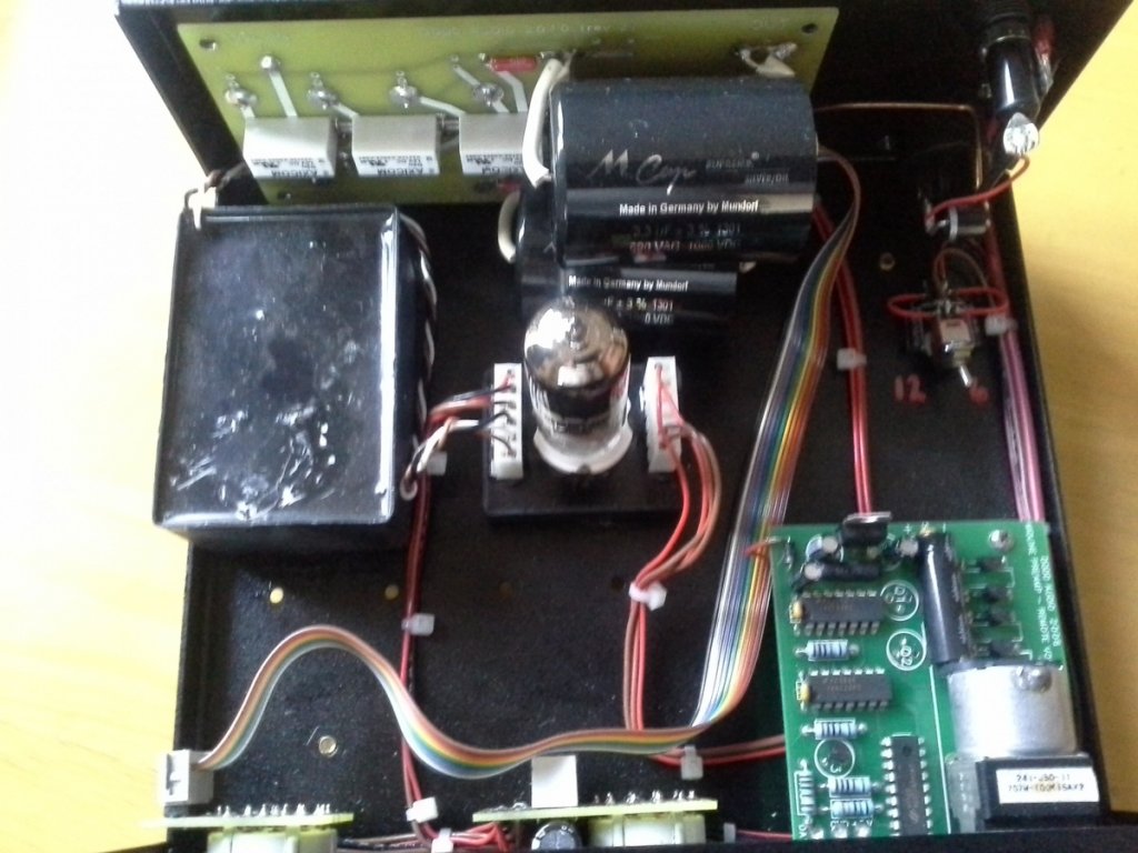

I own a Dodd Audio Buffer,  with remote volume control. Pics below.

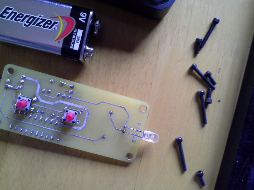

The remote volume has recently been erratic,  only when using it for lowering the volume. Volume up, works fine from the remote, but the down button sticks. I was wondering if anyone knew how to get another circuit brd (P71192) for the handheld remote ?
Thanks, any help would be appreciated....!

it's obvious is the momentary switch the problem,replace that and bingo!,new again!

All I could find is black switches,  I ordered those. No red available.

if they are similar but black,replace both switches with black,cant you get a new switch from dodd audio?
if the red plastic button from the bad red switch can be cut and then be super glued on the black switch that would do better take it to a service person to do it for you,if you feel like it...
good luck... :thumb:

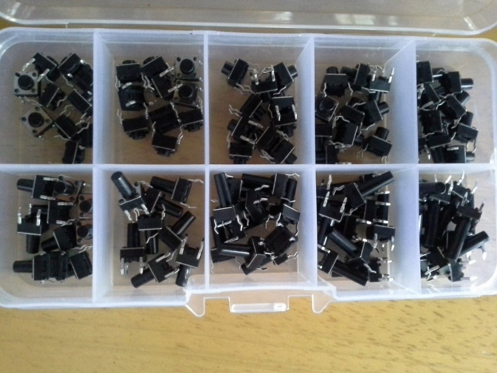

I got a variety pack of black switches coming. I'll have switches coming out my ears...  :lol:

I can't remember if mine are 6 or 7 mm. But, I got a variety pack coming, not sure when they will be here. but, if either of you need an extra or two. I'll have some..I got 5,6, 7 and 8 mm. just to be safe..

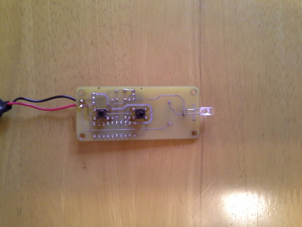

I got everything back, new switches in, works great. Also, I think it looks better all black.
