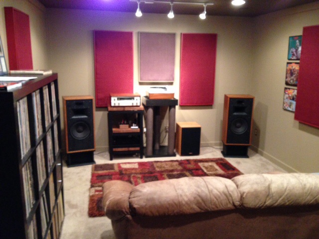

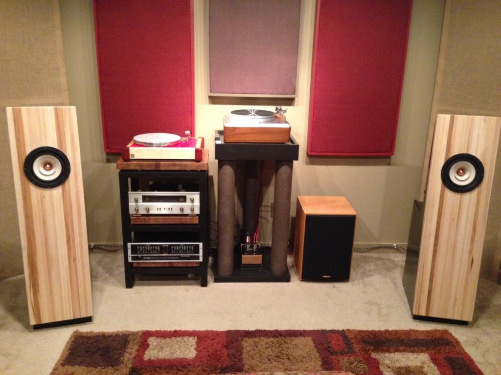

I'm looking for help/advice on an appropriate/optimal sub set-up for my listening room. I recently completed the build of a pair of Decware ZOB speakers (see them in this thread: http://www.audiocircle.com/index.php?topic=130284.0). I'm pretty happy with them so far (even though they have a ways to go before the TB W8-1808 drivers are broken in). That said, and as others have noted, they can use some help in the low end. I currently have them paired up with my Adire Audio Rava sealed sub, with some success. But I'm interested in building a pair of stereo subs, or at least a pair of subs run in mono. I have been looking at an H or U frame build, but a concerned about having enough space in my listening room to maximize their performance. The ones I've been considering would use the Eminence Alpha 15" woofers and plate amps. I started thinking about OB subs since they are OB speakers, but since the bass on the ZOB's is more similar to a traditional cabinet, I'm open to sealed subwoofers as well (which may be a better fit due to space constraints).
Here's the details of my room and equipment set-up (this is a dedicated listening room, by the way). The attachment shows the room in a previous iteration (a while ago) but it gives an idea of what I'm trying to describe:
Room dimensions are 12' x 17' with 7'6" ceiling
Equipment is on one of the short walls (audio rack and turntable stand)
Room is "live end/dead end" treated, with Superchunk corner traps in corners of wall where the equipment is , as well as absorptive panels on wall between the traps (behind equipment) and at the first reflection points on the side walls and ceiling. There is one absorptive panel on the back wall (behind my listening position) that I'm thinking about replacing with a diffuser.
The ZOB's are currently placed 40" from the front wall (to center front of the baffle) and 26" from the side walls to the center of the driver, with slight toe-in. The Rava sub is between the right speaker and my equipment racks (which are between the ZOB's on the front wall).
So, I don't have enough room for both subs to reside between the ZOB's and my equipment racks (only on one side is there enough space) at a similar distance from the front wall. I do have room to place subs 3' to 6' from the front wall, but only 0" to 12" from the side walls to the side of the cabinets. Any further out from the side walls and they'd be in the middle of my room and in front of my listening position, for the most part. I think the distance I could place H or U frames from the front wall would be okay, but I'm concerned they'd be too close to the side walls (from what I've read).
The first pic I attached hopefully gives some idea of the rooms layout (it's an old pic with old equipment).  The second pic shows the room fairly recently with the ZOBs in it.
Given my room dimensions, equipment location and the OB speakers I'd be using the with, what suggestions does anyone have for a set up that would be optimal for my situation? I look forward to reading any and all input!

Side wall and rear corner would be a good place to start.  You already have 2 bass producers in the front of your room (your speakers), so best to spread things out a bit.

Hi Tom, I would try right behind the sofa. It looks like it might be feasible in your situation. You will need a DSP crossover or an amp with DSP in it for best results. However this as all other suggestions would be a starting point only, measurement will be needed. I'd suggest drawing up a plan of the room, marking possible locations for subs, then measure all of them (or at least, likely candidates). Then you will know. Pick the best, and experiment with small position changes. In my room, front and rear wall centre work best (behind the chair not being feasible).
Mudslide
I'll second the measurements-required suggestion.  Or the "crawl technique" works but is hokey in my mind.  To avoid those things, I think you might want to look at the award winning DSPeaker AntiMode 2.0, which provides automatic room correction for multiple subs...and SO much more.  Check it out, here ... http://www.dspeaker.com/en/products/20-dual-core.shtml
If I had your room, I'd start with two subs...one where yours currently resides, and one opposing it on the back short wall.  If you have enough room to pull them out from corners a bit, then corner placement for each (in opposing corners) would be ideal.

I have room to leave one in the current location, and another on the back wall (more or less centered).  I can't do opposing corners though, since I have the bass traps on the front wall and a fireplace and door occupying the corners of the back wall.  I'll check out the DSP that was recommended.  I've also been considering the minidsp unit, which has gotten good reviews.
What about the subs themselves?  I have 2 available to me now; the Klipch SW-10 that is shown in the picture, and an Adire Audio Rava sealed sub (she's a beast), which I recently hauled into the room (it's typically my HT sub).  I'm thinking about building a couple small sealed subs.  Or, I could look for another matching SW-10 (it's a forward firing driver/passive radiator design).  I was originally thinking OB bass to go with the speakers, but I don't have nearly enough room to move them out from the walls.
You are wise to use two subs, as they will tend to cancel peak and null modes...somewhat.  That's why the Anti-Mode is so cool.  It'll flatten your room bass response fairly precisely.
Since you already have an SW10, I'd try another one.  They are affordable (but aren't the best for music).  Your budget should make the call on subs.  If you can afford them, a pair of Rythmyk sealed subs would offer musical bliss.  If you have the DIY bug, you can build some decent subs with the right drivers and amps, or use kits from the likes of GR Research.
