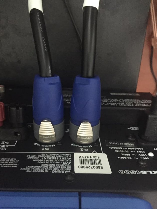

Everyone who claimed the speaker connectors are poor were right on the money.  After doing a lot of listening I put the bare cables into speakon connectors.  Immediately noticed the mids and treble cleaned up considerably.  The tonality is better and a lot of grunge is gone.  It makes little sense as it added an additional connector in the signal path but it made quite a nice improvement.
Before the speakon connectors I was going to say the mids and treble were OK and fairly grain free but not clean enough for a long listening session.  The speakon connectors take it up at least a few steps.  The mids and highs are more to a level you'd expect in a more expensive amp and it sounds good.
No, the speakons didn't add the harmonic richness of a tube amp but they made a pretty astounding improvement.  I wouldn't have the right impression of the amp if this thread hadn't pointed out the connectors need help.
Wow - I'm loving the switch to Speakon cables for my XLS1500!  I got some custom speaker cables at a reasonable price and I think it cleaned up the sound from when I was using the regular binding posts.
https://www.performanceaudio.com/custom-cables-speaker-cable-made-from-canare-4s11-speaker-wire.html
Next I might try a balanced passive preamp with XLR connections....but one step at a time.
