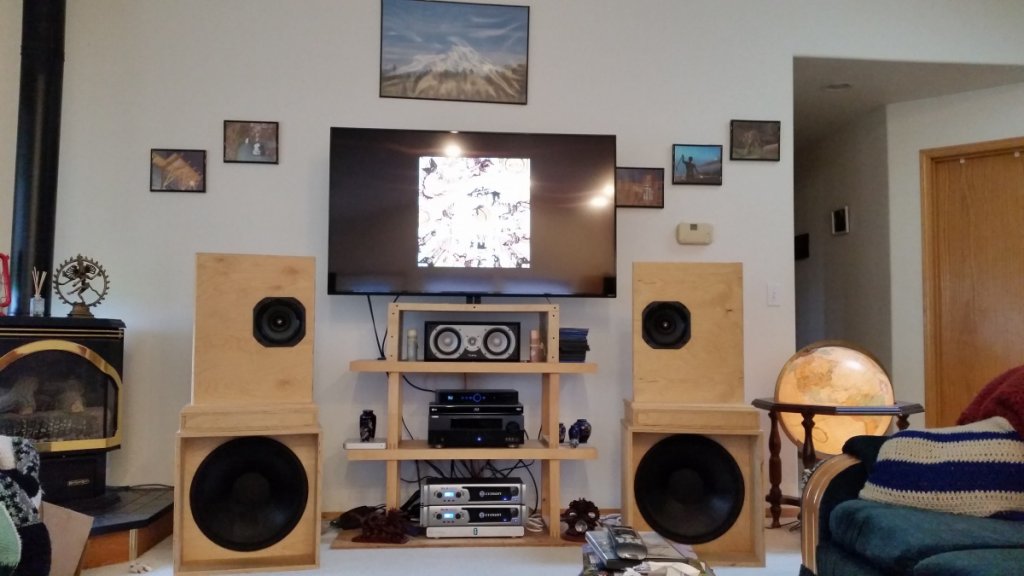

Well, I've had the pair of Crown XLS 1500s for a couple of weeks now and they are keepers!  I might upgrade to the version 2 one day, when the right price accompanies them, but I even sold off my consumer amps and haven't turned back.  For gain I tried both the Rolls unit and a very nice Aphex 124A and ultimately went with the gain adjustment in my AVR after reading the well written tutorial (several times) at hometheatershack.  My rather efficient DIY open baffles might never make all the LEDs on the Crowns light up but they sound great!  The miniDSP I was using for XO duty is put away in a closet and I've been experimenting with the internal filters in the amps (one amp per side)...  Now the bug has bit and I'm starting to feel the seeds of DIY speaker madness growing in my brain again, but it's nice to know that the amps I've purchased are capable of coping much with much more than my current setup.  :)
PS I also bought a Tripp Lite AV86G "Eco Surge" power strip that lets me use my AVR as "Master" and the Crowns as slaves which works extremely well, with full EMI/RFI filtering as a bonus.
