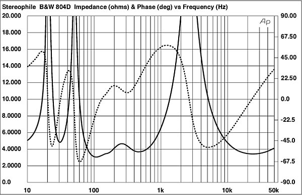

Steve how about 804d 200w 8Ω do  I lose quality if I bridge the 4bsst2?
The B&W 803D digs a few Hz lower than the 804D and can play louder with greater power handling with 3 X 7" bass drivers vs 2 X 6.5", but the 804D has a very similar impedance curve with a 3 ohm dip between 80Hz and 200Hz and just below 4 ohms in the ~ 350Hz to 600Hz range.
As far as sound quality, bridged amps may have a bit more THD at lower impedances but on the other hand often have higher damping factors and faster slew rates.  It's probably a wash and many people perceive no loss in quality and it's more of decision based on speaker impedances.  While there's no hard rule and speaker impedance curves vary greatly among speakers, I usually consider speakers with minimum impedances of 6 ohms or greater better candidates for bridged amplifiers.
