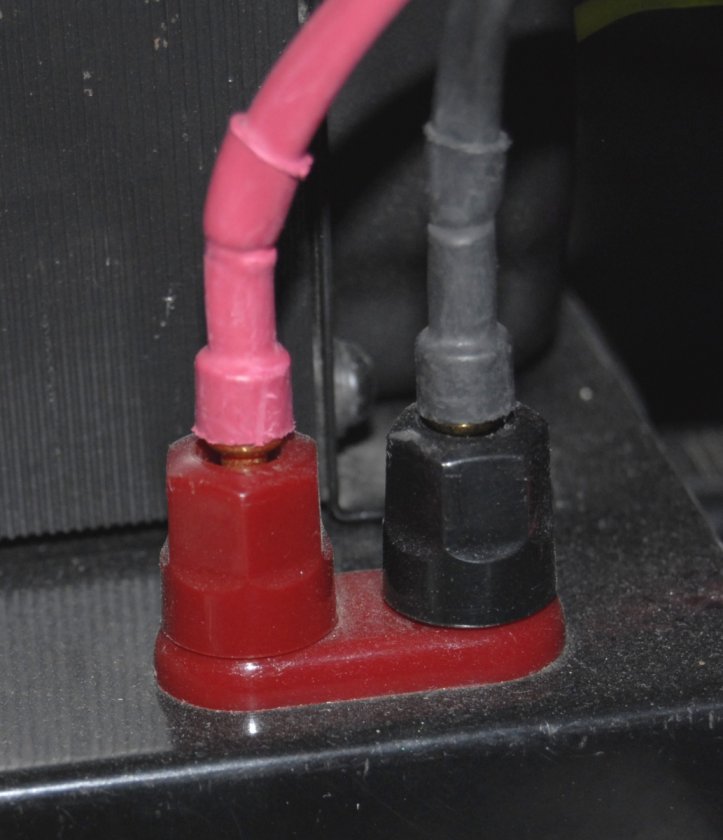

Guy 13
Re: Is the best speaker connection a wire nut?
« Reply #14 on: 15 Aug 2014, 01:12 pm »
Hi all.
This is how I have connected my amplifier to my Omega 7F driver.
Soldered connections to Omega driver terminals with Signal Cables
double 14ga. OFC wire 10 feet later to the output 5 ways terminals
of the Decware SE84C+ amplifier.
I wanted to go directly inside the amplifier to the wires
of the output transformer, but that's too much.
If I want to change speakers, because I have two more sets or move
something, it would be difficult and like I often say:
Audio should be simple !
I am happy with my set up now, so hands off...
Guy 13
