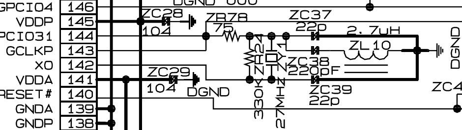

« Reply #233 on: 7 Nov 2005, 07:44 pm »
I've updated the clock in my player and it's really not that difficult.  The new clock is not cheap, but it think worthwhile.
Here is what I have done.  You need to remove part of the original clock circuit, two surface mount capacitors and the crystal.  Getting the crystal out is easy, the surface mount capacitors require a little more care.
Here is what I removed from the clock circuit. Crystal oscillator ZY1 along  capacitors ZC37/22pf and ZC39/22pf.  I don't believe capacitor ZC38 or inductor ZL10 actually exist on the circuit board.
I then soldered the positive output from the Superclock to the pad where ZY1 was, this connects to pin 142 of the Zolan chip ZR36778, the clock input XO. The negative lead from the Superclock I attached to DGND at the - leg of capacitor SAE7.  Electrically this is the same point as the grounded leg of capacitor ZC37 or ZC39, it is simply easier to solder to SAE7.
To power the clock I'm currently using a 12V battery.  You could pickup power from the main board of the player.  There are a couple of voltage regulators that are fed 12Vdc, you could use this as a supply for the new clock.  I mounted the clock board on the rear of the case with a couple bolts and stand-offs.  That's it!
I'd be interested in hearing how RAM connects the clock on their modified player (I believe someone here mentioned they had one with a clock upgrade).  I'm wondering if resistors ZR24 and ZR78 could be removed and replaced with jumpers.
I've attached the schematic of the stock clock circuit  below.
Go upgrade your clocks!

BobM
Modding the Toshiba SD4960 DVD/DVD-A/CD/SACD player
« Reply #234 on: 7 Nov 2005, 08:11 pm »
So ... what kind of a difference did the clock make over the stock crystal?
Bob

STeveL
  • Posts: 13
« Reply #236 on: 7 Nov 2005, 08:43 pm »
Hi Bob,
With the new clock the difference is there.
I'm not one for using all the various audiophile terms, but what I noticed was more detail, especially in the background.  I was hearing vocals and instruments that I'd never really noticed before, everything seems to suddenly stand out.  There's more air around the instruments, rather than simply a wall of sound. It's more musical and involving.  The soundstage might be slightly larger.  But for me, the biggest difference is the nuances and detail of guitars and vocals, it was always there, but now it's part of the music.
STeve
