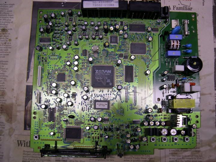

Here's a picture of board with caps to be swapped marked with a yellow dot on top. Note, I couldn’t find the following caps on the board (PEF23, PES54, and SAE2 seems to be marked SAE7 on the board). Maybe there’s a small discrepancy between the schematic and production, or Maybe Toshiba did change some things from Samsung’s schematic?
(Hopefully this link works - please let me know if it is not visible to you'all, and how I can make it visible.)
All of the yellow dotted caps on the right side of the board are power supply related.
The ones at the top right are DAC and SACD related.
The two at the top left are not being replaced. Those are the 1st locations post DAC where I will pull the Swenson mod from.

can't see your picture - I would really like to see a few closup pix of the guts of that player. Just an hour ago I opened a Panasonic DVD player I have here in the office and the layout in that box doesn't really make modding easy (transport is screwed right on the signal board...)
do you have a modded 3950 you can compare this unit to in terms of redbook transport peformance? I've had pretty good success with my 3950 mods until I blew up the PSU trying out some fancy diodes ;-)  So while waiting for a new cheap 3950 on ebay to gut for parts, I have some time to consider future projects  :mrgreen:

Yeah, seems like a broken link to the picture. Lets try it again:
or if not, then this direct URL should get you there:
http://photobucket.com/albums/v226/ptmconsulting/Miscellaneous/?action=view¤t=4960Board-premod.jpg
As for comparisons against the 3960 - no I don't have one. They are actually very different beasts. The 3950/3960 are designed and made by Toshiba. The 4960 is designed and made by Samsung and relabeled as a Toshiba. The 4960 is also a universal player.
Read my initial impression reviews for more details on the 4960. The Redbook sound is very good for a $150 player in its stock form. It compared very favorably with my modded DI/O, which compares well to other $1000+ players and DAC's. I'm expecting any slight congestion will be cleared up by my power supply mods, and the soundstage should improve greatly with the Swenson mod.

Quote from: BobM
As for comparisons against the 3960 - no I don't have one. They are actually very different beasts. The 3950/3960 are designed and made by Toshiba. The 4960 is d ...
the link worked (and I hope that big old bug on images 2-5 wasn't in the box with the 4960 :-))
The board is very different from the 3950/60s (those have PSU "danger part" and signal boards in two pieces), but the build method is very similar. A large number of through-hole components on both means you can mod them pretty easily.
I'm not really interested in the universal player part, because I only have redbook CDs.  Based on what I see, the player has siginificantly more components on the signal board than the 3950's, but nothing really indicates that there are higher grade voltage regulators or anything else that spells out "quality"
Seems to me that all the extra circuitry gives you the multi-format capability, which is something I really don't care for.

« Reply #19 on: 20 Sep 2004, 01:42 pm »
OK, another week gone by and some new "adjustments" have been made. I wasn't completely happy with one aspect of the presentation from the player either pre or post mod, primarily in the area of PRAT. Some may call it the "speed" of the player or perhaps the punch. One person said it is probably the difference between your typical op-amp dynamic and the slightly softer Swenson coupling cap type of sound.
A bit more forgiving than I'm used to and definitely enjoyable and easy to listen to, but just the one area where I think it could use some help. Now I'm really picking at nits here. This is a very good sound right now. And for $119 from JandR.com right now, a no brainer.
Anyway, I tried to bring some of this leading edge transient back into the picture. I changed the following. I reversed the following caps back to their original specification. They all feed the DAC chip. I have seen in the past where too much capacitance can make the chip sound slow, so back they went.
AE8,9,22 - 3 caps
old: 220uF 16V
AE7 - 1 caps
old: 47uF 16V
I also replaced the CAT5E wire from the board to the coupling caps with 30 guage silver coated copper & Kyner insulation. Wish I had some teflon coated solid silver wire around, but at $4-5 per foot for something between 24-30 guage (and you'll need just shy of 6 feet of this) I think I'll stick with this new wire for now. Silver interconnects also improved on the presentation over copper wire.
The 2 mica bridging caps on the RCA's also went bye-bye. Fatcobra said this helped open up his sound with minor or no problem with noise in the signal path. Now that they are gone I can confirm that I hear absolutely no pops or clicks or anything else that I could construe as noise that these things may have been preventing before.
So, the change in the sound. Definitely more open. Somewhat more detailed too, but still warm and inviting and laid back. The leading edge transients also appear to be better, but it is truly hard to tell without a direct A-B comparison. I can say they are still less than I am used to with my op-amp based ART DI/O.
Please remember, this is a subtle difference I'm extrapolating on, not a mind blowing one, so please keep that in perspective. Both units sound fairly similar in many ways. It's just the attack of the note that I'm trying to sharpen up a bit with the Toshiba.
I also played with AC polarity to see if it made any difference. It does. Mine works best in the regular polarity (big sized AC tong to the ground side of the outlet). I'm guessing here, but this probably has more to do with the orientation of the .47uF Auricaps across the AC input than anything else. If you put their red lead on the + and the green one on the - side then you should be OK and have the same results as I did with polarity.
So, how to take this more in the same direction? Don't know. I need your suggestions. Wish I could get four 1A 600V fast recovery diodes and rebuild the rectifier bridge, but I haven't found a source that doesn't want a minimum order size that makes this prohibitive.
Any thoughts and suggestions?
