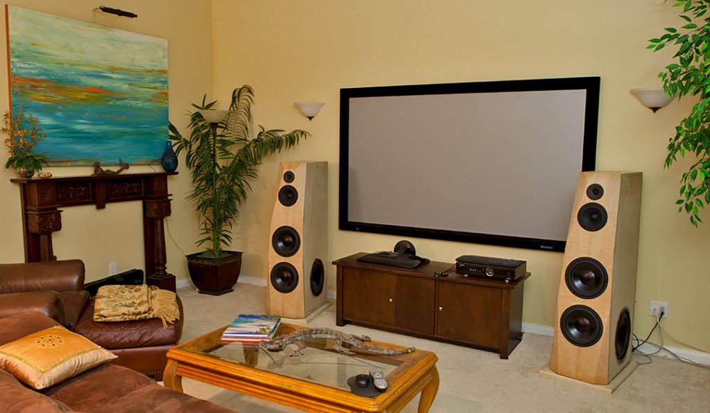

This is the system we are talking about.  Unfortunately, there isn't a lot of options for moving things around.  I am assuming the reflection is coming off the back wall, but I guess I really need to take some measurements and see where they are coming from.

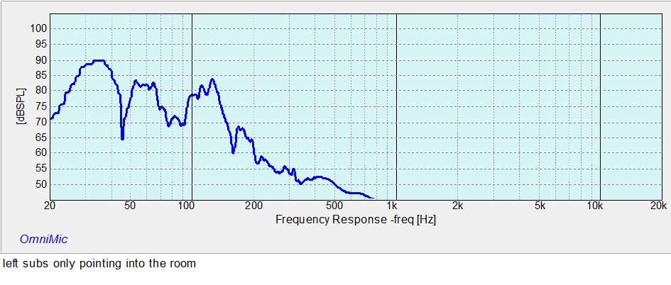

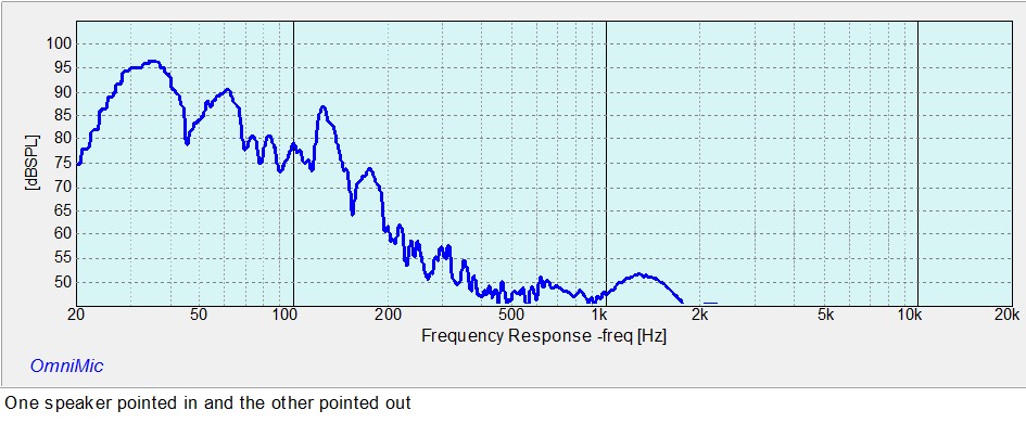

Now this was a disappointment.  Prompted by one of JohnR's suggestions, I tried some measurements with a speaker pointed to the wall and then next to it, the other speaker pointed into the room as usual.  I expected some differences due to the fact that I have two large speakers side by side, but I also expected to see the room modes effected a lot more than I did.
I guess this is why the manufactures don't bother with front and rear speakers.
Unless someone can see a major hole in my practice, I'll have to scrap the idea of moving one of these woofers to the back of the cabinet and look for better ways of minimizing room artifacts.
