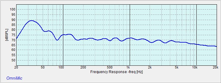

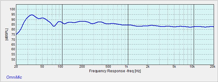

OK....After a bit of messing around from the listening position both channels driven full frequency, with 1/6th octave smoothing here is where I am.  All and all, not to bad and it really it sounds good. Jazz, classical so far the bass strings sound real nice.  Male voices clear with a nice open sound stage I can hear into quite deep.  I'll probably play with the 35hz bump a bit.  Maybe pull the tuning frequency down a bit, but I think this is going to be pretty close to where this system goes.
I think I got caught up a little to much in what  the graphs look like rather than what it sounds like.
Maybe I'll play with additional subs at some point, or maybe consider some room treatment, but for now.  I am happy.  Maybe I'll finish that veneer now.
At 1 meter:
At listening position with both speakers playing:

Why does it looks like there is alot of low end in your system?

ricardojoa, I added a frequency plot in the post above to compare with listening position.  I believe I could lower the tuning frequency and it would bring that 35hz bump down a bit.  Also, and the original reason for the thread is there is some room interaction involved that increases the appearant volume at those frequencies.  It should be addressed, and this is a work in process, so that will be in the works.
