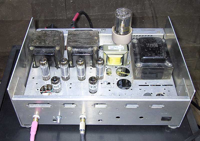

Depends on where the bias is set. If a PP amp is Class A all the tubes need to be fully on all the time, in Class AB a tube turns off for part of the cycle, One of our best amps is a trioded Class A EL84. It outputs 3.2 W at clipping.
dave
Hi Dave.
Any picture(s) of your best triode Class A el84 ?
Or a link where I can have a look.
Guy 13
It never got pretty (have to build another one 1st) It is an El-Cheapo derivative.
