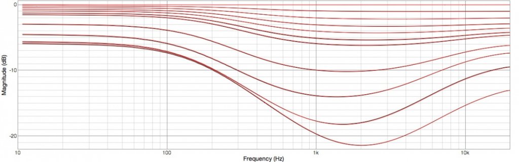

I think it's a cool idea.  8)  I wouldn't mind having something like this to play around with. Maybe put it right after the phono stage. Although it looks like it could go anywhere at line level. Clever idea.
It is a passive device, so I am very curious about the following :
1. What is the input impedance?
2. What is the output impedance?
3. What is the insertion loss?
4. How much cable capacitance can it see on the output before it runs into trouble?
I run a passive pre, so this is useful information for me.

BTW, I was serious when I asked about the technical specs. It might be useful to some perspective buyers.

Hello Quiet Earth,
Nice to get back to answering technical questions instead of getting "skewered" on pricing decisions and labour costs  :(.
I ask each buyer about their equipment (e.g. their preamp output impedance and their amp input impedance/sensitivity) and adjust the component values accordingly. This takes time too, BTW.
What I am aiming for the illustrated by the following curve (in this case for a ~10K output impedance and ~100K input):
I generated the graph using FuzzMeasure with a 2 second sweep from 20 to 20,000Hz. Each line in the curve represents a 30deg rotation of the knob. The overlapped lines at the top represent bypass and full-counterclockwise. Right channel is red, left channel is black, so you can also see L/R channel tracking is pretty darn good.
There is ZERO insertion loss with the bypass engaged (of course) and with the knob fully counterclockwise. As you turn the knob, the overall volume decreases non-linearly (it tapers very gently at first, more toward the end) and based on frequency as you can see in the graph. With the most dramatic decrease at the clockwise-most end of the range, where the control is close to one of my favorite loudness compensation curves (vintage McIntosh.)
As it turns out, since most system have plenty of gain and many potentiometers don't track very well at the bottom end of their range, and that that end of the range is for loudness compensation (i.e. low-volume listening) this is not an issue but a benefit for 90% of people. However, if you have a passive preamp feeding a 2W SET  :P that loss in dbs might be too much.
The alternative was to make it an active device and offer unity gain, but that would have required many more components additional noise, cost, etc., even if I used opamps.
I hope this answers some questions. I have a couple of videos that explains/address these matter in more details: http://www.deliciousdecibels.com/videos.html
Thank you for keeping the discussion technical, this is The Lab forum after all.
