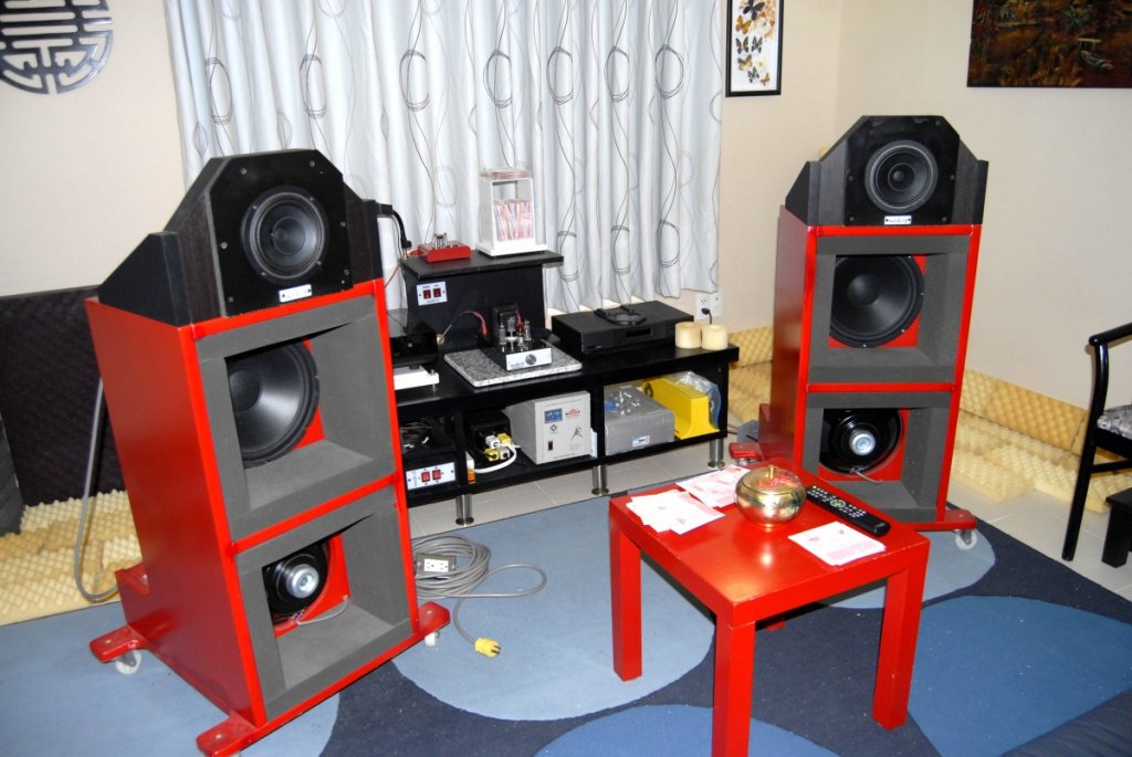

A follow up on my recent Omega 7F purchase.
The Omega will replace the Audio Nirvana;
that I have enjoyed for about 5 years.

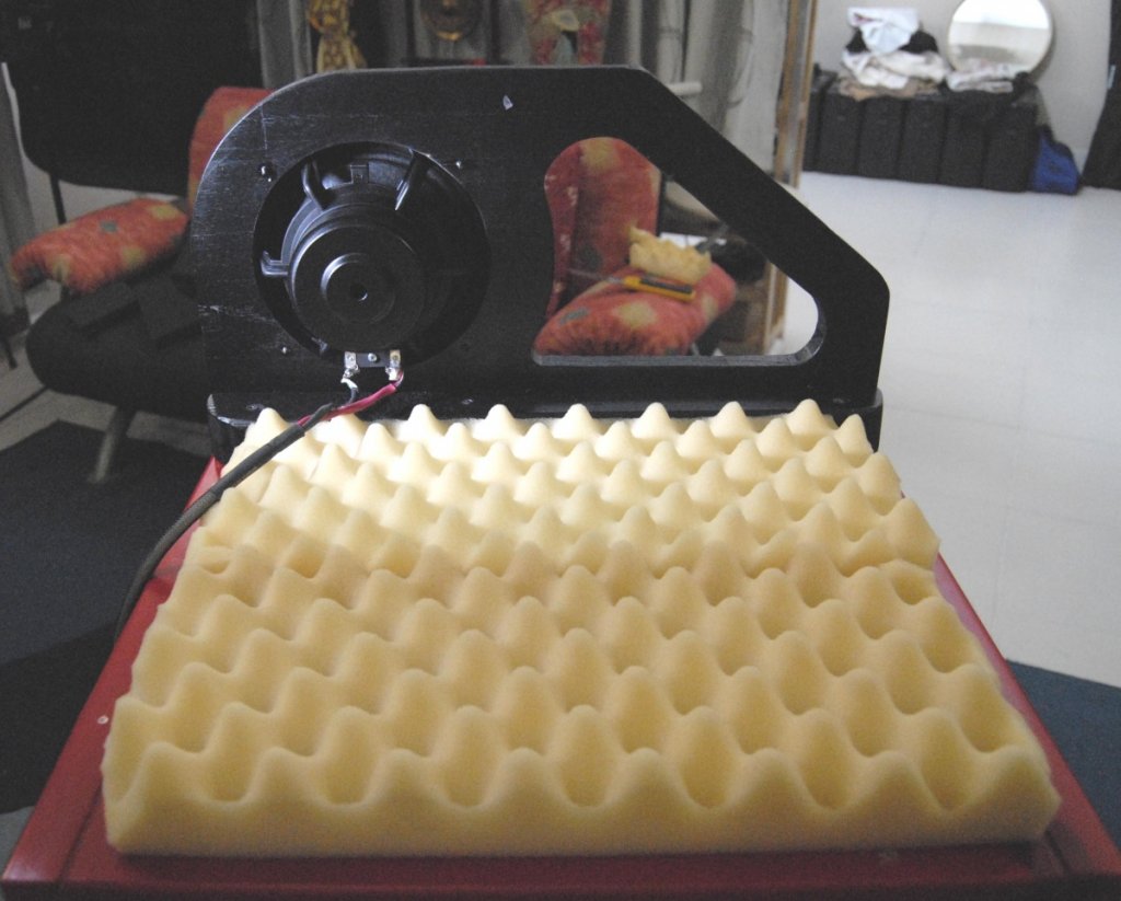

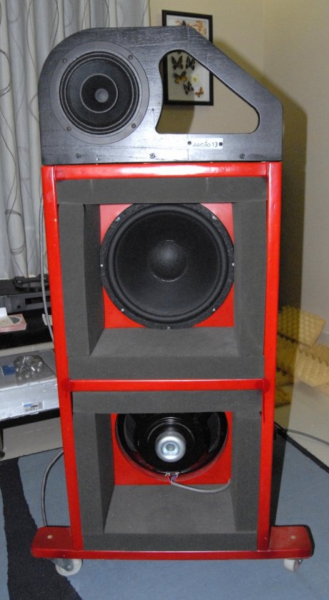

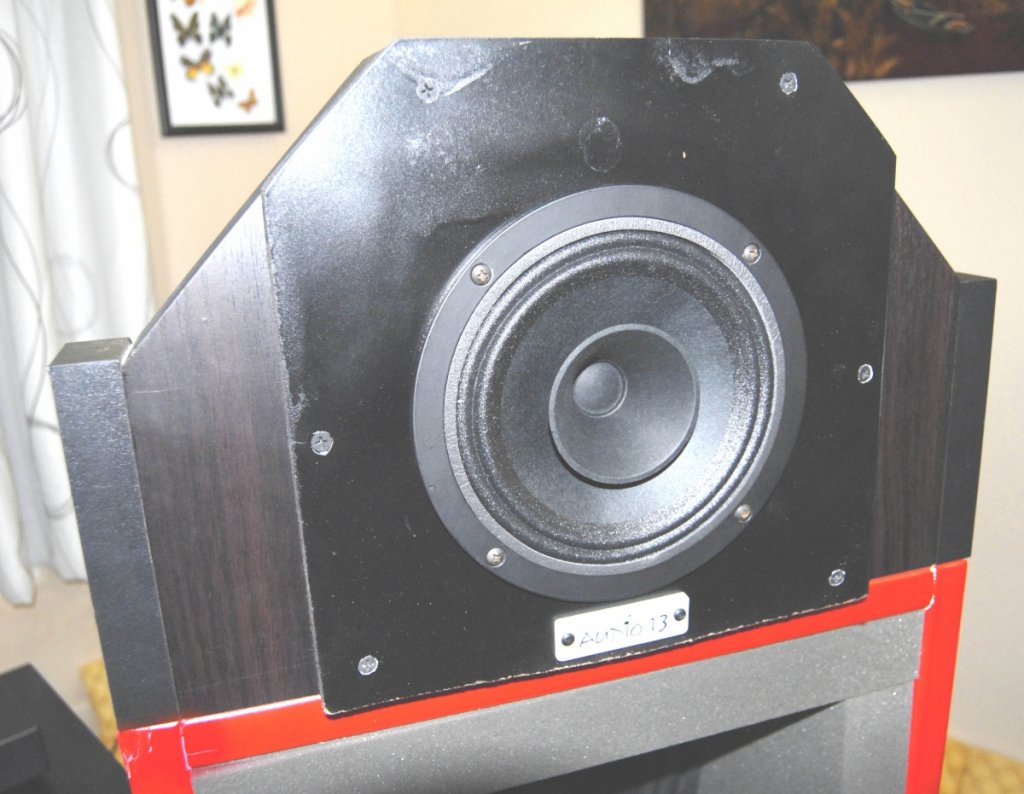

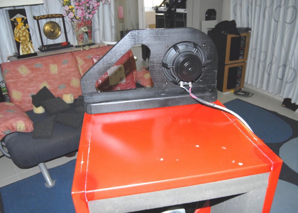

Now the Omega 7F have been installed to the best of my abilities. However, later on, they will find a new home, I mean a new enclosure bass reflex or OB dipole, will see.
03-06
I know it’s far from being the best arrangement, but for now, it will do.

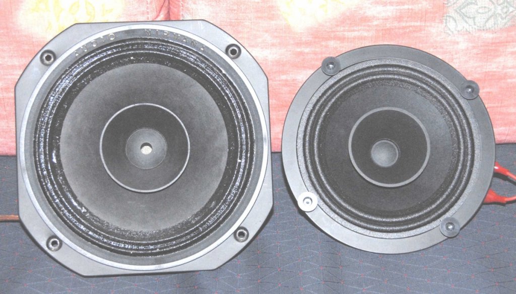

Guy 13
Side by side comparaison.
The magnet of the Audio Nirvana is double the size...
Does that make it sound better ? ? ?

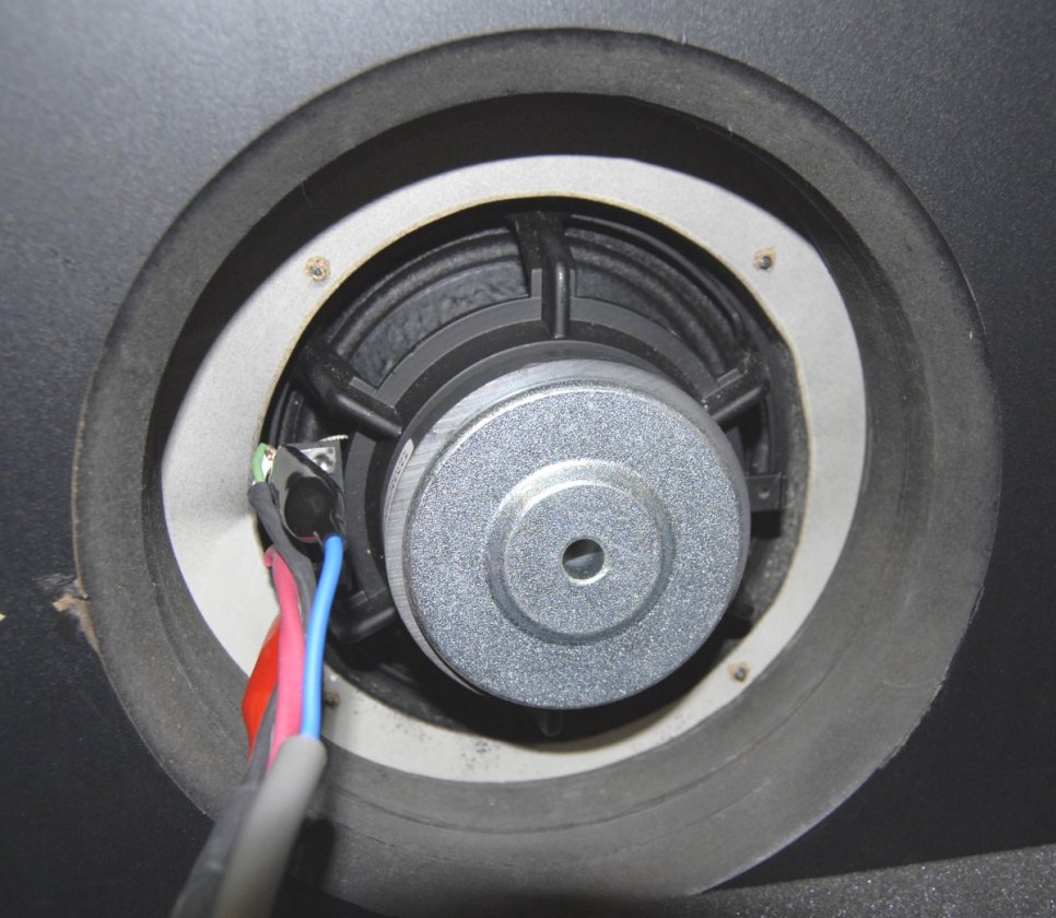

Great posts Guy,

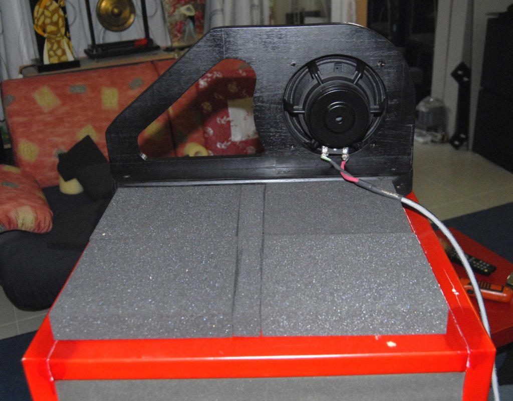

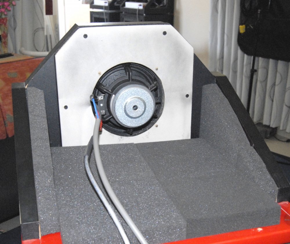

I noticed you set the 7F in the back of the hole your Audio Nirvana driver was in.  It might be a good idea to try and get the 7F flush with the front of the baffle, as your current setup could be giving you edge diffraction thus effecting imaging and possibly tone.
Guy 13
Re: Follow up on my Omega 7F
« Reply #8 on: 11 Feb 2014, 02:05 am »
Great posts Guy,
Hi Canada Rob and all Audio Circle members.
My first idea was to put the adaptor plate on which the 7F is mounted on in front of the thick existing plate,
but I said to myself, it will look ungly, therefore, I've put it in the back, knowing that it 's not the ideal set up.
In addition, I thought that the 7F should more or less be aligned with the woofer voice coil.
But now that you mention it, it cost nothing other than a few minutes to make the change.
I will try it and report my new findings.
By the way, I have 10 more hours on the 7F, 10 more to go.
I was listening to my Decware + 7F combo while doing some other stuff
and I was surprised how my system sounds good,
of course, depending on the quality of the recording.
Guy 13

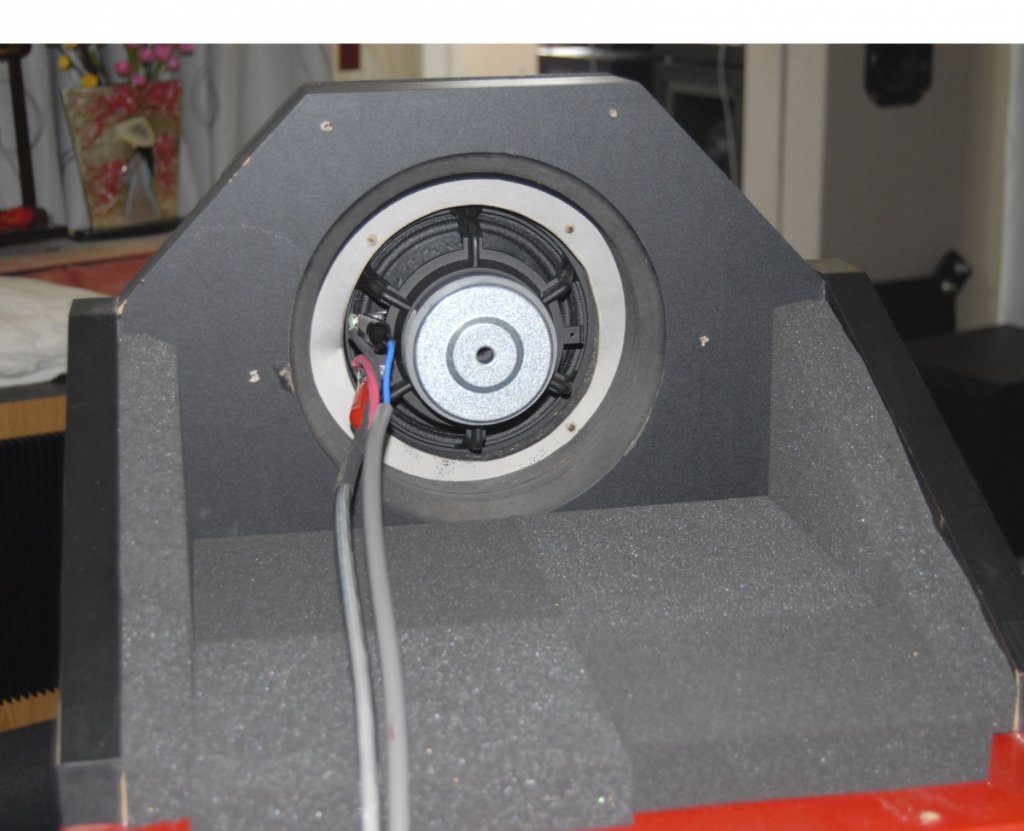

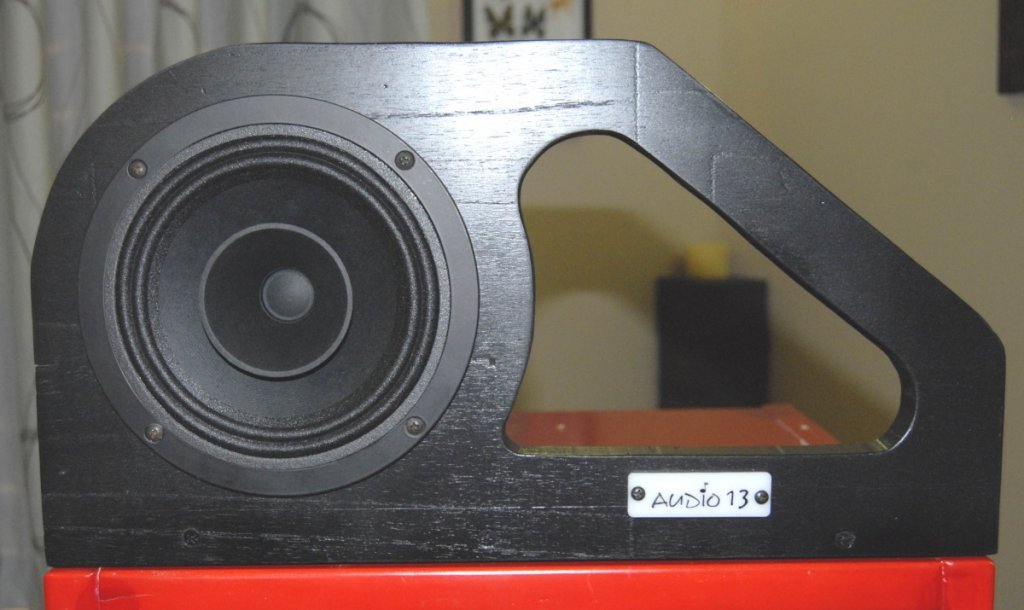

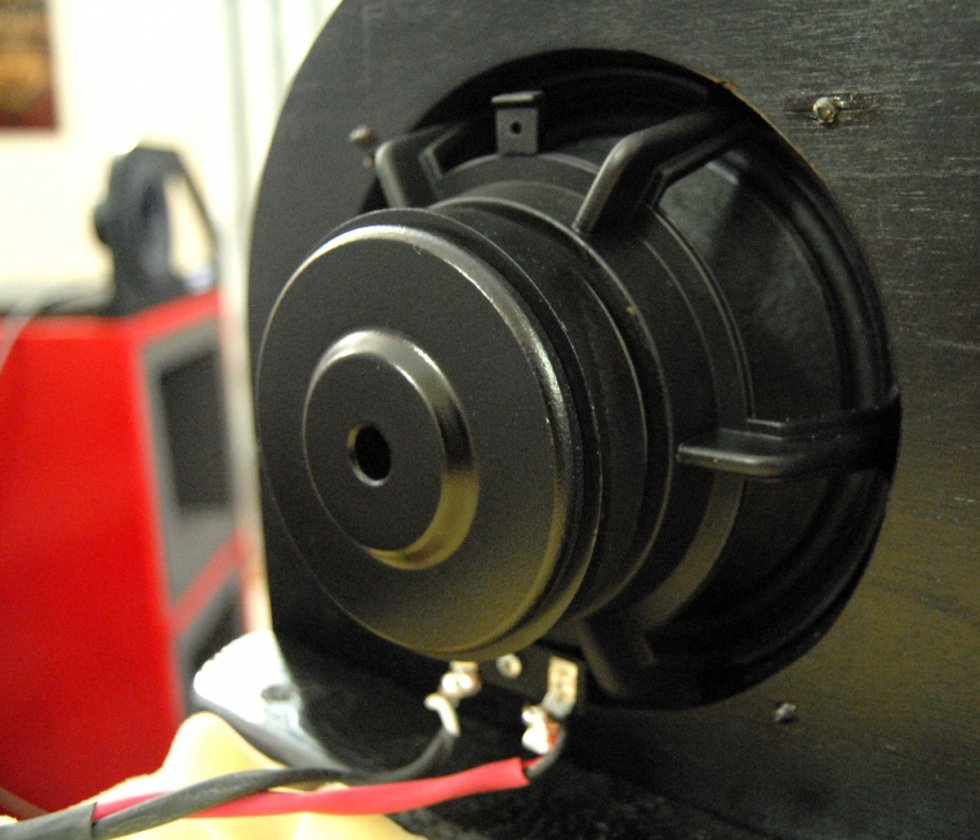

« Reply #11 on: 13 Feb 2014, 08:32 am »
Great posts Guy,

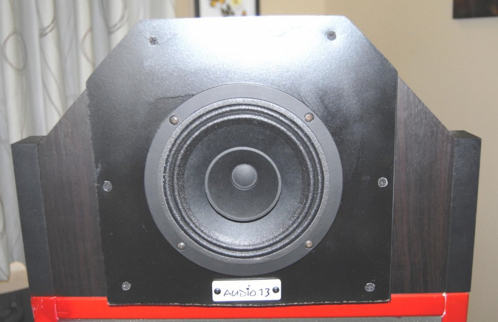

I just moved the adapter plate with the Omega 7F from the back to the front
of the existing original plate.
I cannot make the 7F flush with the original driver's mounting plate,
because, well because it's too much work... For me anyway.
For now, that will do.
Now, how about the sound?
Better ?
Well honestly, with my 66 years old (Today my birthday) ears,
I think the sound is better, a little better, but I am not sure, I think it is.
That's me; it takes for me a huge improvement for me to hear a difference.
But, I am sure it can't be worst, only better.
Thanks for the suggestion.
Later on this year, I might get a pair of Bass Reflex enclosures made
by my local cabinet maker, not necessary for better sound, but to try to shrink down the size of the speakers.
Pictures before.
...and after or now.

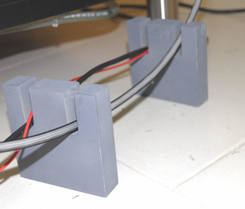

You did not make this suggestion, but I decided to try it, even if my floor is re-enforced concrete with ceramic tiles.
Each one made me poorer by 0,50USD.
Anymore suggestion, recommendations, ideas, they are all welcome,
it does not mean I will follow and do all of them, but they will increase my audio knowledge and that's always welcome.
Thanks Canada Rob.
Canada Guy 13.

I’ve decided to up-grade the look of my Audio 13 speakers.
I am keeping my Omega 7F because after 30 hours of burn-in they play as good as the first hour.
I love them.
Too bad Louis does not offer them anymore.
Well, if you are not like me, (Broke $$$) you can always buy a plug and play Omega speaker.
Now, for the final beauty touch, I would like to have the opinion of all interested Audio Circle members.
Which one you think is more handsome?
DSC9911
or this one
DSC9915
Those were built for almost free with everything I had in the garage, except a can of spray black paint and some sand paper.
I am looking for a nice looking support bracket to make the baffle sturdier.
Now, I need (Again) your advice, but this time it’s more for sound than look.
According to your experience, which one is better?
DSC9917
or this high density foam
DSC9920
or this medium density egg shell foam.
DSC9931
The idea is to eliminate the reflection of sound.
Close up of the Omega 7F with its newly black painted magnet.
DSC9926
Here is the almost complete Audio 13 speaker, the only missing item is the sub-woofer grill and that’s my next anti boring project.
DSC9927
 I am now riveted to my computer’s screen waiting for your suggestions and expert advices.

Guy, I like the top one best, it will likely help maintain a little more bass output from the driver as well.  I would recommend adding back your rear wings to help with the bass as well.  Very nice looking, good job.
Best,
Ed
