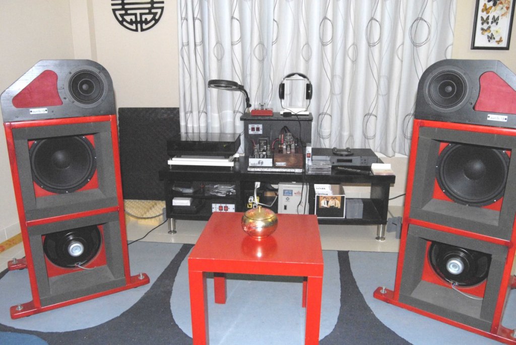

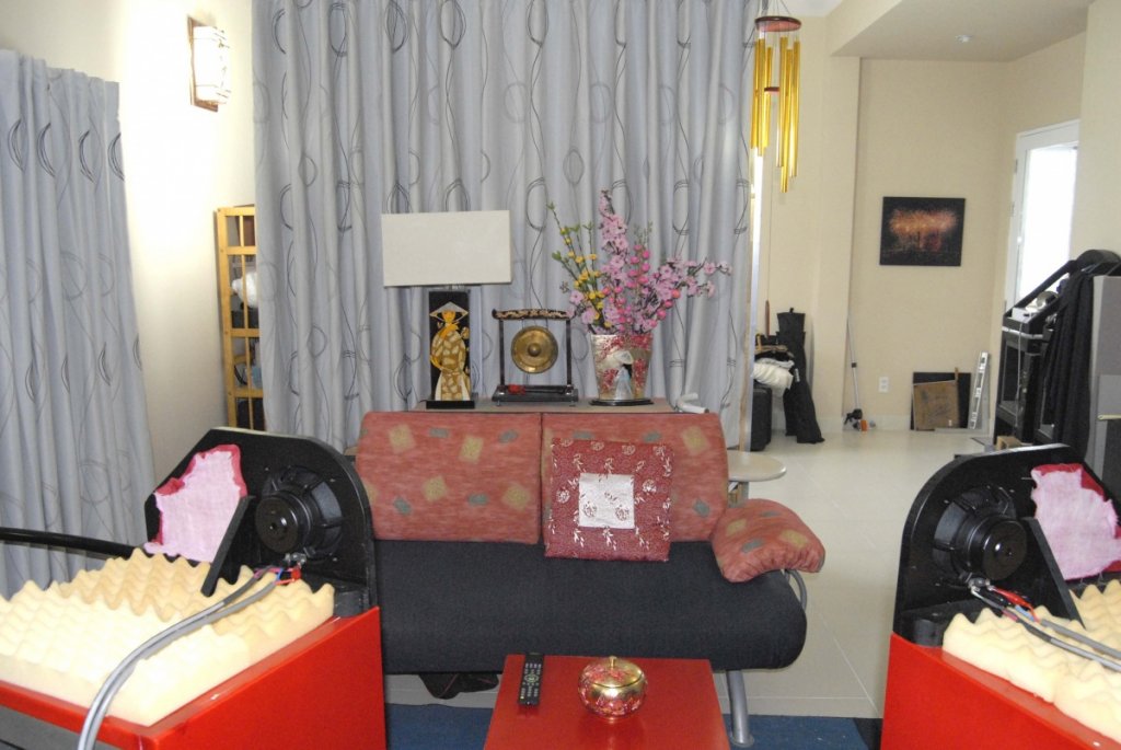

A few quick thoughts to improve the soundstaging
1) The height of your omega driver seems pretty high.  I think it'd be best if it were pointing approximately at ear level when you are sitting.
2) Definitely get rid of the table between you and the speakers.
3) How far away are your ears from the drivers vs each driver from itself?  I've found that a good starting point for me when setting up speakers is that you'll get good sound if the distance from the driver to your ears is about 10% longer than the distance between each driver.
4) Is there open space behind your sitting position?  For me, imaging and soundstage suffer if there isn't open space behind my seating position.
5) Experiment with toe in position.  Sometimes one can get really good results with extreme toe in where the speakers are pointing in front of the listening position.

Item 1 depend on the personal taste.
Item 2: I dont wished to be so assertive before because Guy had a also assertive wife, but I definitely agree this item.
Item 3 would be a good test.
Item 4 are very true.
Item 5: maybe I would like toe in this speaker.

Hi seikosha and FULLRANGMAN.
(My wife had a dog called Seiko...
I know: So what ? ? ?)
O.K. back to the main topic.
Thanks both of you for your advice.

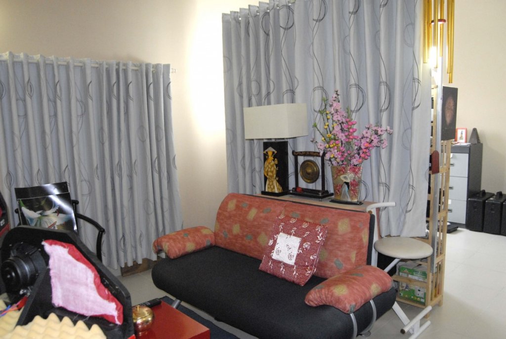

1) The height of the Omega 7F driver are at exactly 1 meter/39"
and when I am sitting, that's exactly in line with my ears.
2) I will temporally displace the red table, but even before it was there, I had the same problem and that's a fact.
3) Driver to ear is 5 feet, between the L & R drover 3 feet
and behind the speakers there's 6 feet.
4) See pictures below.
    I can push back by 12" the curtains and that's about it.
5) I will move around the speaker and change the angle (Toe).
I will do that this week and get back toward the end of the week
with some results.

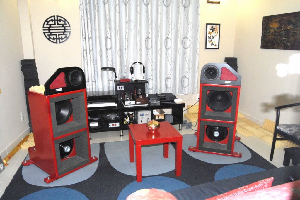

Hi all.
A follow up on what I did to improve the size of the soundstage
of my system.
First I pushed back by about 6"/15cm the audio rack.
Second, I've put more space between the speakers.
Now it's 5'/150cm center to center.
I've toed in the drivers so they fire right in front of my face.
The drivers are still at my ear level.
I've remove the small red table, but did not make any change.
I could not push back the big shelving in the back of the sofa, so it staed the same.
Now after doing all that, guess what ?
I will nt sue the word deeper sound stage, but let me put it with my own words.
I hope it will make sense to you.
The sound stage is now bigger, more impressive, a little more realistic, ]
it's still not as deep as I would like, but I have enough improvement to stop now all that furniture and heavy stuff moving around.
To me, now the sound is good enough to keep me happy and enjoy the music.
Thanks to all for your suggestion.
Here some pictures of my new set up, if you don't agree and/or want to suggest more changes, well forget it, I am not moving anything, that's it and that's all.

OK, this inprovements are expected. My additional suggestions are remove that red table to maybe behind the sofa you seat, and also remove the black chair Iam seeing at just right of the loudspeaker.
This will do some more free space to the soundstage stretch his legs.
Dipole and bipolar loudspeakers must sit is a surrounding free space.

Hi FULLRANGEMAN.
I already removed the small red table and it did not make any difference.
For the black Chinese chair, I don't it makes any difference being there or not, but what do I have to loose?
I will do that right now and get back to you in about 20 minutes.

  Hey Guy. When you catch your breath realize you have a nearfield set up. With nearfield a triangular set up with equal distance between listener and speakers. I would suggest trying aiming the tweeters just outside your shoulders. If you feel energetic enough try the tweeters on the outside again aiming at shoulders.
   As far as the drape behind you that is OK. Can you slide the drape to open room ? You may also consider adding some absorption panels at front wall. Depth should improve with the panels. To experiment use a blanket or similar material. Some like diffusion on front wall however the open baffle may not oblige. Experiment.
   With toe in stop when the speakers totally disappear. The 6Ft behind the speaker is VG, leave that be. An after market tweak Herbie's carpet sliders are highly recommended they will open up the sound stage even more when speakers are decoupled from floor, any floor.
    Guy if you find a copy of the Sheffield/XLO set up and break in CD it allows you to fine tune your set up. Tracks with depth, width and in and out of phase signals are very helpfull.
    Have fun take your time and enjoy the results. BTW please consider using compressed wool felt in lieu of the foam and stuff. It will eliminate the reflections from the tweeter off the woofer box as well as the tweeter panel.  Nice speakers there Kido.

Hi all.
of my system.
Guy 13
Hi guy13
Nice speakers!!!
Are they a mix of ob and closed box?
I dont see a tweeter there?
cheers
