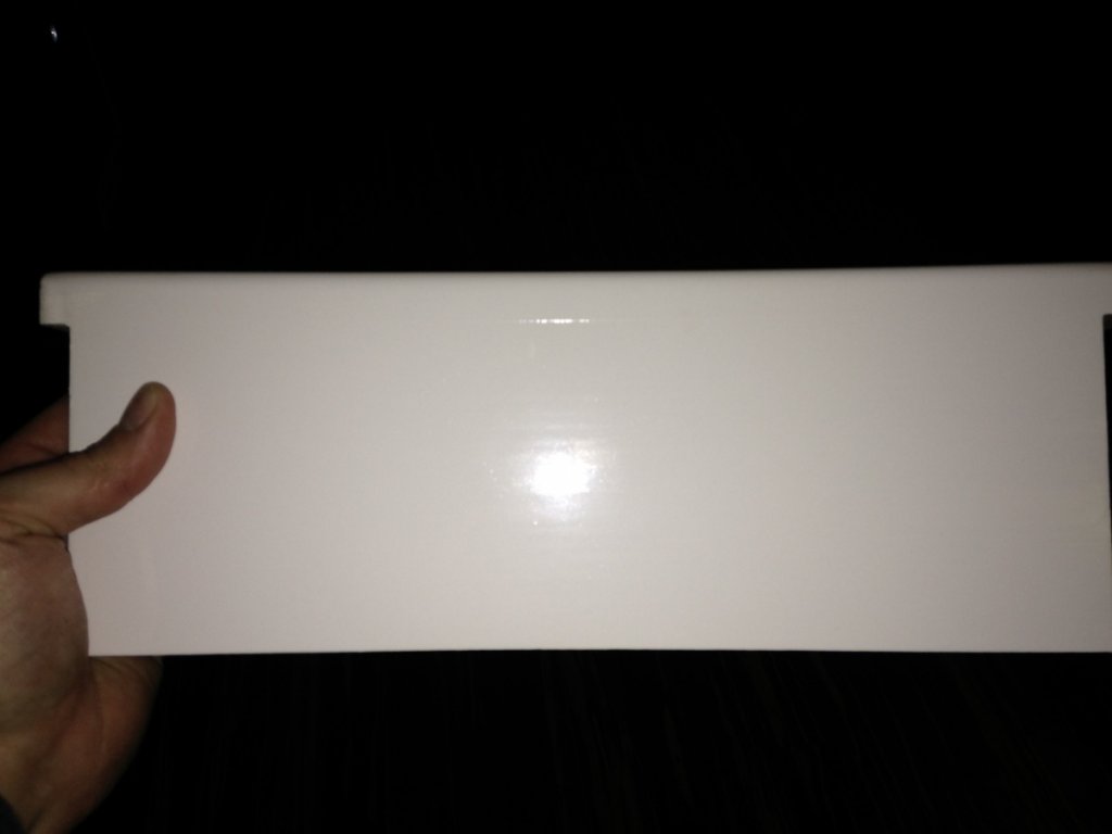

Visited my local proprietor of fine paints today and he recommended this product.  Anyone used this before?
Apparently it has high solids and builds well, flows well, dries hard, and is very clear.
I'll try a sample piece of birch tonight.
I've used graham paints in the past and they are great.

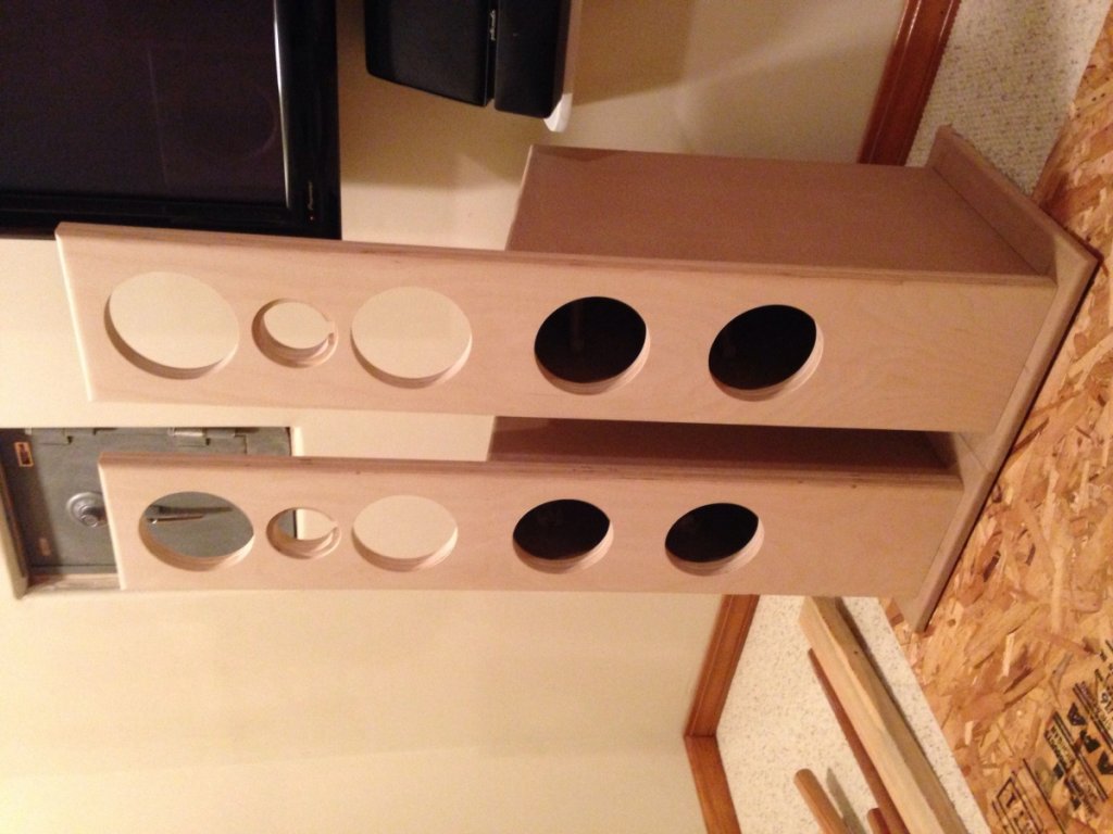

Lots of sanding lately, and now I'm ready to paint.  Probably won't begin until next weekend.  Here is everything dry fit and prepped.
mlundy57
  • Posts: 3643
Re: x-statik build
« Reply #36 on: 11 Jan 2014, 03:26 am »
Looks good. Getting closer to the fun  :green:
Mike

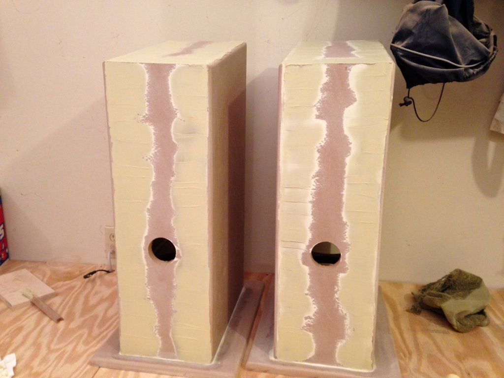

Question for the group:
I made a test piece of MDF with a butt joint and roundover.  Painted it.
I'm pretty happy with the finish; however the joint became clearly visible after a couple days.
I used campbell clawlock primer, which is a high solids / high build product.  I was hoping that would be enough after two coats to smooth over the joints.  Apparently not.
The question is am I on the right track now?  I hoping if I feather this out the joints will disappear under the clawlock and my topcoat(s).
Thanks all
For the benefit of all, this Graham Ceramithane is a fantastic product.  It completely filled the end grain on the birch after two coats, no primer or sealer needed.  It brushes on really well leaving no brushstrokes.  Highly recommended.  A little pricey at $25 per quart, but no need to buy anything else such as sanding sealer so you save there.  They offer it in a gloss and matte finish.
