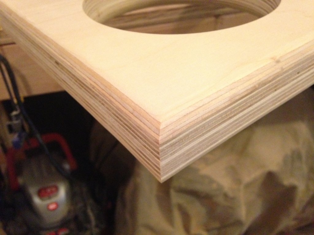

Hello all
This is my first speaker build, so I'm looking for any advice you may have to offer; especially related to finishing.
Right now, I have both speaker boxes built and the front baffles are completed.  I'm working on finishing them next, but not sure what products to use yet.
The boxes and bases are made of MDF; I would like them to be finished gloss white.
The baffles are made of baltic birch and I would like to keep them natural.
Any suggestions on finishing would be greatly appreciated.  I have done some sample pieces with various products, but nothing that I'm really happy with yet.
I tried 2 different types of gloss white paint and it has become evident that the only way i'm going to get it perfect is to spray it in a dust free environment.   That will be difficult for me, but it may come down to that.  Even brushing with products that are supposedly "free of brushstrokes" like Glidden Gel Door and Trim Paint yielded only marginal results.  Glossy and smooth, yes.  Perfect, no.
I tried Minwax polycrylic on a scrap piece of Birch.  It was OK, but I'm looking for something that will smooth out more.  Also, not sure if I should use some kind of grain filler first.
I was able to get everything cut from (1) 4x8 sheet of MDF, and (1) 5x5 sheet of baltic birch.
The baffles are (2) 3/4" pieces laminated together with tightbond II.
Here are some photos of my progress:

Front baffle looks wide.
Be sure to put a large radius on the back side of the woofer holes.
Finishing can be tricky. You can always hit the box with bed liner spray then veneer the front baffle only. If you round the outside front edges then you can roll a paper backer veneer all the way across the front and around the edges.

I used a 1/2" radius on the upper and 3/8" on the lower woofer holes.
I purchased the birch with the intention of keeping it natural.  I need advice on getting a smooth finish with a water based product, as typically oil will yellow over time.
Brush, spray or wipe?
Sand between coats?
Use sanding sealer before?
Thanks

That will work.
I have used brush on polyurethane several times with good results. Apply with foam brush, let dry, then wet sand it down. And you can lay it down over most oils if it is an oil based polyurethane

So how wide is that front baffle?

Just a thought, but if you have one,  I'd use a  3/4" or even 1"  roundover for the back of the woofer holes  on  that 1.5" thick front baffle.  I think generally  the thicker the baffle,  the larger the roundover

Captainhemo - The 3/4" radius bit was pricey and I don't think my router has the guts to get it done so I stuck with 1/2".
Danny - I will confess that despite your advice via email, I made the front baffle 9" wide to allow a 1/4" radius on each side of the back.  This is mainly because of my lack of ability to build a perfectly square box.  It's close, but not perfect.  Perhaps the X-statik was a bit ambitious for my first woodworking project.  If you think that .25" on each side will make a big difference, I may reconsider.
Funny how just an additional 1/4" to each side made it look so much wider. Put a big radius on it and then it will be okay.

No progress recently, but here are some more photos of the birch baffles, sanded and routed / rounded.

How did you cut the notch for the tweeter terminals so cleanly?
Mike
HA! Funny that you ask that.  Well let me tell you, it was not clean like that after the first pass.  It was very much trial and error.
I started with my jig saw with straight cut attachment.  That was fine for cutting directly into the wood on both sides.  Then came the task of cutting out the bottom of the notch.  I figured I would just cut at an angle from each side, and then cut the bottom off clean right between my two vertical cuts  with a straight edge clamped to the baffle.  The results were not so great, I failed to realize that the blade was bending until after I completed the cut.  So, cleaning up the mess basically involved some very careful sanding with a 90 degree block and a builder's square until it was clean  and square.  Actually turned out great, but I managed to do it the caveman way, as usual.
On that same note, that recessed tweeter area is tricky.  You certainly don't want it too big (diameter), but obviously too small and it won't fit.  I ended up being way too conservative on the first one, which lead to probably 4 hours of very careful sanding before it fit.  Once you cut out the circle, I don't believe there is any way to increase the diameter evenly with a router.  A spindle sander would have been useful, but again, one little slip up with a power tool and you've messed up the whole thing.
