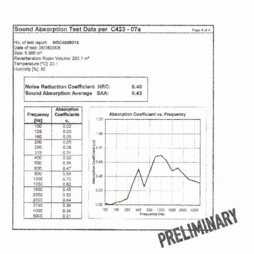

I too noticed this product.  At the time I sent an email to the manufacturer and low and behold they actually had some test data.  while it does not really tell the full diffusion story, it is interesting that they at least tested the product.  see attached.
