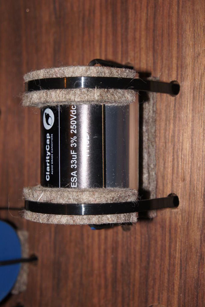

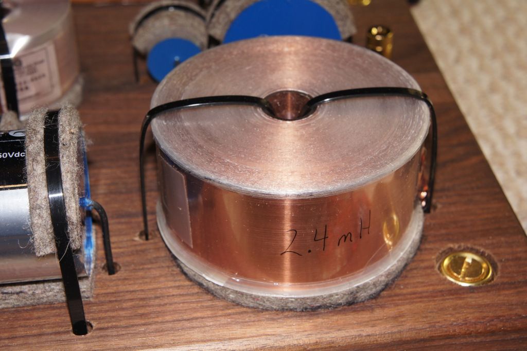

Just built these for a friend. He really likes his ESS speakers!

Pretty, and nice components.  Move that middle coil so that the magnetic fields don't interact and you've got a winner.

As above, spread the inductors as far apart as is practical and each inductor's axis should point a different direction.
1] east-west
2] north-south
3] up-down

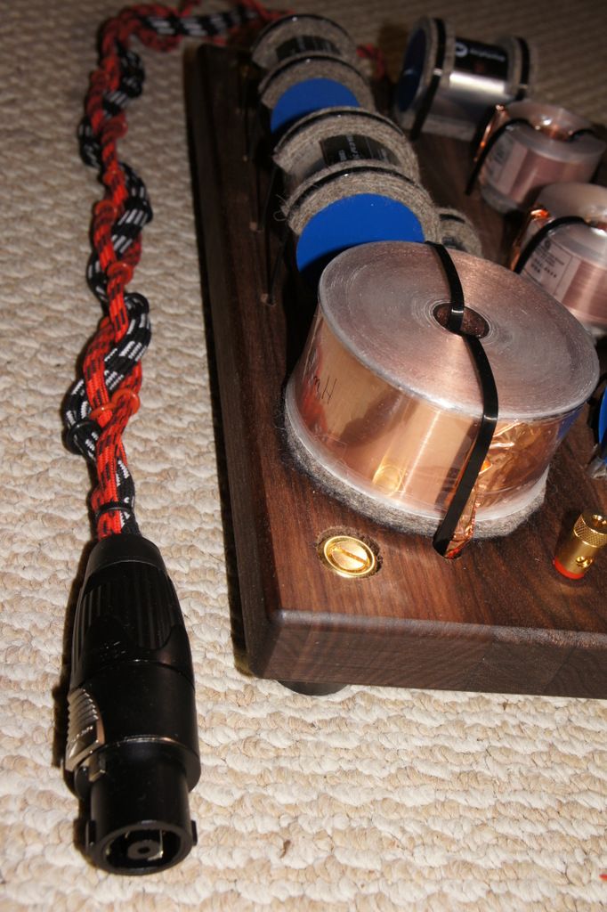

How did you wire them up? Looks like it's all wired underneath with feet lifting the board off the floor?

Thanks for the advise S Clark, don't know how I overlooked that...  :oops:   Luckily it's just a small adjustment.
sebrof, yup... the boards are Amish cutting boards from ebay, the wiring is under the boards and the boards sit on rubber feet. Fairly simple, but it did take a bit of labor.

I've never seen felt isolating components. That for vibration I suppose?
DaveC113
  • Industry Contributor
  • Posts: 4397
  • ZenWaveAudio.com
Re: Custom Crossovers For ESS Heil AMT 3
« Reply #7 on: 10 Dec 2013, 08:21 pm »
Thanks Bob, yes the felt is for mechanical isolation.  :thumb:
