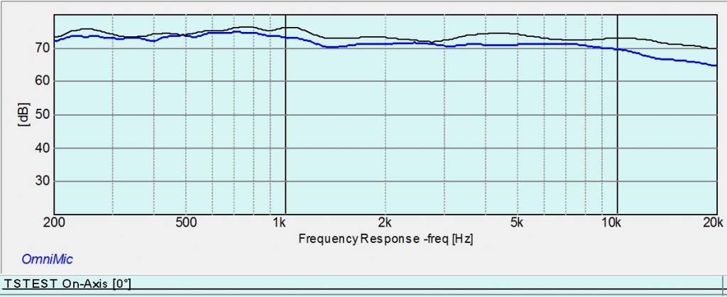

Here are a few graphs...
On-axis (black) versus 30 degrees off-axis / horizontally (blue).

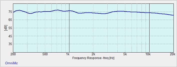

Here's a curve I just shot on-axis with a 5db scale and the microphone placed a little lower and closer in to the speaker. Hmm... saved as a 10db scale - let me see my software settings.

The initial curves were about .7M distance with the mic centered on the middle of the tweeter. The last curve was at .5M and the microphone height at the point where the driver frames meet. As you can see the response is very linear regardless what the scale is. I typically measure with a 10db scale not to make the curves look nicer but for easier comparison with my crossover software. The greater scale allows me a better picture of driver rolloffs and breakups during the crossover design phase.

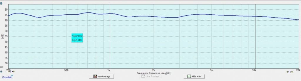

How about changing the "Y" axis to 5dB scaling?
Here's a print screen capture with 5db scaling.

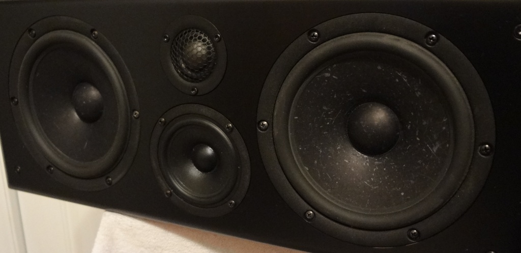

« Reply #36 on: 4 Feb 2014, 11:22 pm »
Here's a Satori center channel that I'm working on...

« Reply #37 on: 8 Feb 2014, 05:56 am »
What's the mid and tweeter
Scan-Speak mid and tweeter.
