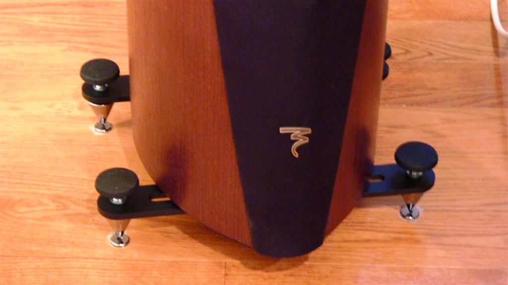

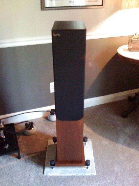

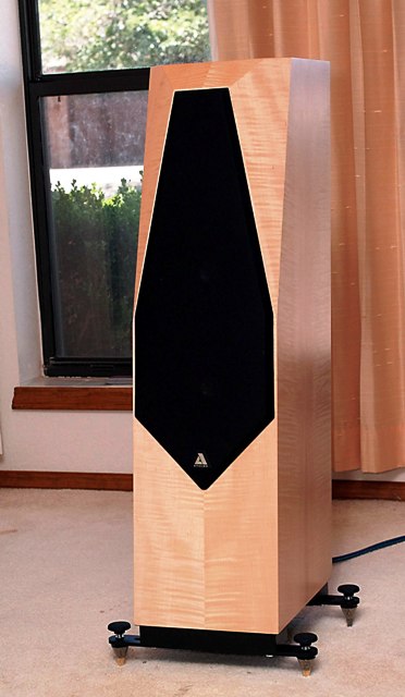

Think Danny will say  the bases are   for stability.  I believe many  of the plans say you can adjust the thickeness to change the final height .  Plus the N3 cabinets already have the double plate in the bottom  so  they are  1.5"  thick without  the base.
Lots of people  like and use the  dark bases,   here is  a thread  with  Ron's AV3 TL's
http://www.audiocircle.com/index.php?topic=106713.0
On Danny's website if yo look at the  OB5's,  there are some pics with  dark/black bases too
I'm  probably  the  "odd one"  suggesting  using a color similar to the cabinets   :dunno:

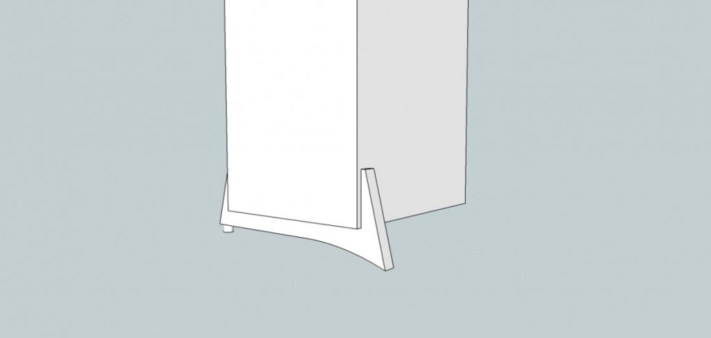

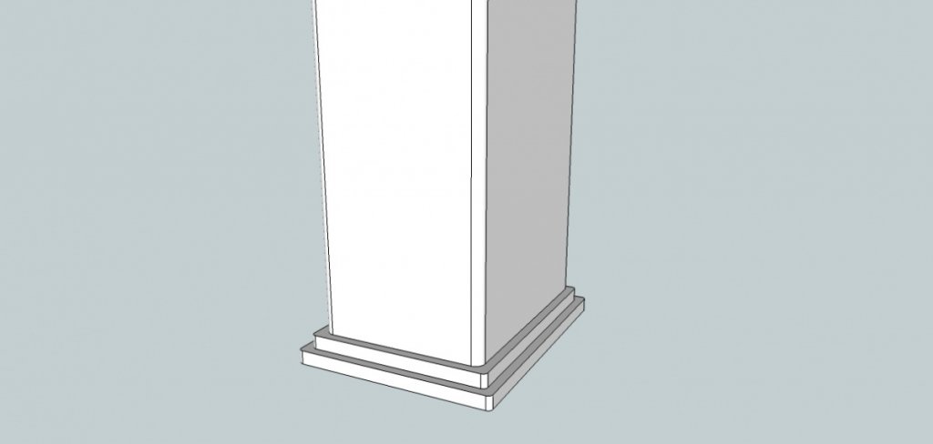

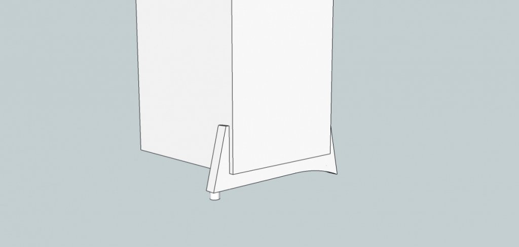

I've only seen a few plinths that look integrated to my eye, most look kinda awkward, but perhaps necessary for stability. You could do something like the Soundocitys, but use wood as someone suggested.
Here's some other ideas that may provide some spark.
Edited to add: They are meant to be two ideas, just convenient to put them in same drawing

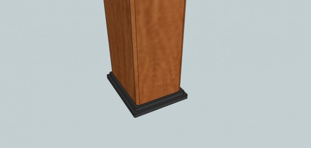

I tried cutting my stands down. Same design but with a much smaller footprint. They looked a lot better however, when I bolted the base on the cabinet ended up being angled on the base instead of straight.
If I go with the outriggers without a base the tweeters are going to be 3" below ear height. I can compensate for that some by putting 2" spikes in the front and 1.5" spikes in the rear. If I understand the math correctly this would result in about a 3 degree leanback. The listening position is about 10ft away from the speakers. I don't know if that 3 degree of tilt would make up for the 3" in height at 10ft or not.  Another point that may be an issue is that the front and rear spikes would be 8" apart. Don't know if that is wide enough for stability or not.
If I add a minimalist hardwood base I could make up 1.5" of the height difference and spread the floor spikes 3" farther apart (11" instead of 8"). The tweeters would still be 1.5" below ear level but I could still get the same 3 degree of leanback by using the two different size spikes.
My problem now becomes drilling the mounting holes in the new bases so that they line up with the threaded inserts in the bottom of the cabinets and have the cabinets sitting straight on the base. Any ideas on how to do this?
Mike

Here is what one of the bases looked like after cutting it down.
As you can see, it is a bit off center and I am still not sure it looks all that good. So I bought a 1" x 12" x 48" piece of Bubinga
I plan on making a simple platform with either a 3/8" roundover or chamfer along the top edge and a very slight roundover on the vertical edges. At 12" wide this piece is narrower than the 14" width called for in the plans so I will probably still need to use the outriggers for stability.  I will need to make some samples to determine what color shellack I want to use on the Bubinga. I'm thinking either amber or garnet.
Mike

Thanks for the drawings. I like the look of the two tiered plinth. I'm a little concerned about using MDF for the plinth. It seems to be a little fragile, easy to chip or break and these stands will get run into at least by a vacuum cleaner from time to time.  If I used MDF I'd have to make it a lot tougher.
That's why I liked the idea of Baltic Birch or hardwood for the plinth. The problem I had with the hardwood is that my local source only had two options 12" wide or wider, bubinga or purpleheart. I would have liked to use Wenge but they didn't have anything wider than 10". While I could probably set up my router table to do a decent enough job of jointing to glue two narrower boards together, I don't have any way to plane a wide board down. Also, if I could plane it down it would be less than 1" thick.
Which wouldn't really be an issue with a two tiered plinth. I wonder if I could pull that glue up off. How much of an exposed lip is showing for each level in your drawing? The more I think about this the more I like it.

Mike, I drew that with 1/2" steps. You're right, MDF edges don't hold up all that well to abuse, but you can toughen 'em up some by saturating with epoxy, perhaps thinned a little with alcohol. Not looking to finish with the epoxy so much as consolidate the core of the MDF.
Take a little paint thinner and wipe on the surfaces of the wood to get a little preview of what it'll look like finished. I would think bubinga would trend towards red pretty significantly, but proof's in the eyeballing.
 If you end up using that wide board, you've got to give it some way to move around...trust me on this, solid wood moves...a lot. Especially across grain.  You could use clearance holes with washers.

Working on some MDF mock ups based on Peter's two tier plinth.
If I decide to go the MDF/epoxy route would you recommend:
1: epoxy each piece individually then laminate them together
2: laminate the pieces together first than epoxy a single, though more complex, unit or
3: epoxy each piece separately and attach them to the cabinets separately  (each bolt goes through both pieces but they are not laminated together).
Mike
