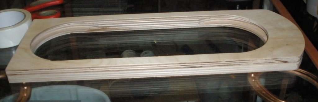

I first started working on the grills. I used 1/2" Baltic Birch plywood. Since the N3 uses two M130 drivers I cut two circles with a 6.375" outer diameter, a 0.250” deep recess and a 5.5” through hole with the same center spacing as the front baffle. It took 2 passes at the 0.250” depth with a ½” bit to clean out the rabbit between the 6.375” outer diameter and the 5.5” through hole.
I added an additional 2" to the outer radius of the bottom cutout and used the router to cut a smooth curve on the bottom of the grills.
Then I finished cutting the through holes.
Next I used the table saw to remove the waste
Then I used some double stick carpet tape to put the two grills together. This way I was able to sand both grill frames evenly on the spindle sander and it made putting the 3/8" roundover on the flat sections easier.
Next I clamped the grill frames on the cabinets and drilled pilot holes through the frames and into the cabinets to mark where the neo magnets would go.
Next I cut the recesses for the magnets using Forstner bits. I used the drill press for the frames and a drill guide for the cabinets.
Then I stained the grill frames and epoxied in the magnets
I have covered one of the grill frames with cloth and have one yet to go. Any ideas on how to smooth the cloth out without having multiple layers of it build up, especially near the magnets?
Mike
Danny Richie
Re: N3TL Build and Questions - Update and new pictures
« Reply #44 on: 30 Dec 2013, 09:39 pm »
Looks good.
Be sure to round over the inside edge on the front side.
mlundy57
  • Posts: 3643
« Reply #45 on: 30 Dec 2013, 09:43 pm »
Thanks Danny,
The roundover on the inside edge is there but you can't see it in the last picture because the grill frame is actually upside down. The part you are looking at sits flat against the cabinet then transitions into a 3/8" roundover the full length of the long straight edges.
Mike
Danny Richie
« Reply #46 on: 30 Dec 2013, 09:47 pm »
Thanks Danny,
Mike
Perfect.
