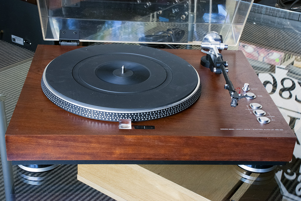

I am not sure what arm is on it, here is a pic of the MS

That arm is a Micro Seiki CF-1 or 2.  I had one on my DDX-1000
Could also be a 707 arm, have one on my DQ-3. There is a rare extra weight that threads into a hollow at the rear of the arm for medium compliance carts.
