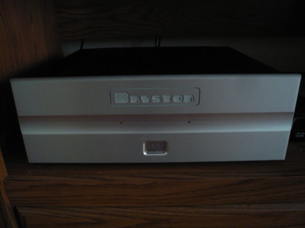

What does it mean ?
23 db ?
29 db ?
When to use ? why ?
My speakers are Focus Audio FS-788  They never go below 10 ohms
Is this amp overkill for my speakers

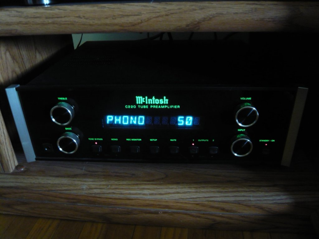

Preamp is a McIntosh C220

 To better match your input to your preamp. :scratch: I think James said awhile back that one setting will make the power amp sound more forward in presentation ( which I prefer). I could be totally wrong but that's what my understanding is. :thumb:

Is this enough power for my speakers
Should it be 23 or 29

If you have too much overall gain in your system (gain of preamp plus gain of power amp) you may have a small volume control range making it difficult to adjust volume (for example you are at 9:00 at desired maximum volume).  If that's the case you can reduce the gain to 23dB to get more volume control travel making fine adjustments easier.
The sensitivity of your speakers is a lowish 86dB, so depending on your listening volume, room size and distance from the speakers, I think the 4BSST2 is a good match with plenty of headroom for peaks.

The mcintosh c220 allows for gain adjustment making the bryston gain choice moot
