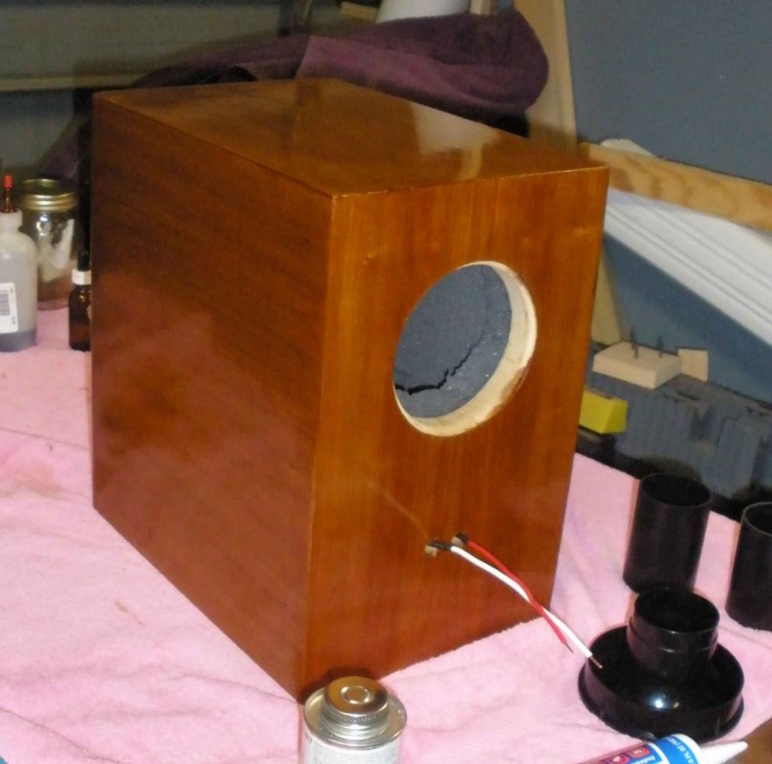

Once the boxes were glued up (OK quite awhile after the boxes were glued up since I stopped to build the X-LS & X-CS Encores) it was time to finish the cabinets. I decided to try veneer and settled for a cherry veneer with a PSA (peel & Stick) backing.
I started by laying out the veneer
A lesson learned here. Unroll the entire veneer sheet and look at the grain patterns before cutting anything. That way you can use the most interesting patterns where they will be seen the most. I didn't do this and ended up with one speaker with a lot of interesting grain patterns and one that was relatively plain.  Once you know how you want to use the veneer you have to cut it to size. I used a very sharp carving knife.
Once the pieces are cut it is time to start applying the veneer.
Getting the veneer to lay smoothly over the rounded edges required a little help from some veneer tamer
More to come
Mike

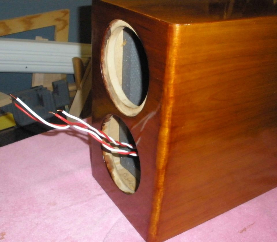

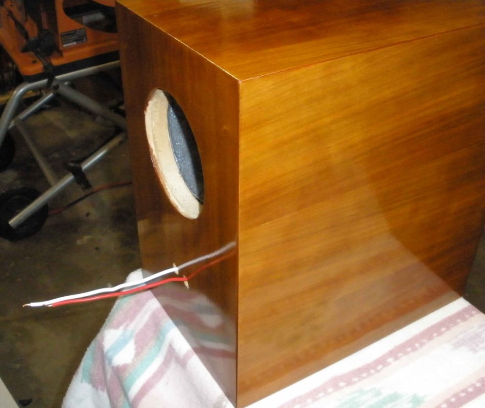

When I applied the veneer I wrapped a single piece down one side, around the front and down the other side. Then I added a separate piece to the back and used a hole saw to to make the initial cuts in the driver and port openings. The piece of veneer by the side is for the top.
then I applied veneer to the tops and bottoms
Then I trimmed the edges
After that I used a flush trim bit in the router to open up the woofer holes and the through hole portion of the tweeter and port holes. I then used scissors, a sharp knife, and sandpaper to finish trimming the veneer to the edge of the recess openings. I used a Forstner bit for the tube connector openings.
Next up ... finishing
Mike

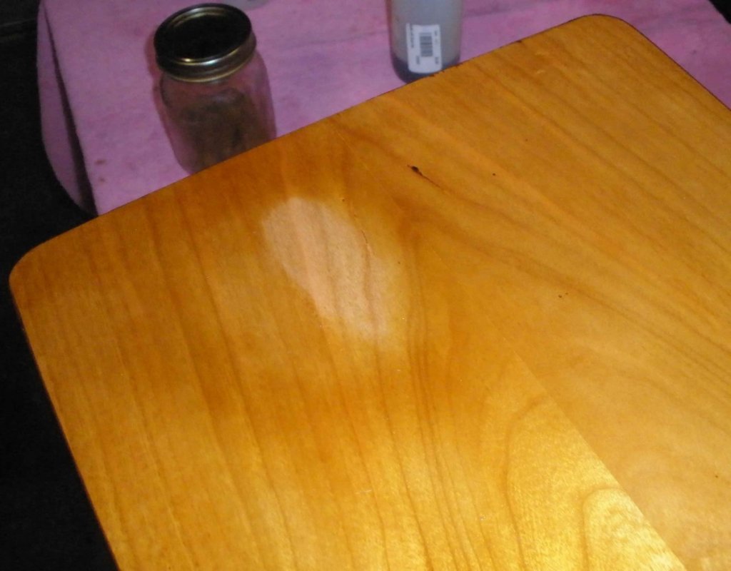

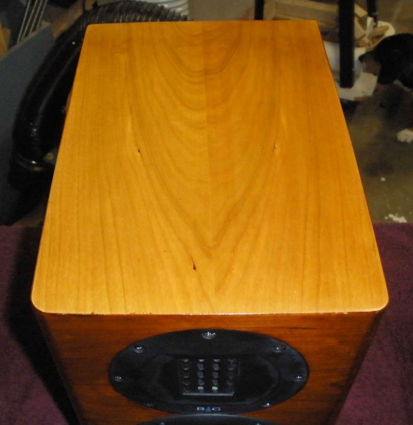

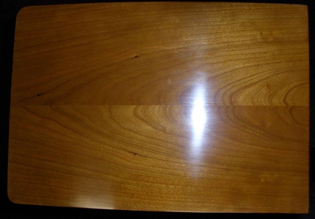

Here are some pics of the finishing process:
Here are a couple of pics of the problem spot I mentioned earlier
I was not able to repair the spot to my satisfaction so I took the top back down to bare wood and started over. I'll post pics of the finished speakers after my camera battery recharges.
Mike

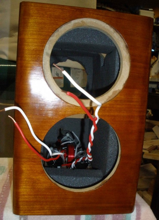

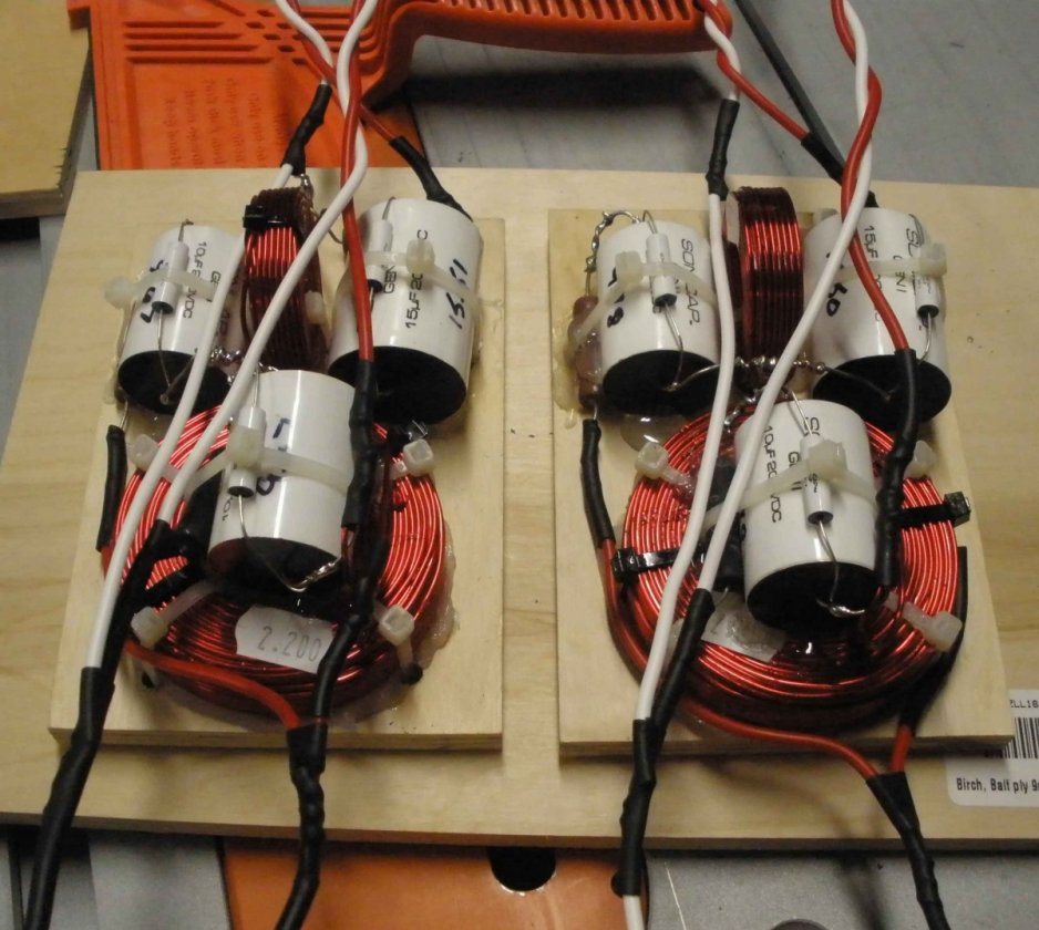

Here are the crossovers
Here are the crossovers installed
Next up will be pics of the finished speakers.
Mike

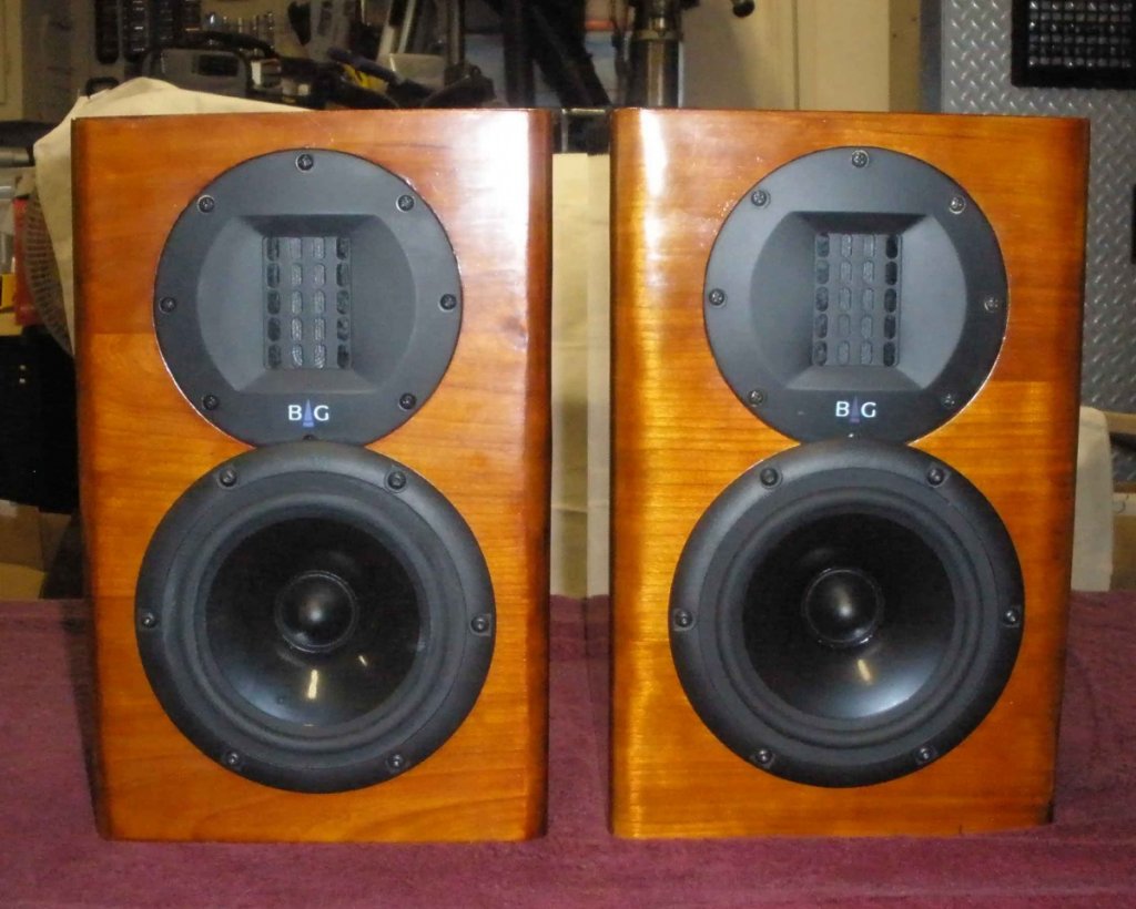

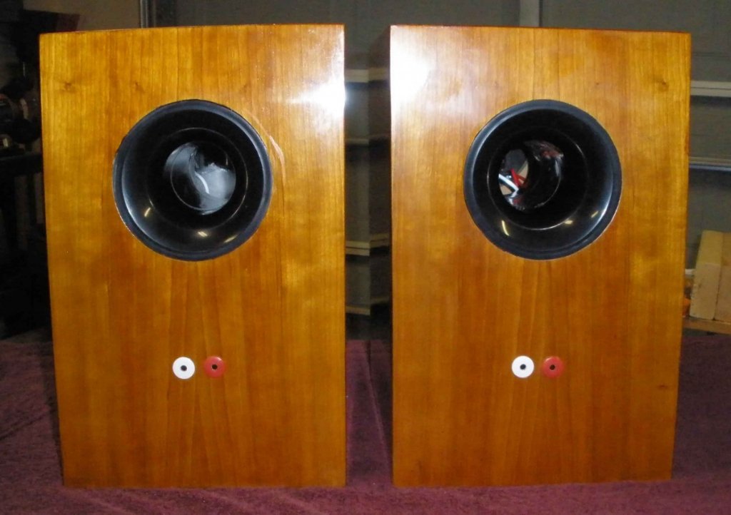

Here's the top with the problem spot after I refinished it
Here are some more finished pics
I haven't made grills for them yet. Not sure that I will. If I decide to make grills the GR Research badge will go on the grills. If not I'll either put the badges on the lower right hand corner of the front or cenetered on the back by the tube connectors.
Mike

Jay,
Thanks.
They have about 40 hours on them at this point. I'm not going to put the platinums in this set. I didn't build the crossovers in such a way that I could make that upgrade very easily. At the very least I'd have to cut the wires to the tube connectors to get the crossover boards out of the cabinet so I could replace the bypass caps. Then I'd have to splice an extra length of wire back to the tube connectors.
I will use platinum caps in the N3TL's and N3S I decided to build for the living room.
Mike
Re: N1X
« Reply #16 on: 15 Oct 2013, 04:38 am »
That is the one drawback  to the tube cnnectors.....  it'd be cool to  have them  so that the connector itself ( the housing  inserted into the cabinet ) was female on each side.  Then  the leads from  the crossovers and the speaker cables would both have the maile ends  that  could basically touch in the middle keeping the  wires as physically close   together as possible still.  Not sure how much of anissue that extra male terminal would be  ?
I think with only  40 hrs on  those,  you will still hear them smoothern out a bit more.   I'd say you may even notice some improvement up to the 100  hour or more  mark  .  With the platinums it's 4 or 5 times  that but worth the wait
-jay

Jay,
Who knows, after I hear the N3TL's with the platinum caps I may decide it would be worth it to upgrade the N1X's. The easiest way would be to replace the tube connectors. That way I wouldn't have to splice the wires. An additional expense yes but if I were spending the money for platinum caps it would be worth it to not add another solder joint into the circuit.
Danny,
Thanks
Mike
