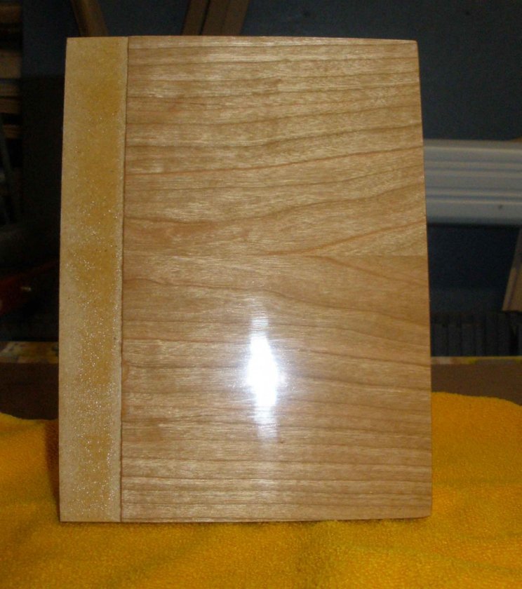

I wasn't totally satisfied with how the finish came out on these cabinets. While I am not going to strip them down and start over, I have taken a scrap piece of the cherry veneer I had left and finished it with the French polishing technique I learned. However, this time I used the lighter amber colored shellack rather than the darker garnet I used on the cabinets.
Here is a picture after I had completed the french polishing technique.
This is the minimum amount of French polishing I would do. Additional rounds of polishing would add more depth to the finish and darken the color some.

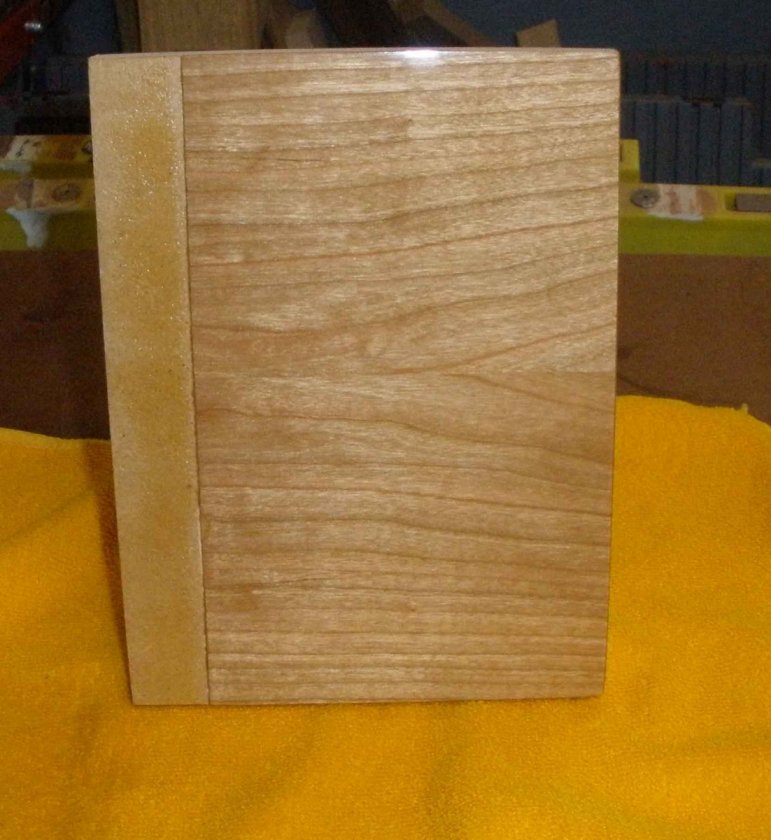

Here is the piece after rubbing it out with swirl remover

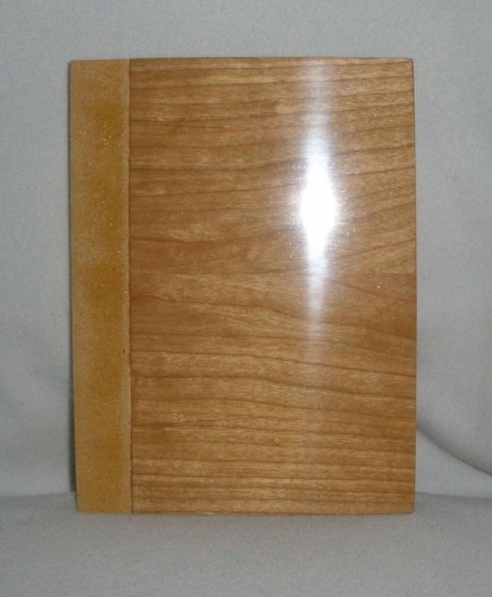

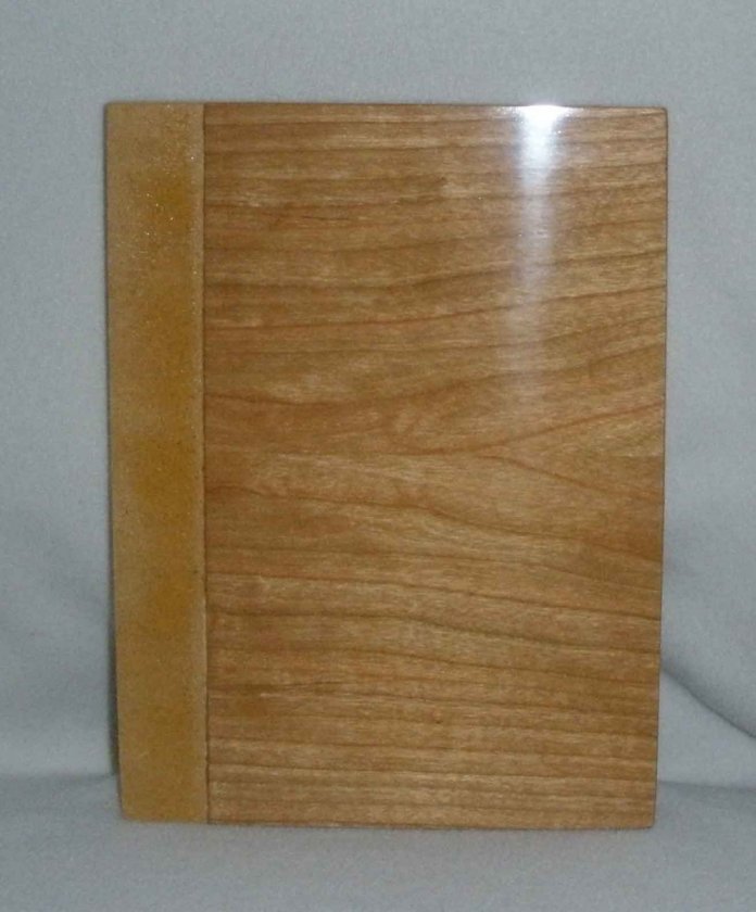

And here is the piece after buffing with paste wax
This is a completely hand rubbed finish using nothing but shellack and alcohol to apply the finish then rubbing out with swirl remover and buffing with paste wax.
Unfortunately photography is not one of my strengths. I can't seem to get a good picture showing the depth and gloss of the finish and keep the flash glare off. While they will give you a good idea, the actual piece looks better than these pictures suggest.
