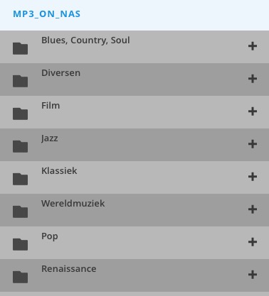

HI Chris,
Any news on the wrong order issue? Still here in the latest beta:
Last item in the list shows up somewhere in the middle. Folder, or track. (unless less than 3 or 4 items, or a numbered list)
Marius

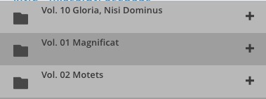

Marius
Re: Manic Moose (S2) - BDP's third major firmware release
« Reply #1806 on: 15 Jun 2016, 07:11 am »
Let me correct that:
Numbered lists are also affected....  :scratch:
