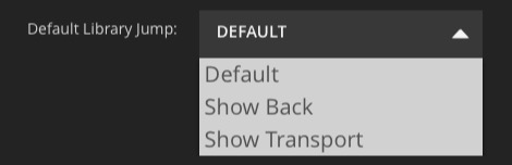

Don't know if this is related to the sorting issue above, but i did change the default library jump settings in Media Player settings. I wouldn't know what this is for, so i thought to try just to see what happens.
Anyone knows what this does? Default, Show Back, Show Transport
