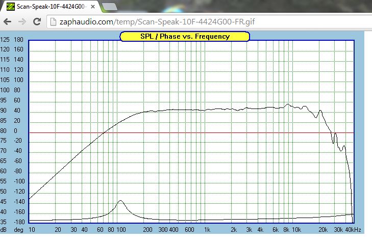

I see only about a 3 dB ripple in the 1k to 10k range for the discovery 10f. That's pretty flat by any standard. It's also supprisingly efficient.

Hi Matevana ~ I was looking at this chart from Madisound, for the Scanspeak Discovery 10F:
Thanks again for pointing out these drivers as possible solutions.

Zaph's testing shows basically a flat line well over six octaves! You're not likely to find that with any dome. The ability to cross to the Eminence lower than intended is also a plus. The peak around 10k is easily dealt with but I would listen to it first. I'm just saying that it would make an interesting option.

Hi Richard,
I have had good luck with the Realistic 40-1310A super horn tweeters. After trying a number of others including Vifa domes and Neo 3's they were the best match for my Eminence Beta 12LTA's.
The Japanese made Realistic 40-1310A is not the same as the Radio Shack 40-1310B ( Korea ) and 40-1310C ( China ) and looks to be the clone of a more expensive Fostex horn tweeter. I don't know it's sensitivity rating but it keeps up with the 97-98 db Betas. I use a single .47uf cap to tone down the sizzle.
I know I sound like a broken record but the Beta 12LTA goes to another level when you cut out the dust cap and add a phase plug. It's proven as enjoyable and more fun than the Tang Band W8-1808's.
-Richard-
  • Posts: 853
Re: Researching the best high-sensitivity 8" driver for OB ~
« Reply #19 on: 7 Sep 2013, 06:17 am »
Hi Poultrygeist ~ I googled the Realistic 40-1310A super horn tweeters and notice that they are no longer made, for sale only on ebay... and the price varies quite a bit. I wonder how you came to use them, or rather how you came to know about them at all?
I have never read anything you have written before this current post about the Beta 12LTA... or about your suggestion to "cut the dust cap and add a phase plug". They are sensitive at 97db... quite nice!! "...more enjoyable and more fun than the Tang Band W8-1808"? Really? That is quite a recommendation given the raves about the Tang Band in OB application!!!
I haven't seen a frequency chart for it yet... there are 15 reviews for it on Parts Express, most of them are from guitarists using it as a guitar speaker, one person for stage sound.
Where did you get the phase plug, from planet 10? or did you make your own? I must still have the pair of phase plugs Dave made for me from Planet 10 for my pair of Visaton B200 drivers.
I have been having an itch to try the B200's again in my simple flat OB's. Now that I have been listening to the Dayton Neo's for several months I am curious what the B200's actually sound like with my present set up: iPad mini connected to the TBI version 3. Simple. The amazing thing is how very good the Daytons sound without a DAC, when the music I stream from Internet radio stations on the iPad mini stations is broadcast in a hi-res format. Quite startlingly good.
The suggestion here is that you could buy incredibly expensive appliances, like DAC's (I am not using one yet) but when the streaming music is of a hi-rez quality, the sound in OB is sensational. And all of this on-the-cheap!
Can it sound better? Yes... there is enormous room for hi-end appliances to bring out the qualities that we love (if not actually crave) in our home music experiences. But at a cost that for me does not seem attractive. I am not in love with appliances anymore... although I do love well designed audio products. And given an open-ended budget, who wouldn't want to have pricey beautifully designed audio products pulling out the last drop of magic from ones beloved music?
I find your suggestion of the Beta 12LTA quite intriguing, Poutrygeist!!! and at $80 each, if they are as good as you suggest, it would be a steal!!! This may be just what I am looking for... a gem of a driver hiding in the shadows because they do not have the pedigree or 'branding' that the expensive products enjoy.
I still favor a full or wide-range driver that does not need a tweeter... with a well-designed Alnico magnet... I am certain they can bring that smoothness (if not actual warmth) they are known for to the all-over musical presentation.
Thanks for the very positive suggestion.
With Warmest Regards ~ Richard
