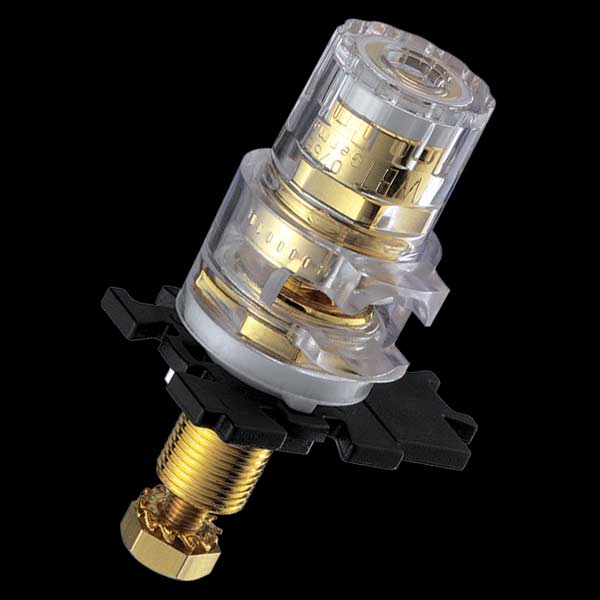

George Cardas,   "CPBP" (Cardas Patented Binding Post)  These have been around for a very long time.  I think the design is too "radical" for most audio consuming folks.
http://www.cardas.com/cpbp.php

The primary danger of a short comes from the spacing of the binding posts. They are set up to take a Pomona dual banana plug.
 This 0.75inch spacing makes short circuits more likely with some types of binding post designs and speaker cable terminations.
A slightly less well designed binding post than the BFA/Z can be had from ebay for about $7.50 a piece.
It seems like one of the cheapest things that could be done to lessen the likelihood of a short is to increase the distance between the binding posts.
CMC 858-S-R binding post
For what it's worth the the Vampire #CM2F/CB RCA jack makes ground contact before hot. There may be other RCA jacks that do this, but that would have be confirmed via an Ohm meter.
