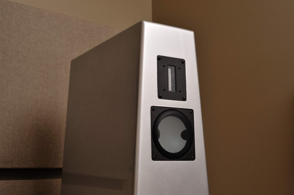

Hi. Here are a few pics of my speakers complete and in their new room.
In their finalized position. Ignore that the television looks so small- just the nature of using the wide angle lens.
Full view of the right speaker.
Close up of the upper section of one speaker.

Those look fantastic!  Now, let's talk about some panels at the first reflection points along the side walls...I want you to get the best clarity out of those beautiful speakers you've got there!

Great pics! I'll soon be adding them plus measurement graphs and specifications to my site.
