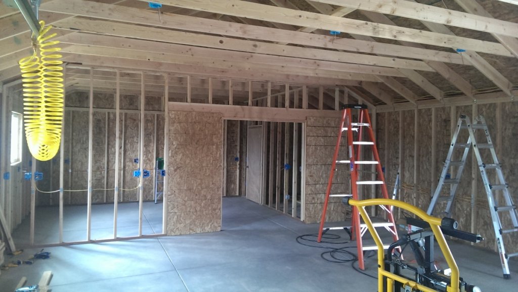

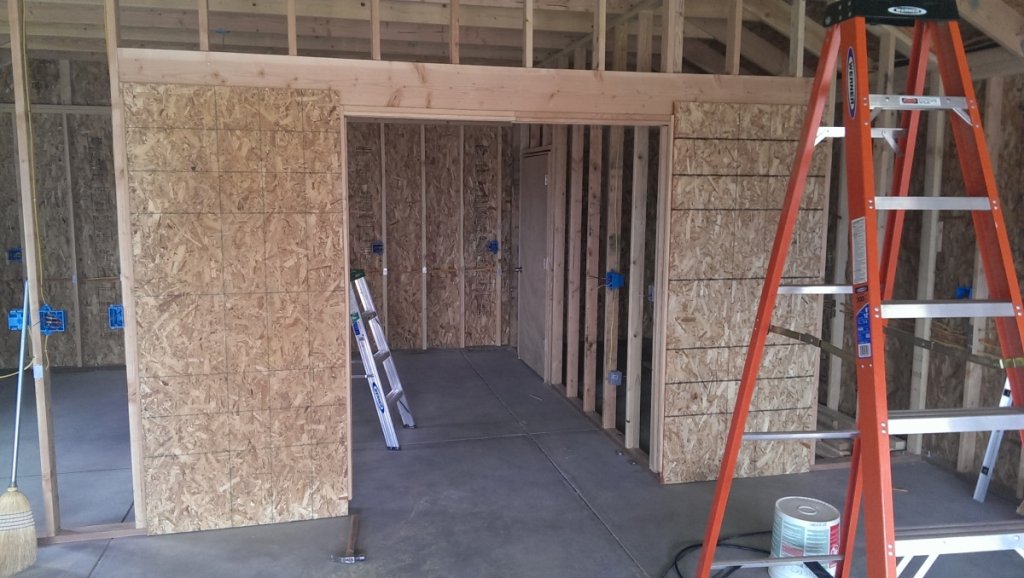

It's been a while since I've updated this but progress has been made. All the interior framing is done and I've finished all the electrical, inspection scheduled for tomorrow morning. I got the pocket doors in today, yes I used Johnson hardware. :-). I didn't opt for solid core doors as they won't get a lot of use and I'm really not worried about it. As you can see there is a large gap under the doors. This is because I extended the wall footer to the end of the door. Since there are no adjoining walls I used OSB to provide some support for the doors and having the footer provided an attachment point. I'm actually quite happy with how solid the wall turned out by the doors. Not looking for airtight, just something to keep the majority of dust out of the machine area.
Assuming the electrical inspection goes well tomorrow, I can start insulating and get the drywall in. Still need to add some roof vents before drywall but that shouldn't be too bad.

« Reply #26 on: 5 Aug 2013, 01:07 am »
That'll work, looking great!  :thumb:
Is is common there to have the slab sectioned off like that? I've never seen that before.
It also looks like you'll have some extra room for storage space in the trusses.
Maybe enough room to walk in?

mgalusha
Re: New Shop/Garage Project
« Reply #27 on: 5 Aug 2013, 01:21 am »
Bob,
The slab has the gaps for expansion, our soil tends to move quite a bit. The foundation of the house is the same way. If I were a little person I might be able to walk on the joists but it's perhaps 5ft to the peak, maybe a bit less, so not a lot of storage up there but some is usable. I know how you like storage. :)
