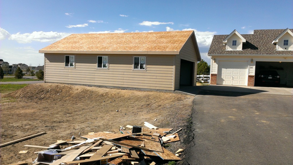

4/10/2013 - The first of 12 loads of fill dirt arrives.
4/11/2013 - All the dirt has arrived and they have the forms ready for the concrete pour. Yes, this is Colorado, the snow from the previous day is all gone. :)
4/12/2013 - We have a slab!

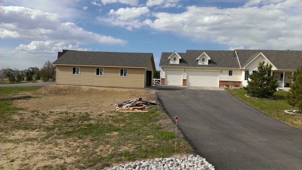

5/15/2013 - A month goes by, the concrete is nicely cured, the inspector has had a look and presto, we have most of a building.
5/16/2013 - We have a building, at least mostly. :)
5/17/2013 - We have a roof! They installed the gutters the next day on 5/18 and the roll up door on 5/20.

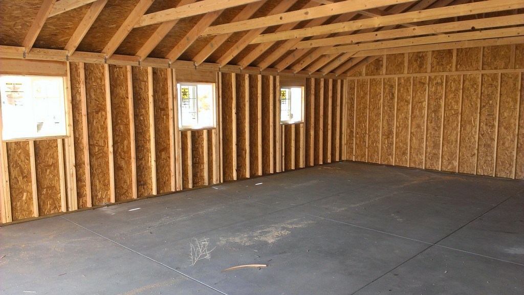

The building is 24' x 36' and the main ceiling is about 10'. I have some epoxy coating ordered for the floor and plan on putting in a couple of partition walls. This will keep dust away from the metal working gear and put the noisy stuff like the compressor and dust collector in their own space.

Interesting  to see how things are built in different parts of the country. No thickened edge slabs on residential buildings here and more than likely you'd see trusses instead of a hand stacked roof. The slab would be one piece with saw cuts for control joints. Looks well constructed.

I'm south east of Denver, CO. No question the local codes come into play. I was surprised by the built in place roof, the existing house and garage uses prefab trusses from 2x4. The upside of the way they built it is they are 2x10, so should be plenty strong, at least I hope so. It was going to be a standard 20 x 30 three car garage size but I really wanted to separate the lathe and mill from the dust and it was about 15% more money to add 4ft to the width and 6ft to the length which increased the floor space by about 30% and I think that will help keep it from shrinking for a little while. I have a electronics space in the basement, so at least that won't migrate into the new space.

The plan is to put a 100A sub panel in. I want at least 4 240V circuits and lots of 120V 4-plex outlets along the walls. The dust collector, table saw, band saw and compressor all need 240V. If funds ever allow I'd like a bigger lathe and mill, so those too would need 240V, so having a panel with enough capacity is mandatory.
I'm hoping to use a pellet stove for heat for a couple of reasons. One is we have one in the house and typically buy two tons of pellets every year, so that makes for an easy install and fuel delivery. Two is related to one in regards to fuel. We're rural and have propane, the cost of running propane to the new building would likely be pretty steep and electric heat would also likely be quite costly. I can get a used pellet stove for around $1K and on high that will heat the space up easily.

Mike, are the ceiling joists 32" on center?  On spans as wide as your shop we always built "hog's troughs". That would be a 2x6 nailed flat across the center of the joists and then another 2x6 placed on edge and nailed to the flat one ("L" shape in cross section). That tied all of the joists together and prevented sag. Might not matter if you are not finishing off the ceiling.  I see a board in the pictures but I can't tell if it is nailed to the joists or rafters.

Do you have some sort of a vent for the roof?
I can't tell from the pictures but you'll end up with shingle problems if you don't have a way to let the heat out up there.

Not yet but it will. Local code doesn't require them on detached garages but I plan on adding a couple.
