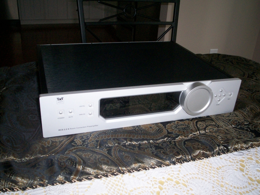

Is there any hope for improving things with my limited options?
Yes purchase this.
TacT 2.2X.

Re: Is there any hope for improving this room?
« Reply #18 on: 25 Apr 2013, 01:27 am »
Yes purchase this.
TacT 2.2X.
Can one still recommend TacT? I have only heard bad sentiment recently about their company and level of customer service...?
