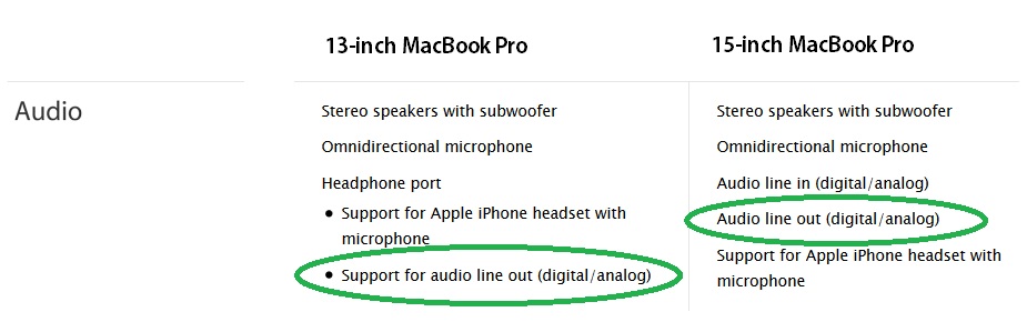

From looking at this it seems like USB DAC is the only option. Anyone have any experience DAC for this computer?
srb
Re: DAC for Mac Book
« Reply #1 on: 14 Mar 2013, 03:59 pm »
The audio line out jack is a combination analog output / optical S/PDIF digital output (Mini TOSLINK), so a DAC with an optical input is also an option.
The question of which DAC to use will vary widely.  Generally the optical is limited to 24/96 resolution, so if you want higher resolution capability up to 24/192 you should probably get a USB DAC (that has an input capable of that resolution).
If you state your budget, you will get many recommendations.

This thread has me a bit confused. My previous assumptions were that both USB and Toslink outputs on the MBP (mine is 2010 15") are capable of 24 bit/X (forget the details) throughput, but your DAC must be capable of decoding such.
Also, per your screenshot, Steve, any idea what 'support for lin out (audio/digital)' means? (Just curious)
« Reply #8 on: 14 Mar 2013, 06:09 pm »
USB should be able to go 24/192 if your DAC can handle it.
« Reply #9 on: 14 Mar 2013, 06:12 pm »
Appears to just be written differently. Should still have the ability to plug in both types.
