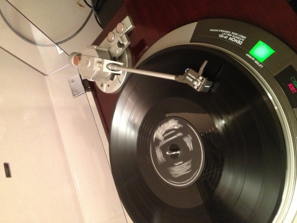

Jack and all I put a small lead weight of unknown grams on the head shell and a penny close to the counterweight and I am relistening to albums I listened to last night and some old favorites. I hear much fuller highs like cymbals and that lovely crispness in the saxophone and snare drums. It will drive me nuts looking at the weight and penny though.

If you want to stick to that combo, then find one of the Shure or Technics weights that go between the headshell and cartridge that you won't see and see if that works.  They are usually about 2.5 grams.  Otherwise if you like that Denon sound and are already setup for LOMC the look at the Denon 301 MK II.

A penny weighs 3g.  I don't have an easy solution for the counterweight, at least one that might look acceptable.  Maybe you could get a big washer with a hole big enough to fit behind your counterweight. You'd probably have to machine it or grind it down, it would be too heavy, but that would make it small enough so you wouldn't see it. You could probably find something else like a lamp part or something in a hardware store.  Whatever, fix it to the counterweight or back of the arm so it doesn't move around.  You could even use some of that modeling clay, but the look might drive you crazy.
Eff mass is actually increased by having the counterweight further back and a lighter weight.  The problem with this is less responsive pivot and back of arm performance. It seems like convoluted physics, but every time I've messed like this with arms, it seems like it works out better if the weight is added to the headshell where it directly adds to eff mass, and the counterweight is kept reasonably close to the pivot/bearing.  Unfortunately, according to the 103 crowd, 20 to 25g eff mass is optimal for a stock cart. You'll have to experiment.

Results as pictured above have been very favorable. More detail for sure and loads more bass. This all in recordings I know very well. Let me see if I am starting to unravel this. The reason for weighting the tonearm is because the cantilever on a dl103 is stiffer and therefore a lighter eff mass arm the whole arm moves laterally instead of the cantilever?
I don't know the mass of my lead weight so I may order the screws and possibly machine some counterweights. I have access to a mill and materials.
