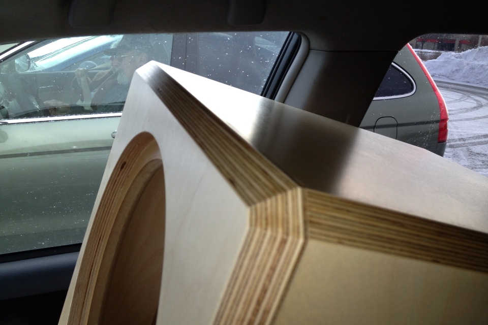

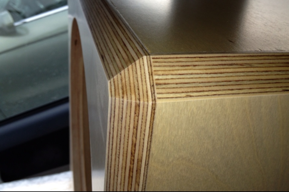

Some people like butt joints better than 45s.  I do both but to get all the panels perfect without a cnc machine I at times struggle. Sides first then drop in the top and bottoms.  I have never been perfect and always had to do some light edge work.  I like grain so if I do but joints I always to a bevel or round over which makes it appear as if they could be either. There is similar about of glue surface on both.  Also most high end companies use a laminate to hide all joints anyways.   Ill post and example of a butt that looks like 45

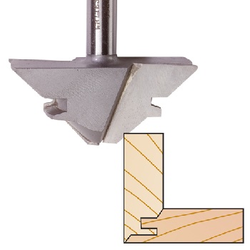

A 45 degree lock miter joint is very appealing, but as jparkhur notes, requires a very precise cutting setup, expensive router bits and is a lot more time consuming.
Steve

I have seen many people in AC use the above method. Butt joints with a recess for the round over solid piece and then veneer the flat sides and front. Stain to match

I tried the locking one and it did not go as planned.  Totem uses it in most of their speakers.  It's great if your great ;)
