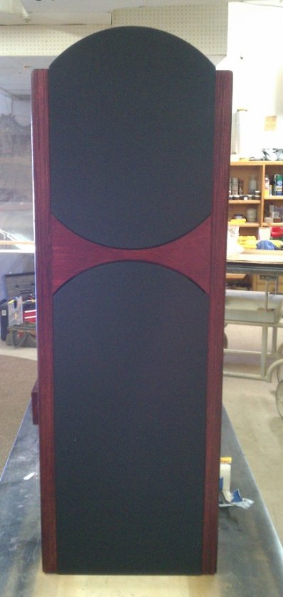

Masterful work by jparkhur

Those look REALLY good. Wish I had the skills to do a good paint finish, I'd like mine to look as good as those someday. I can get the wood working right but I'm afraid I'll screw it all up on the finishing so I've been leaving everything primer-ed. I've got a sprayer and compressor but I don't no jack about what type of paint to use or what to mix it with :icon_frown:

Those sure are nice, Jon, but not for me. I don't care for the look of exposed ply's or stained Birch (those natural-finish Super-V's you just did, however, are SO purty!), and have something else in mind. dark charcoal or maybe black, but not gloss, or semi-, or satin, or even matte. You know that "eggshell" black than Vintage Hot Rod and Truck guys paint their rides? That color and sheen, with Vintage-style grille cloth that Acoustone sells. The cabs will look like you took a 50's console hi-fi and put it in a slammed, chopped, and shaved sled. Wicked cool!
These are actually butt joints with a bevel to make it appear as if they were 45s

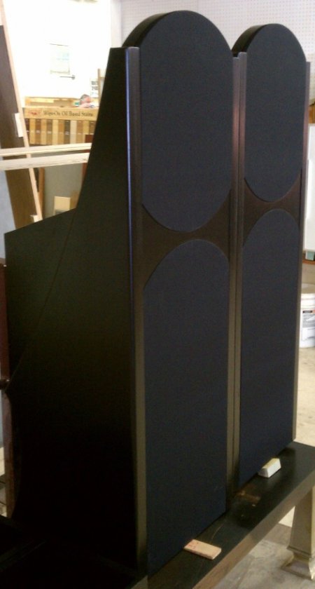

You mean this... everyone likes different... thats whey they are all custom..... one offs...
That finish is so smooth... Nice..

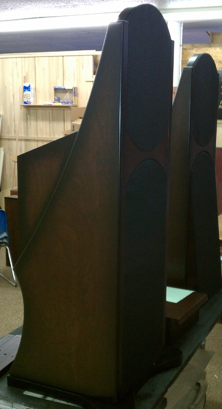

Are the Super-V's in the middle all black? I don't remember seeing them before. The natural finish ones I mentioned weren't stained at all, just sealed with something, so the color was blonde-like. And you used pocket screws in the back corners. Those were the ones I thought were very pretty and classy, in a European/modern style. Reminded me of the furniture I saw in Germany when I was over there in '82. The Europeans put brushed or satin, rather than chrome, hardware on their home doorknobs, kitchen handles, etc.

Yes, they are black.. And yes, i just sealed them with a clear coat...
[/q
One would never know there is a seam on those corners. And you didn't hide it under coats of Bondo either Jon, or the ply's would show. Nice!
The only filler in these is some small pockets that were voided in the grain ends.  The stain is just rubbed on and then cleared.
The seam is completely invisible. And it wasn't done by covering it in Bondo because you can see the plys.
