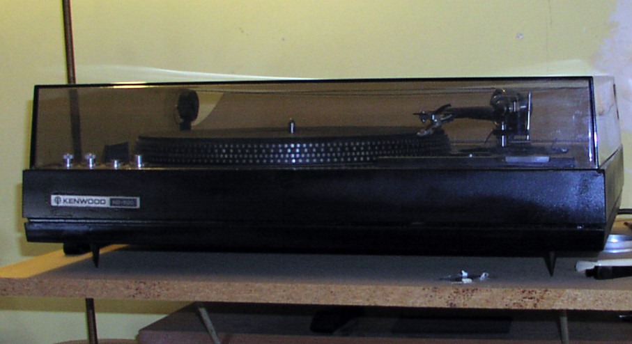

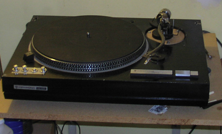

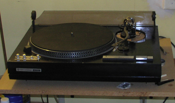

Yikes, that really does look bad. Is that top plate aluminum or plastic?  With all that clay stuffed inside, I wouldn't have thought it would make such a difference.
Is that clay available in black or silver?  You could use artists tools to sculpt it.  You can even paint over most clay, but it can get messed up easily over non-hardening clay. I think maybe Roscoeiii has a good idea there, you could cut out a thin piece of plastic, acrylic or whatever and just stick it on.
I'm one to talk.  My KD-500 was abused as a child.  When I got her a corner was smashed and the dust cover was broken, but she spun like a champ after I cleaned her pots.  I fixed the corners and some of the back with Bondo, auto body filler, but that stuff is pink.  LOL she looked like she was ready to have a food processor mounted on the spindle.  I was never partial to that white speckled kitchen counter look anyway, so I spray painted her black.  She looked pretty good, but some dust landed on the paint when it was wet and I tried to do touch ups with enamel.  I really should do it over, but it's just another to-do project. Get in line.
Actually, it looks better in the photos, you can't see all the imperfections.  That's an Alphason 100S and a Sony XL-MC2.
