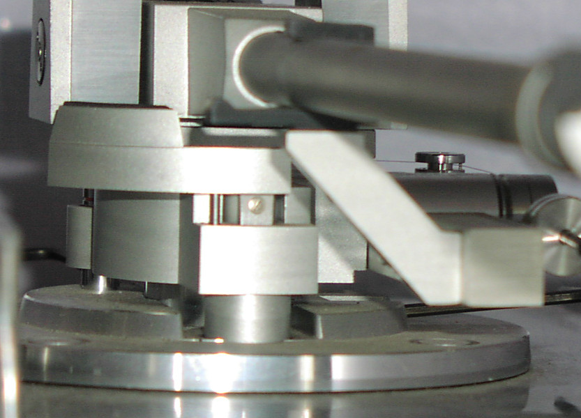

The up/down button works the cueing mechanism, independently of the platter. Is your arm stuck in the up or down position, or actually stuck?  Can you play a record?  There is also a sensor and mechanism that lifts the arm at end of record. This mechanism only raises and lowers the arm with the cueing, there are no cams or mechanical junk attached to the arm.
I'll look in the service manual (did you download it?) for troubleshooting.  In the mean time, maybe you just have to adjust the cueing mechanism.  You need a small allen wrench. From your description, I'm not sure if it's actually broken. The table was advertised as being in perfect working order, but before you take it up with the seller, check it out.  Once the power is on, you can work the cueing whether the platter is spinning or not.  Hope it's just an adjustment.

There are 2 allen fittings to adjust arm height. They are on the baseplate, or just above.  1 faces the outside and the other faces the back.  I'm not sure what size these are, but it's the same as used on most arms of that era, like Linn or Alphason, Zeta etc.  If you're not used to doing this adjustment, you might want to remove the cart/headshell first.  It's easier if you have 2 allens so you can leave them in while you make the adjustment.  You have to hold the housing and physically move it up or down and and hold it when you tighten the fittings.  It's a little tricky, it doesn't move that easily, and you have to keep it straight (level) when you tighten.
Earlier I said the cueing was an allen fitting.  I forgot, it's a small straight screw head located just under the front of the cueing mechanism.  You have to get down on arm level to really see it.
As I said, there are no cams or plastic thingies attached to the arm. The cueing button is hooked up to the same IC as the motor, which in turn is connected to the cueing servo. Maybe the button needs cleaning as Ortho suggests, or maybe it just needs height adjustment.
neo
P.S. I was about to post this when yours appeared. Find that little screw just under the cueing platform and see if you can lower it.  Maybe you can try it in full manual mode.  I don't know if it's the button or the servo, or maybe a disconnected wire, but it's sure not in the advertised condition. sigh  I think the guy said it's been in a closet for the past x number of years.  Now we know why.

It appears that the UP/DOWN button operates the cueing mechanism at the back of the tonearm manually. It's the little crescent shaped bar that holds the tonearm off the record when you manually bring the stylus/cartridge over the record you want to play. It's marked "elevator assembly" in the drawing you supplied. Something motorized/automatic happens at the base of the arm to make it lift up and down.

From what I see in the diagram, the portion marked 'Elevator Assembly" looks like a standard hydraulic tonearm lifter.
If so, can you put pressure directly on it and lower it? This would verify that it is an electric problem and not a mechanical problem with the hydraulic lifter itself.

Guys, that stuff that's marked in red are MY annotations.  :lol:
The tonearm and anti-skate weight was marked just as an addition. The elevator assembly is a GUESS. I was hoping someone would confirm or deny that that crescent shaped deal is in fact the elevator assembly...  :thumb:

You guessed right.  Your arrow is pointing at the platform of the cueing or elevator mechanism.
Notice the screw head in the center of the arm directly under the cue mechanism. Loosen that and see if you can lower the platform.
"How would adjusting the height of the arm affect anything if the UP/ DOWN mechanism doesn't work at all? Am I missing something? Seems to me, the only thing I'd gain by adjusting the height is to make the TT manual instead of semi-auto and usable by allowing the stylus to touch the LP. Is that correct?"
Sometimes when arm height is adjusted, the cue height also has to be corrected.  If the cue height is set way too high it can prevent the stylus from making contact with the record.  A common problem that can be easily overlooked is the cueing platform being too high and hitting the underside of the arm when in play.

Also, looking at your picture, Neobop, looks like the elevator mechanism on yours is lifted off the plinth. Well, mine is all the way down. I gently pulled on the entire assembly by holding on to the base of the elevator assembly, and the whole assembly slides easily upwards and when I release it, slides back down. Neobop - Are you able to do the same thing with your elevator assembly?
Not sure what this means now. So even with the elevator mechanism all the way down, the stylus does not make contact with the LP. Obviously there's some height adjustments to make.
