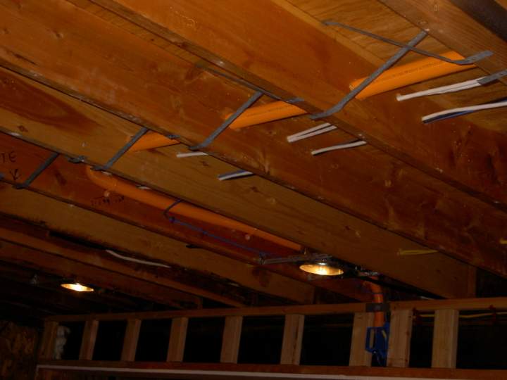

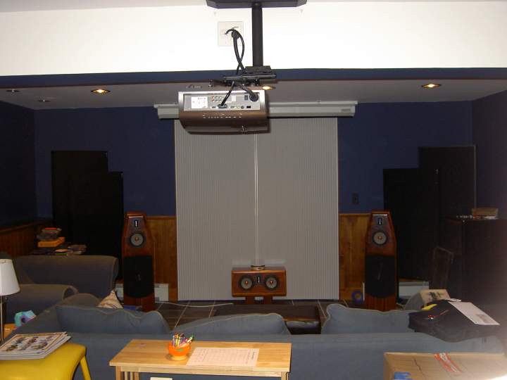

It's called smurf tube because it's typically orange.   See these pictures.  This one shows conduit from a "central" location to a projector location:
This one shows the central location and two smurf tubes, one to the projector (top) and one (side) to another location opposite the screen (in case someone wants to reverse the room:
This one shows the projector in:
