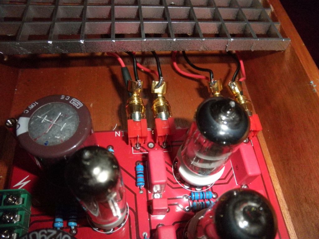

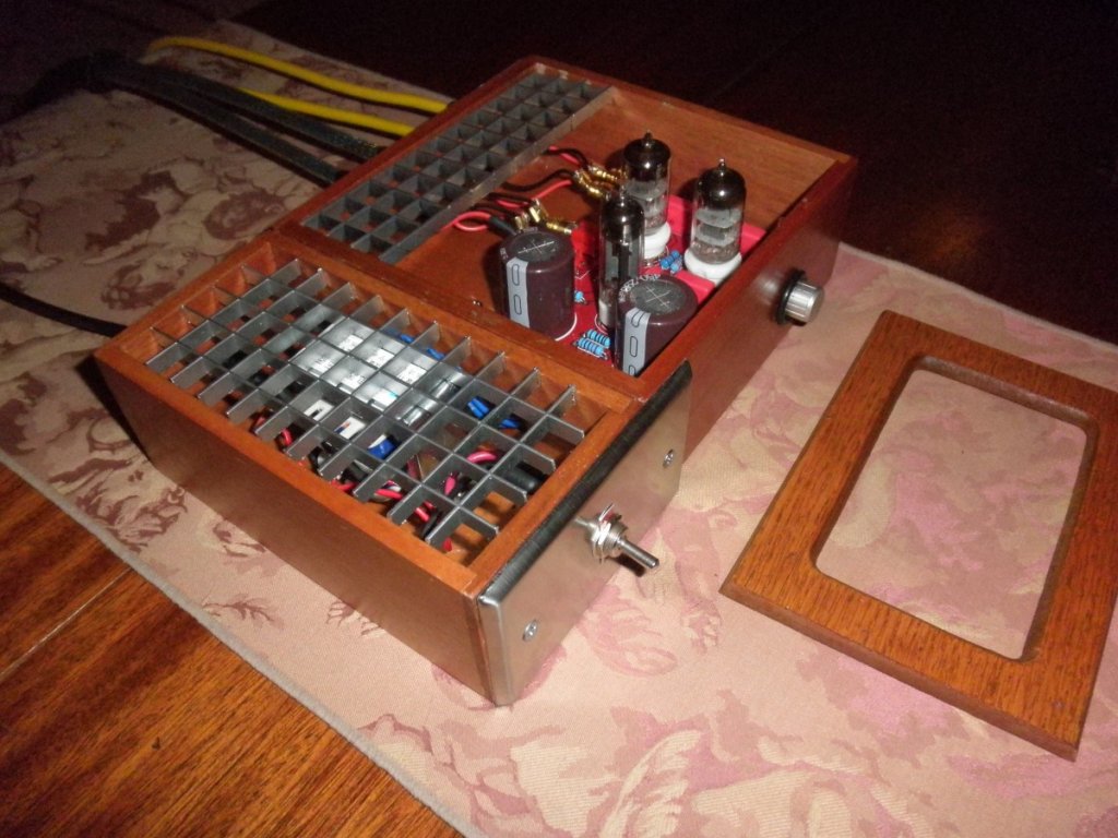

I placed this ebay preamp in two decorator's boxes glued together. Tried it today with a Lepai but bought it to use with a Sure Tripath. I plan to roll the tubes but with the Chinese tubes the sound is down right impressive.

The top with the cut out for the tubes once provided ventilation for my pc hutch.  :lol:

The decorator boxes came in a set of three from Tuesday Morning. The wood is very hard and has Honduras stamped on the bottom. Mahogany? I think I paid $10 for the set and didn't use the largest one. These are much better than the soft wood boxes from craft stores plus they came stained and finished.
The preamp is the 6N3 model with the added rectifier tube. I have some WE396A's which are said to be very good replacements for the 6N3.
I added the toggle switch/plate cover and a fuse and holder from Radio Shack. The plate jacks on the back are in wall plates from PE that I bought a few years ago on close out for $1.00 and I just added two additional jacks.
I'm not skilled enough to solder directly into the board for the inputs and outputs. So I soldered some left over RCA ends from an IC project with lead wires to the rear pin and lugs and plugged them into on board RCAs. I did this as the on board RCAs look fragile and probably wouldn't stand up to my constant swapping of gear.
