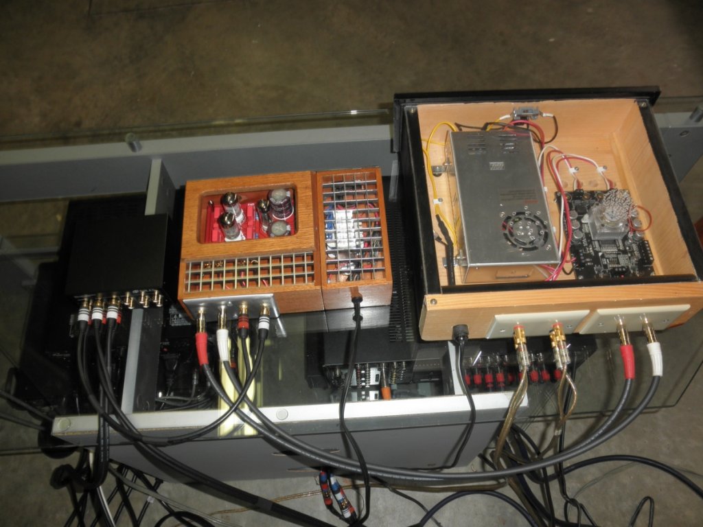

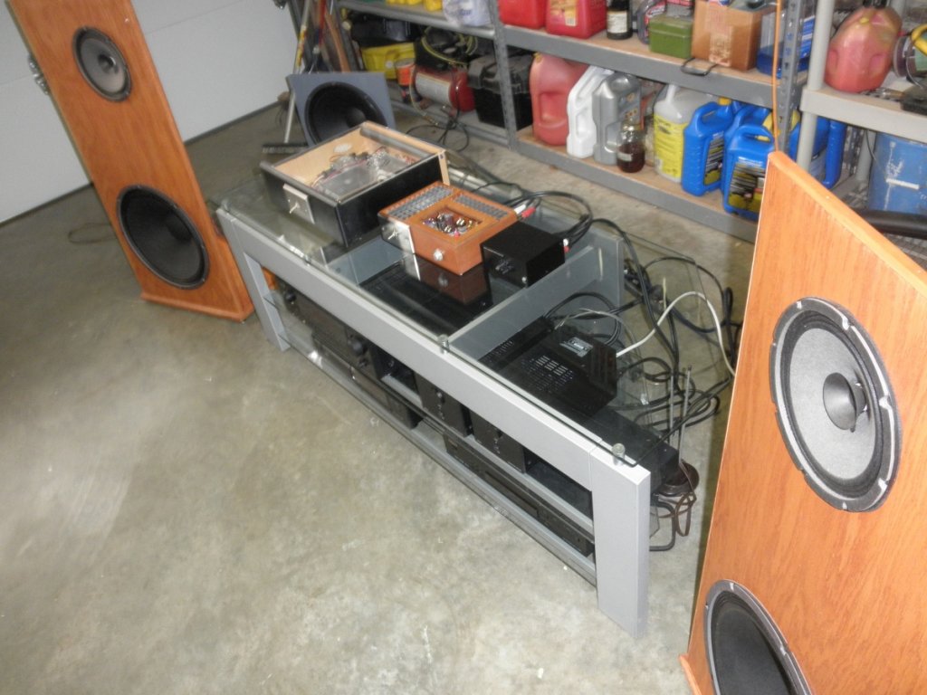

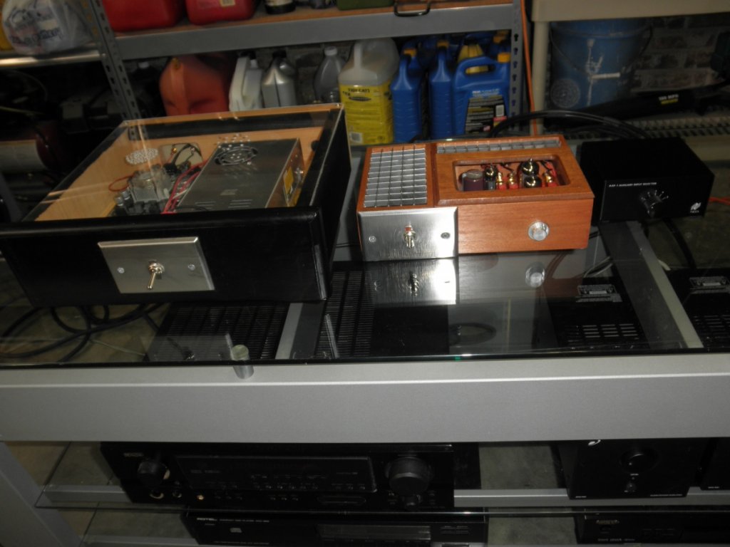

Here is the $50 preamp paired with the C&C Sure TK2050/Meanwell PS ( under $100 )
Poultrygeist
Re: $50 Three Tube Preamp
« Reply #29 on: 29 Jan 2013, 02:53 pm »
The Niles input switcher is on the far left.

This is what I'm using with the $50 preamp - more cheap and cheerful stuff I keep cobbling together.
