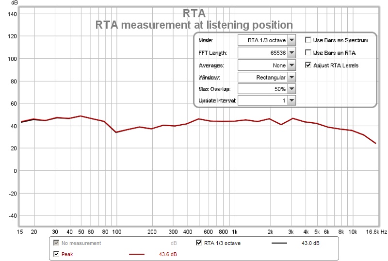

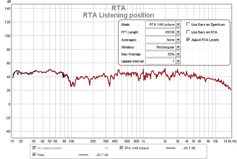

Here are couple of measurements I took this afternoon. I am still feeling my way around with REW software
1/3 oct. measurements obscure a lot of information.
1/48 oct. measurements are very interesting.
The high frequency measurement limit of 16.6kHz is also a little puzzling. The the CrossSpectrum sourced UMM-6 mic is calibrated to 25kHz and with 16/44 sampling I would have thought I could have had measurements out to 20kHz with no problem.
The bass response reflects the contributions of two subs operating out of phase in two different locations in the room. I am going to try to relocate one of them to try to fill in the suckout centered on about 100Hz. and see what happens.
Scotty

« Reply #92 on: 12 Feb 2013, 01:30 am »
Hi Scotty, looking pretty good  :thumb: Setting the graph scales (perpendicular arrow button, next to the "gear" button) may be all you need to get up to 22/24k.
You may want to try a measurement sweep instead of RTA.

« Reply #95 on: 12 Feb 2013, 03:13 am »
Scotty,
I agree with doing a full measurement to get a general idea. Play the speakers at least at 75 dB or above to swamp out room noise.  Also change your vertical scaling from 20 dB to 5 dB  :thumb: Notice that Ethan Winers graph posted above has 3dB vertical scaling.
After that, limit the sweep to just 300-400 Hz to concentrate on the bass alone. 1st with no smoothing at all. Then add smoothing a little at a time and see how it changes, i.e how resolution is lost. Do all your tweaking with the unsmoothed graph, in particular with frequencies below 300-400 Hz.
Do all this before moving subs around.

Re: Speakers - to measure or not to measure?
« Reply #96 on: 12 Feb 2013, 01:51 pm »
Agree with Anand, your vertical scale is too large, try reducing the upper/lower limits to around an 50-70db window (from the current 100+) to better see what is happening. Won't look as pretty but will be much more informative.
Are you measuring from LP/seat? Is your room "treated"? What speakers are being measured?
The midbass dip is possibly a measurement artifact, but the HF attenuation seems a bit much.

« Reply #97 on: 13 Feb 2013, 07:04 pm »
Exactly. This article shows some guidelines for displaying the various graph types:
Room Measuring Primer
Also, 1/3 or 1/6 octave smoothing is appropriate and useful above 400 or 500 Hz or so, but for the bass range it's best to disable smoothing altogether.

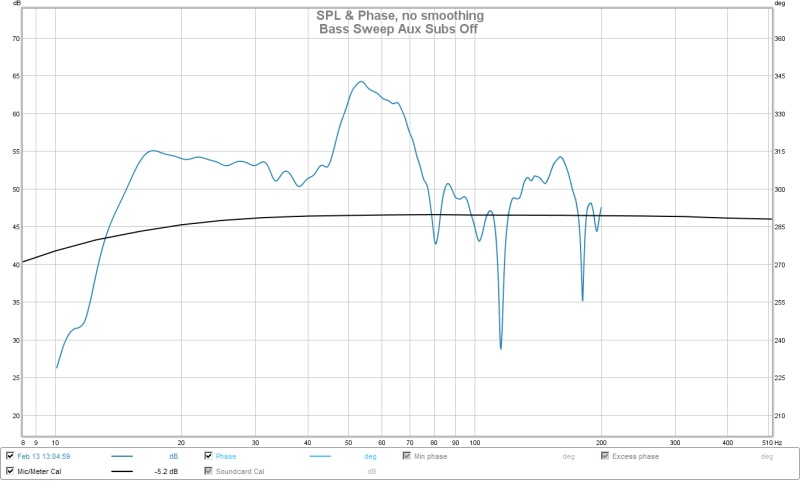

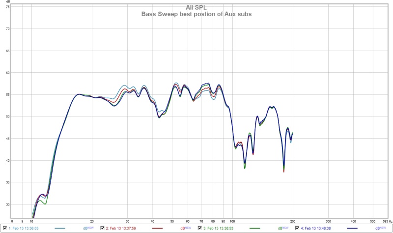

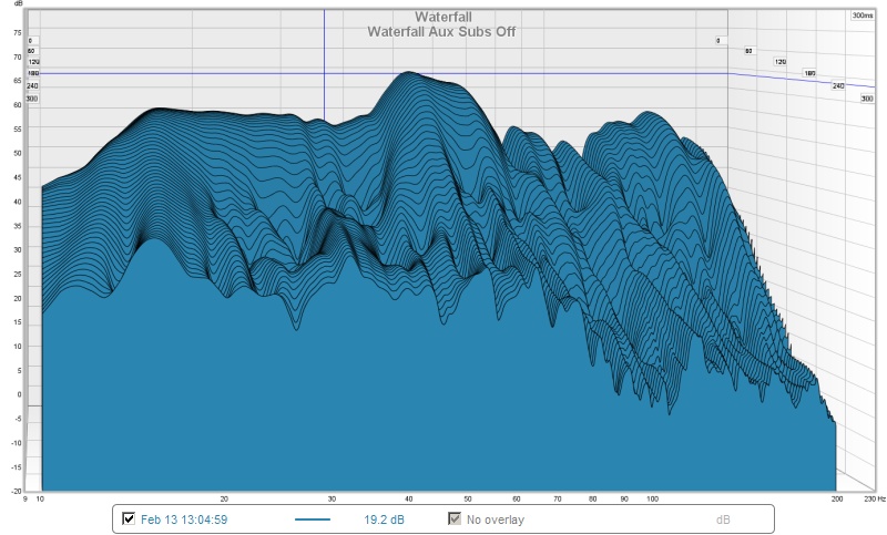

*Scotty*
« Reply #98 on: 14 Feb 2013, 06:26 am »
I have managed to take a few more measurements.
I am going to play with relocating one of the subs to try and fill in the hole around 125Hz. and see what happens.
Scotty
