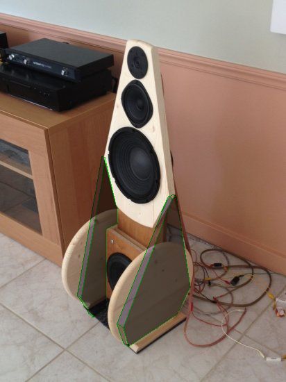

Lots of testing going on. The isolation mount seems to work well. Lots of component value swapping and critical listening. Test baffle dimensions in 3/4" MDF images well. This is now the 3rd baffle design and each have affected the off axis response primarily. The 3rd iteration appears to work best to date. I now have a new favorite tweeter, namely the VIFA XT19.
matevana
Re: New Build: Hestia-SL
« Reply #27 on: 22 Dec 2012, 05:45 pm »
A closer pic showing baffle shape iteration #3, 12/21/12:
matevana
Baffle #4
« Reply #28 on: 27 Dec 2012, 09:37 pm »
And after another 20 hours of listening, it's on to baffle iteration #4. Since the Hestia-SL design doesn't use any active compensation for the top three drivers, the nude-like baffle around the mid just wasn't cutting it. A bit too much cancellation. A complete baffle redesign was necessary in order to provide more baffle "real estate" around the mid driver, while maintaining the desired imaging characteristics.  In a mock-up made of Masonite, this baffle shape made a big difference. The actual baffle will be cut from 1" spruce. Since there isn't a lot of excess meat on the baffle, the driver's frames mounted with 1" screws will help keep the baffle rigid. I also noticed that softer/thicker woods actually do a nice job in absorbing certain resonances, despite what one might think.
A few more crossover component changes and it'll be about 90% there.
The original Hestia design to the left is being built for my neighbor. He actually spent a lot of time bringing CD's by to hear them. Every time he thought he could stump the design he just laughed, shook his head and went back to his $1500 pair of boxed speakers. He soon will have his own pair, at about one tenth the cost.  :thumb:

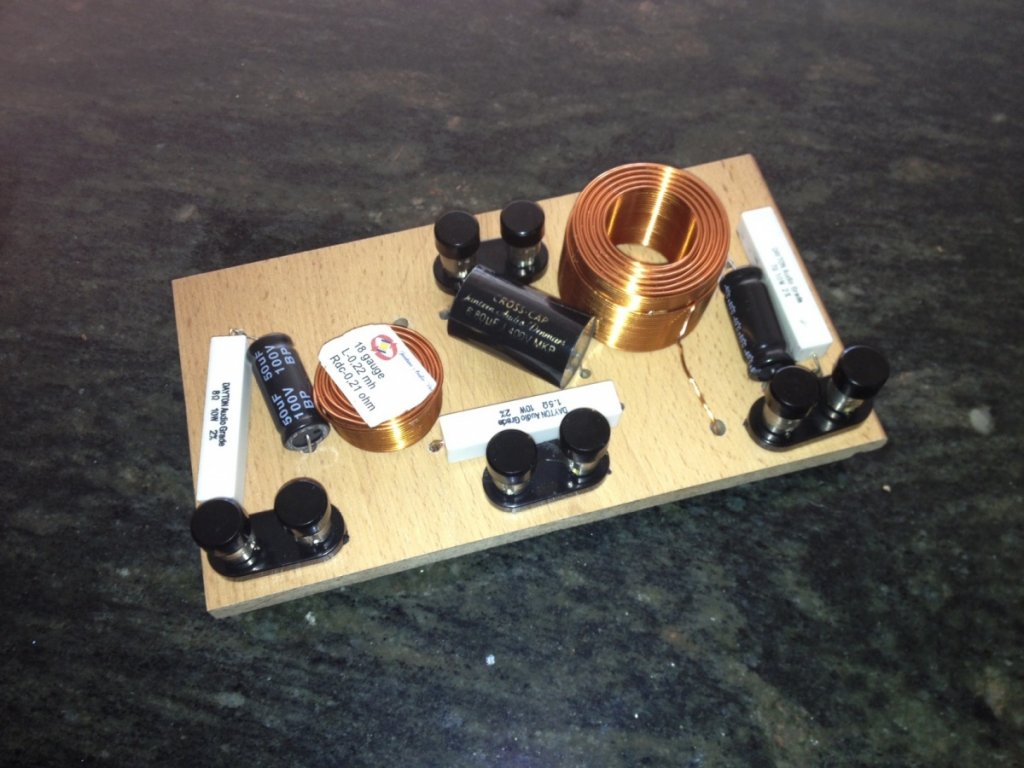

The spaghetti sitting behind the speaker consists of 28 test leads attached to caps, coils and resistors. Very easy to swap out components this way and hear subtle changes quickly. The finished crossover boards are currently being worked on as well.

The final baffle has a pleasing shape to my eye.
That would be 5/4" spruce in dimensional terms? It looks to be 13" or more at the widest? Where did you find that? What kind of spruce and please don't tell me Sitka. Is the top baffle fairly vibration free?
I'll let you finish before I ask the question and I don't mean how much did it all cost.
You must be pleased. Looks like another well integrated design.
Peter

Sitka??? Never! :lol:  They are actually stain grade table tops sold at Lowes and come with nice roundovers on the edges. The baffles use the 24" round while the side panels are 15" round. They are 5/4" thickness and measure very close to 1" with a ruler.  You are exactly right; 13" at the widest point, 7.5" at the bottom and 4" at the top. A total of 4 cuts with a circular saw and guide.
I use Google Sketch-up to lay out the baffle and drivers, then print a pattern in 1:1 size to be used as a template. Works very well with irregular shapes. Note that the top and bottom of the baffle maintain their original round profile, which adds a nice touch. The mid driver's  cutout is chamfered in the back.
Vibrations are minimized by two factors. First, I'm using sorbothane material to "sandwich" the baffle to the mount and the fasteners (screws) sit in over sized holes so they don't directly contact the mount. Second is the fact that the drivers are spaced closely together and all the extraneous baffle material has been eliminated. Less material (of the same design) can translate to fewer resonance concerns.
I think you were also asking about the project cost. Well... not too shabby for the big sister of the Hestia. In keeping with the design mantra, I was able to build the SL's at a cost of under $200 per side for the all active version, including building materials. The passive version (the design I am working on now) will add another $50 or so for component costs, but will allow you to drive the top three drivers with something as small and inexpensive as a T-amp.
They measure out at around 90.5 dB efficiency with a system impedance of 7.8 ohms. They sound great with an SET amp as well. I am using two Yung plate amps on the SL version so the H-frames can be driven in stereo. This is not absolutely necessary but is recommended since a higher degree of imaging is sought. One could easily start with a single amp in mono and later upgrade as desired.

Here's a picture of the working crossover. I'm going to live with this for a bit before posting final component vales.

I wonder how you would think about taking the new baffle theme one step further - by replacing the circular side baffles with the new edgy shape:
The side wings would start at the widest point of the speaker baffle and narrow towards the bottom. This would give the whole thing an even lighter appearence.
Rudolf
