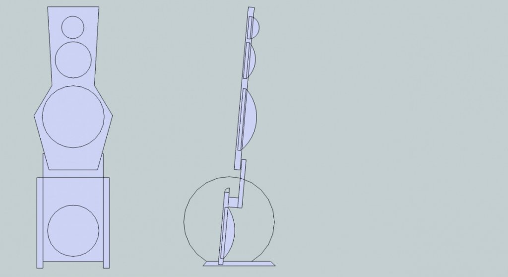

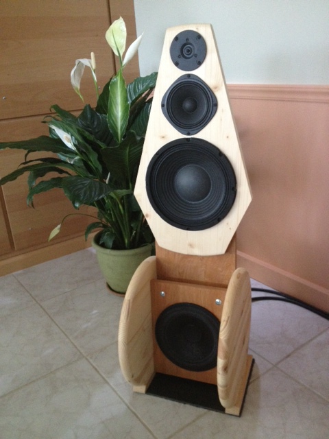

Inspired by the feel of the new Linkwitz LX-521 design, I began to work on a progression of the original Hestia project. Dubbed the Hestia-SL, in recognition of Siegfried Linkwitz's LX-521 main baffle shape.
Initial Project design goals:
Continued use of the MCM Audio Select 10" lower midrange driver
Continued use of the Vifa D-19, or optional drop-in replacement of the XT-19 tweeter.
Introduction of a 5" coupling driver for enhanced mids
Incorporation of a H-Fame carrier for the LF driver with anti-vibration mount (or optional bridge)
All active or active/passive hybrid with a choice of 2, 3, or 4 way operation.
Floorstanding height with 5 degree incline: (42" H x 11.5" W x 15" D at widest point)
Alignment of all driver's acoustic centers
SL inspired main baffle shape for enhanced off-axis performance
Pleasing form-meets-function artistic design
Best bang-for-the-buck approach
At the present, the proposed driver selection includes:
Dayton Pro Sound 10" mid woofer
Vifa XT-19 dual ring radiator 3/4" driver (D-19 option)
Celestion 5" Neo Midrange (PE Buyout driver)
Usher 8955 8" bass driver in H-Frame

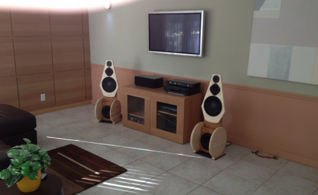

UPDATE: Here's a pic as of 12/21/12 with the 3rd baffle shape iteration.
UPDATE: Fourth and final baffle revision 1/5/13:
Regards,
Ed

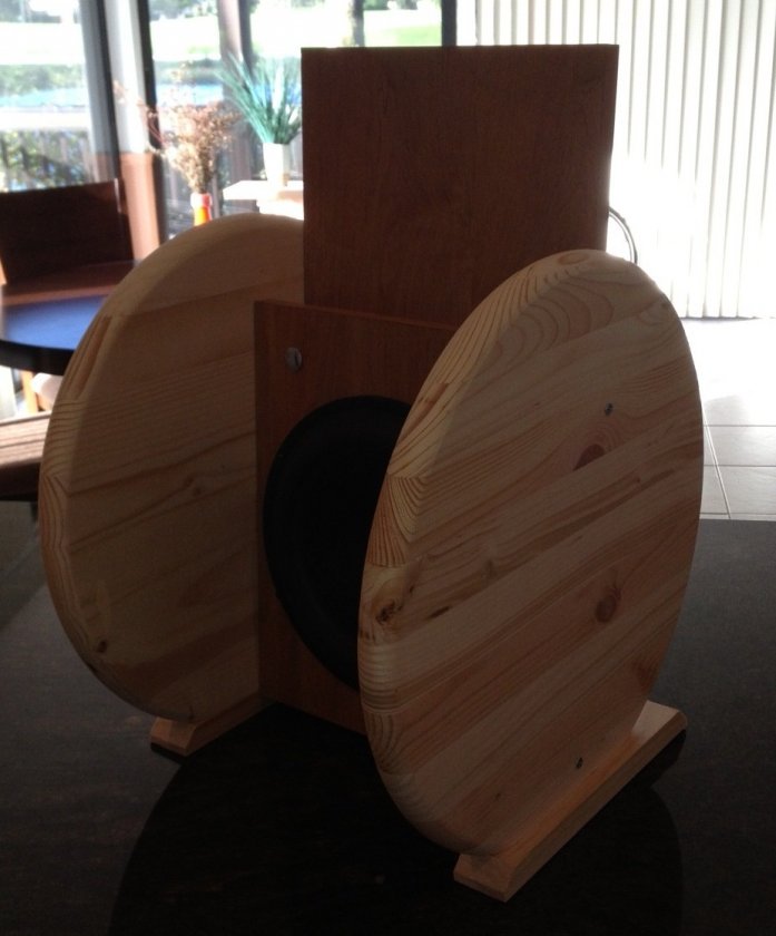

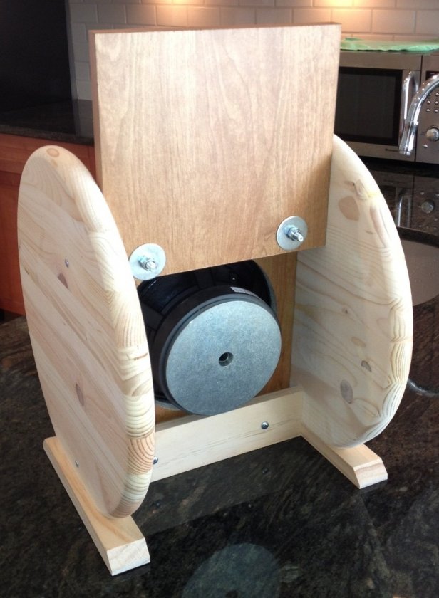

Completed H Carriers
« Reply #11 on: 2 Dec 2012, 02:58 pm »
Here's a few shots of the H-Frame Carriers I am testing. They are universal in design and will allow a variety of top baffles that attach with a unique shock mount. They are very compact measuring only 11.5" wide by about 15" deep at the widest point. They are built with a baffle incline of 5 degrees, and will hold the main baffle approximately 30 mm behind the woofer baffle to better align the driver's acoustic center and provide some time alignment as well.
I am happy to say there is no baffle noise at near concert levels. The Ushers produce copious amounts of bass for their size and are extremely quiet, quieter than any OB bass driver I have used.  This is true for both the 8955 shown in the picture as well as the 8137a kevlar bass driver. They are also very fast and articulate (return to zero). I have spent the entire day listening to the stereo pair of H-Frames, at varying crossover frequencies. They can be crossed much higher than typical, but the actual crossover point has yet to be determined.
Materials used are full 1 inch thick poplar and 3/4" MDF. Panels are bolted with flex seal.

matevana
Re: New Build: Hestia-SL
« Reply #16 on: 3 Dec 2012, 06:32 pm »

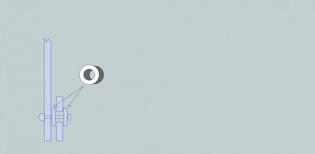

Here's a very rough sketch of the shock mount concept.
Basically the main baffle is sandwiched to the H-frame carrier at three fulcrum points. The mechanical fasteners are only rigid where they come into contact with the main baffle. The pass through holes in the carrier are at least twice the diameter of the fasteners, so as not to come in direct contact with the hardware. The main baffle is suspended between two foam rubber donuts, about 1/4" thick. Vibrations traveling to the main baffle should be diminished.
Here's a view from the side. The order from front to back would be lag bolt, main baffle, rubber donut, H-frame carrier, rubber donut, fender washer, lock nut. The baffle will be torqued just to the point where the rubber compresses and enough force is exerted to sandwich the baffle in place, but where the rubber rings still maintain their resiliency.  Nylon inserts in the lock nut will prevent the nut from backing out over time. The rubber donuts or large o-rings will be made from foam rubber pipe insulation (tubes), sliced down to an appropriate thickness (approx 1/4" to 1/2").
matevana

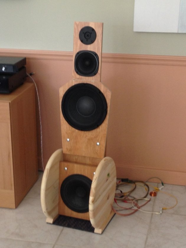

« Reply #18 on: 4 Dec 2012, 02:38 pm »
Great catch!  I currently use sorbathane pads as dampening feet, but have not seen isolators made from the same material. I may just order a set while I'm testing baffle designs.
On another note, I am beginning to appreciate the intricacies of incorporating a midrange driver into a design. It's not as easy as it seems and truly a balancing act. At this point I'm not too happy with the results, especially when I step back and compare it to a properly implemented 2.5 way design. And I'm prototyping with a 4th order active analog system where adjustments can be made in real time.
On the plus side, both tweeters (D19 and XT19) sound really nice when crossed low with a 4th order slope.

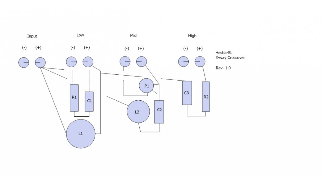

Hestia-SL Crossover Sketch
« Reply #19 on: 16 Dec 2012, 02:54 pm »
After 3 weeks of crossover development, the following is being presented as version 1.0.  Most critical to the design is the mid level attenuation. Not being able to decide between more detailed/slightly forward and slightly less analytic, I decided to use a variable resistor (P1) to allow the listener to dial-in his/her preference, which may also depend on the source material.
The current driver/component combinations for version 1.0 are as follows:
Low/Mid:
Dayton 10" Pro Sound Driver 8 ohms
L1 = 1.80 mh
C1 = 30 uf
R1 = 8 ohms
Mid Coupler:
Celestion 5" Neo 8 ohms
L2 = .33 mh (18 ga)
C2 =  50 uf
P1 =  8 ohm potentiometer, 15 watts
High Frequency:
Vifa XT19TD00-04 4 ohms
C3 = 6.8 uf
R2 = 0.51 ohms
Note that the approximate crossover points are 700 Hz for the Low/Mid driver and 5800 Hz for the tweeter. The mid coupler crosses at approximately 400 Hz and 5700 Hz. The overlap/deficit is intentional and is used to help EQ the design. The drivers were chosen in part due to their low slope tolerance over the selected range.
The schematic is labeled version 1.0 for an important reason. The drivers are being tested on a rectangular temporary baffle and are not at their finished height. The actual completed baffle will also contour to help enhance off axis response. It is therefore anticipated that further adjustments to the component values will be necessary.
Also note that the Usher low bass driver is powered and crossed separately with a Yung plate amp, similar to the original Hestia design. The approximate x/o is 100 Hz.
