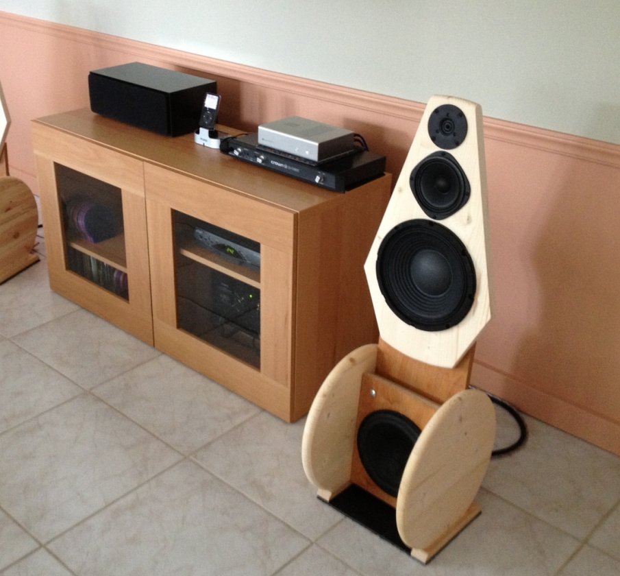

« Reply #43 on: 6 Jan 2013, 09:17 pm »
Completed a 2nd SL with the revised baffle shape.  Things are settling in so crossover changes are now few and far between. I can say the design images well. The sound stage is taller than the original Hestia and it's easier to pin point an instruments width and depth on stage. Unlike the original Hestia which are a bit laid back, the SL's are very revealing which can be both good and bad. Good CD's sound great as do HD music files. That being said, lesser quality recordings are not "masked" as they are with the original design. In short, they are a highly resolving version of the originals.
The circular side panels work very well within the context of the design. I knew I wanted an H-Frame but didn't want speakers that looked too heavy in the Living Room. They definitely appear less assuming than a cube of similar dimensions. I also feel like they don't photograph well.  Those who have seen them in person comment that they are much more attractive then they are in pictures.  I suppose this is true for some people as well.  :lol:

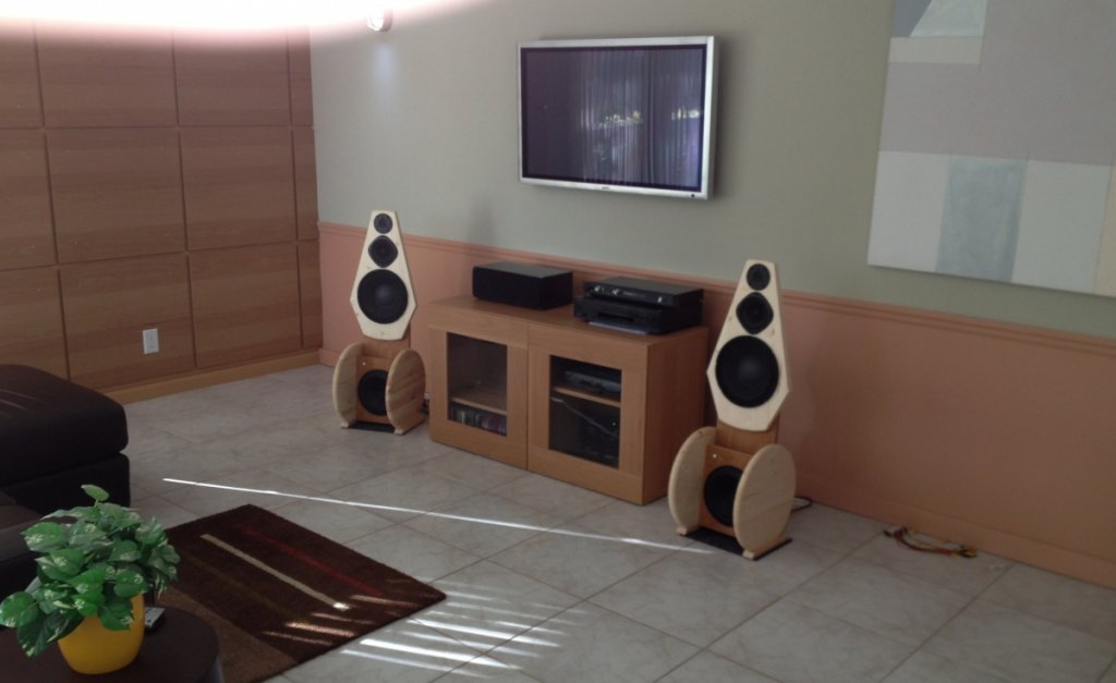

Just curious about distance to the wall. Have you tried them further away?
matevana
Re: New Build: Hestia-SL
« Reply #45 on: 7 Jan 2013, 01:25 am »
Looking great  :thumb:
At this point, all of my listening has been done with the back of the drivers 36" from the rear wall.  The left speaker is also 50" from the side wall. Surprisingly there are few adverse reflections as most of the surfaces are hard. The room would be categorized as lively. The SL's each sit on a 12" x 10" carpet tile with jute backing. There is a 4' x 6' wool area rug about 6 feet in front of the SL's, centered between the two.
Bass response is plentiful, tight and articulate. Lower mids are exceptionally good. The Ushers sit 1" above floor level. All drivers are time aligned based on the location of their acoustic centers.  Listening to fast acoustic bass runs, every inflection seems to be audible and does not lag. So far, so good.

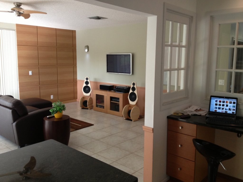

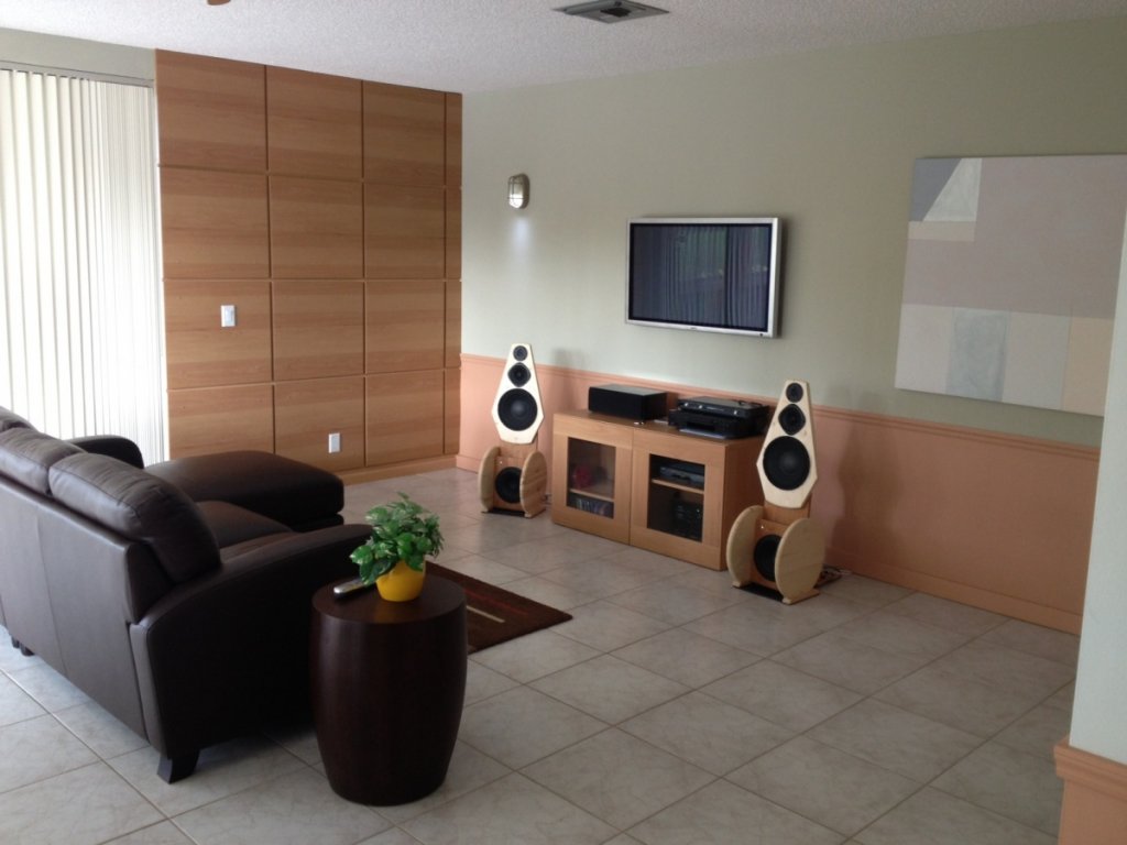

Listening Room
« Reply #48 on: 13 Jan 2013, 03:26 pm »
Here's a better perspective of the SL's in their listening room showing approximate distance to room boundaries.
Wider view showing digital sever in adjoining room. I plan to get rid of my CD player entirely once all libraries have been converted to lossless files. In addition to my laptop setup which supports hi res music files, I also use an iPod classic with a pure digital tap that plays 16/44.1 files through a Schiit Bifrost DAC. Weighs a few ounces and holds 160GB of actual CD quality sound (About 4000 songs). The key to getting great sound from an iPod is tapping it's digital signal and bypassing the internal DAC with a good quality outboard DAC. In blind tests, I can not tell the difference between that and my CD player. The convenience and playlist capabilities far outweigh any CD player.
The chain looks something like this: (Toslink cable between Digital Dock and DAC)
iPod Classic -> Pure i-20 Digital Dock -> Schiit Bifrost DAC -> Crown D-75a Power Amp  -> Hestia SL's
